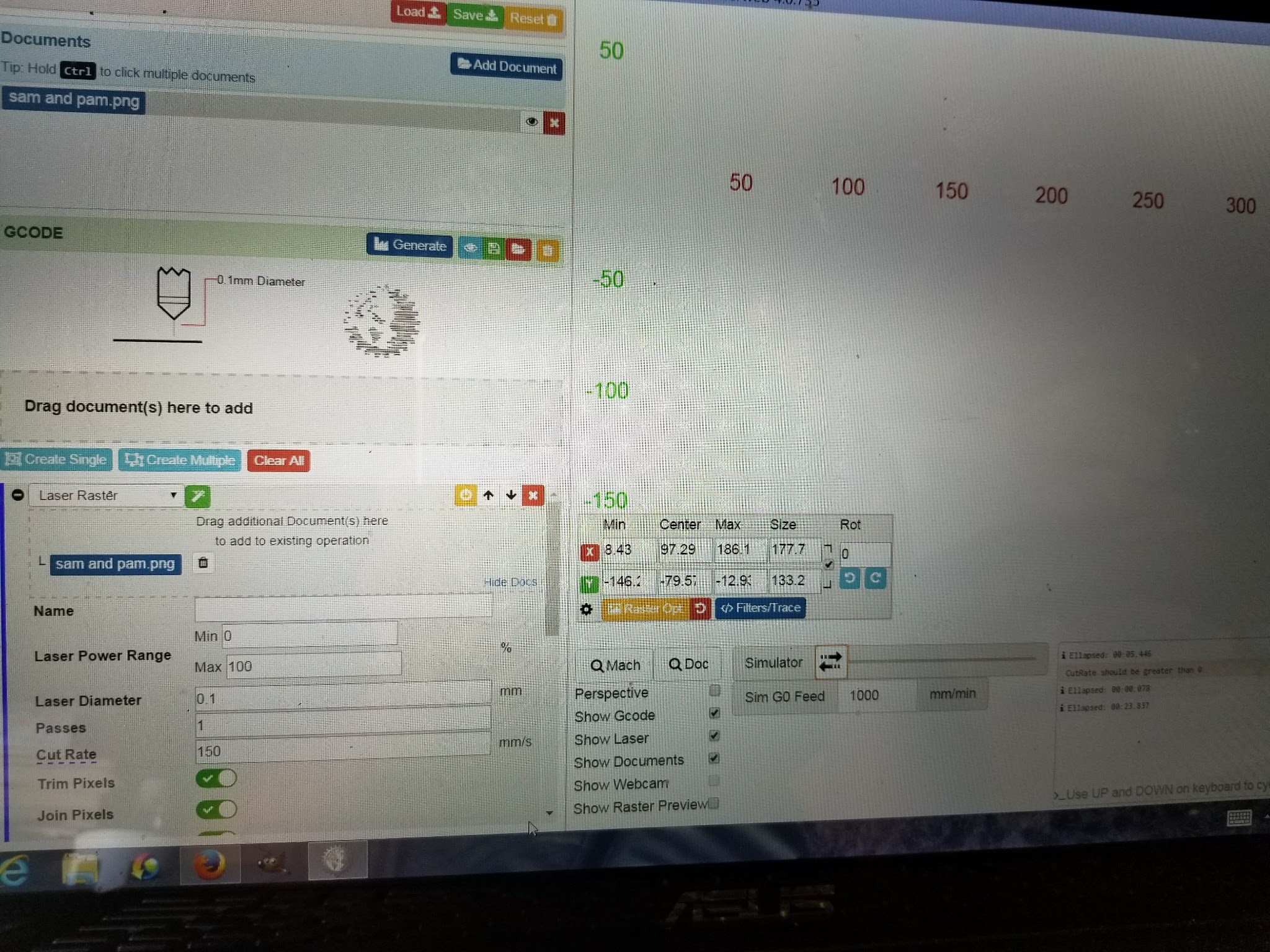

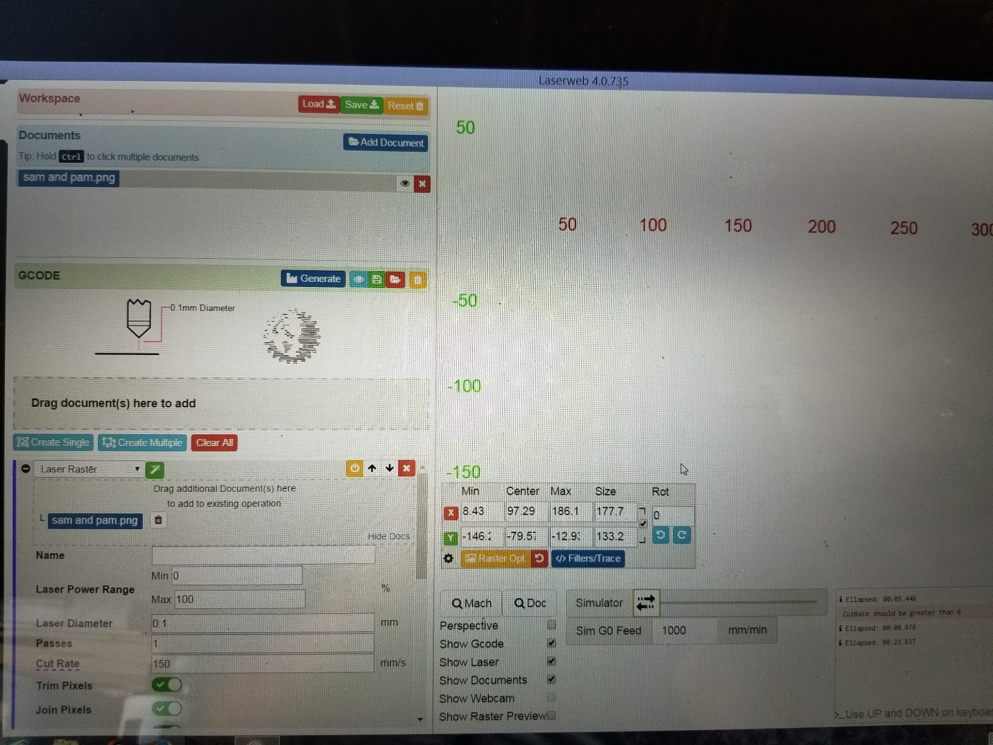

I will try it again at the .1 Also what would cause LW work area to go a solid white after I generate GCODE. I can not do anything to get my grids and picture back.
Im not sure what you mean. Please post a picture if you can
Sorry about screen dang phones
That does not suppose to happen. Maybe it’s a side effect of that large image code. First are you running the latest version? If you haven’t yet, try adjusting the laser diameter and try again. We would need to dig deeper if this continues. After generating the new file also let http://me.know the size if it works
I made my image smaller that before for a test. Image was 100mm x 75mm and it still did it. I will go and make sure I have the lastest version. I am running
Frontend: 4.0.735
Backend: 4.0.96
