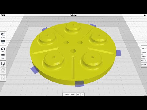

Barring that, does anyone know of a decent OSS CAM that will do double-sided 2.5d? (as in, flip it over for full 3D) I think Kiri:Moto does, but it doesn’t look like jscut.org does. Makercam.com uses flash, so that is a non-starter for me. If I can’t find a good OSS CAM, I may just use ESTLCAM (not OSS, but cheap and does 2-sided jobs). Although, come to think of it, I’m not sure it does Linux.

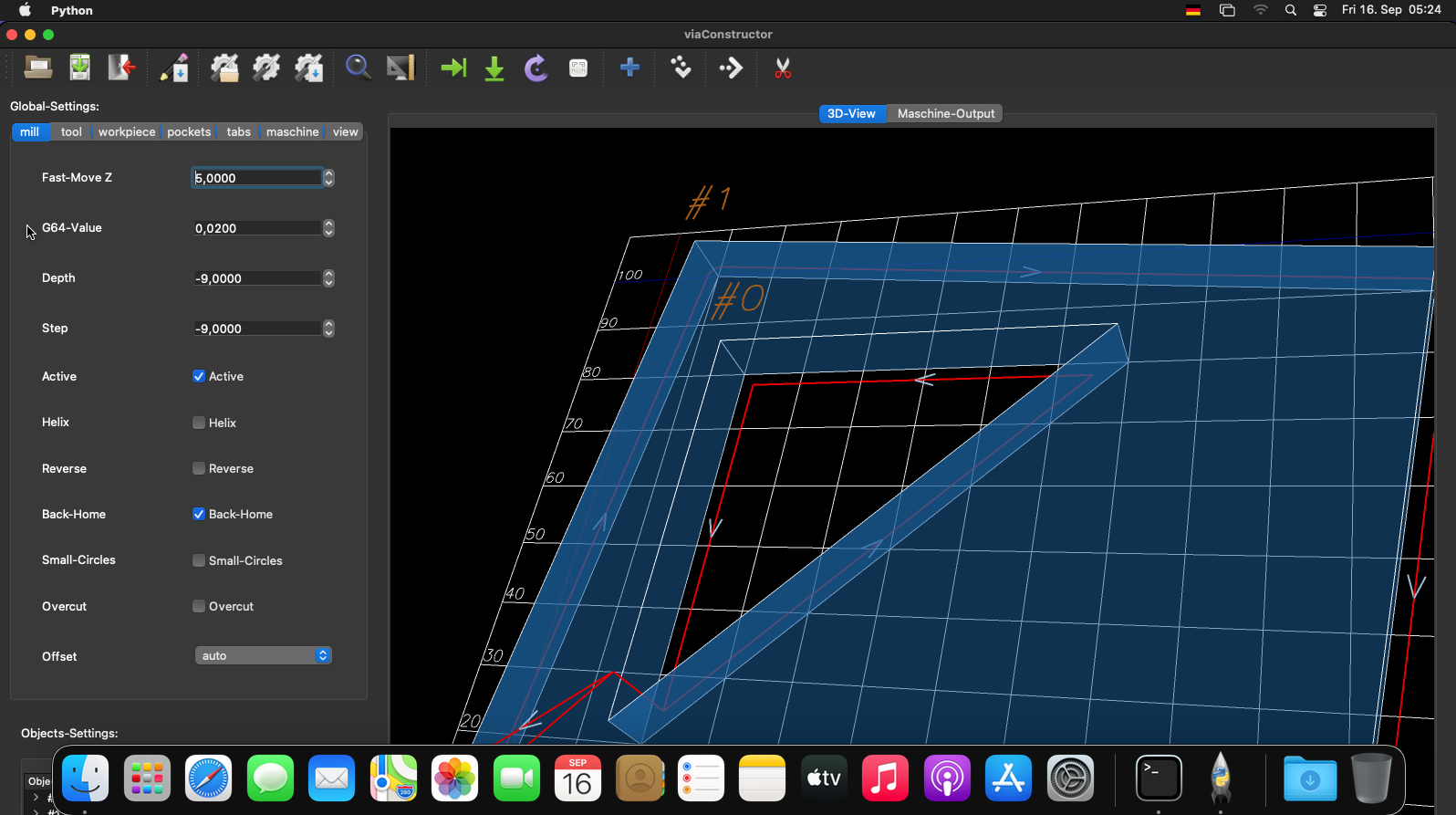

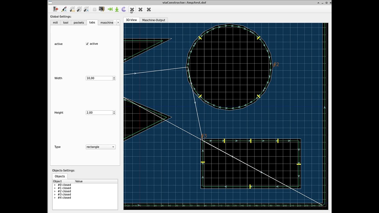

Hi,
i’m working on a new 2.5D-CAM tool for linux:
Please take a look.

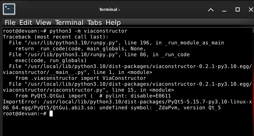

I’d like to try it but cannot get it to work?
That’s a library incompatibility that has hit other packages too. Searching for _ZdaPvm and _ZdlPvm will show you related problems in other projects. :frowning:
You might need to install system versions of pyqt5 and run from code instead of doing the pip install of the package? I don’t know devuan package names though. I’d suggest reading through requirements.in and installing them, and then running from a git checkout.
You can try to run it in a virtual environment:
cd /usr/src
git clone git@github.com:multigcs/viaconstructor.git
cd viaconstructor
make run
this will install all depends with the right versions in ./pyvenv
You can also install the right versions on your system using:
pip3 install -r requirements.txt
but this can make problems with other installed python apps that need’s other versions of this libs

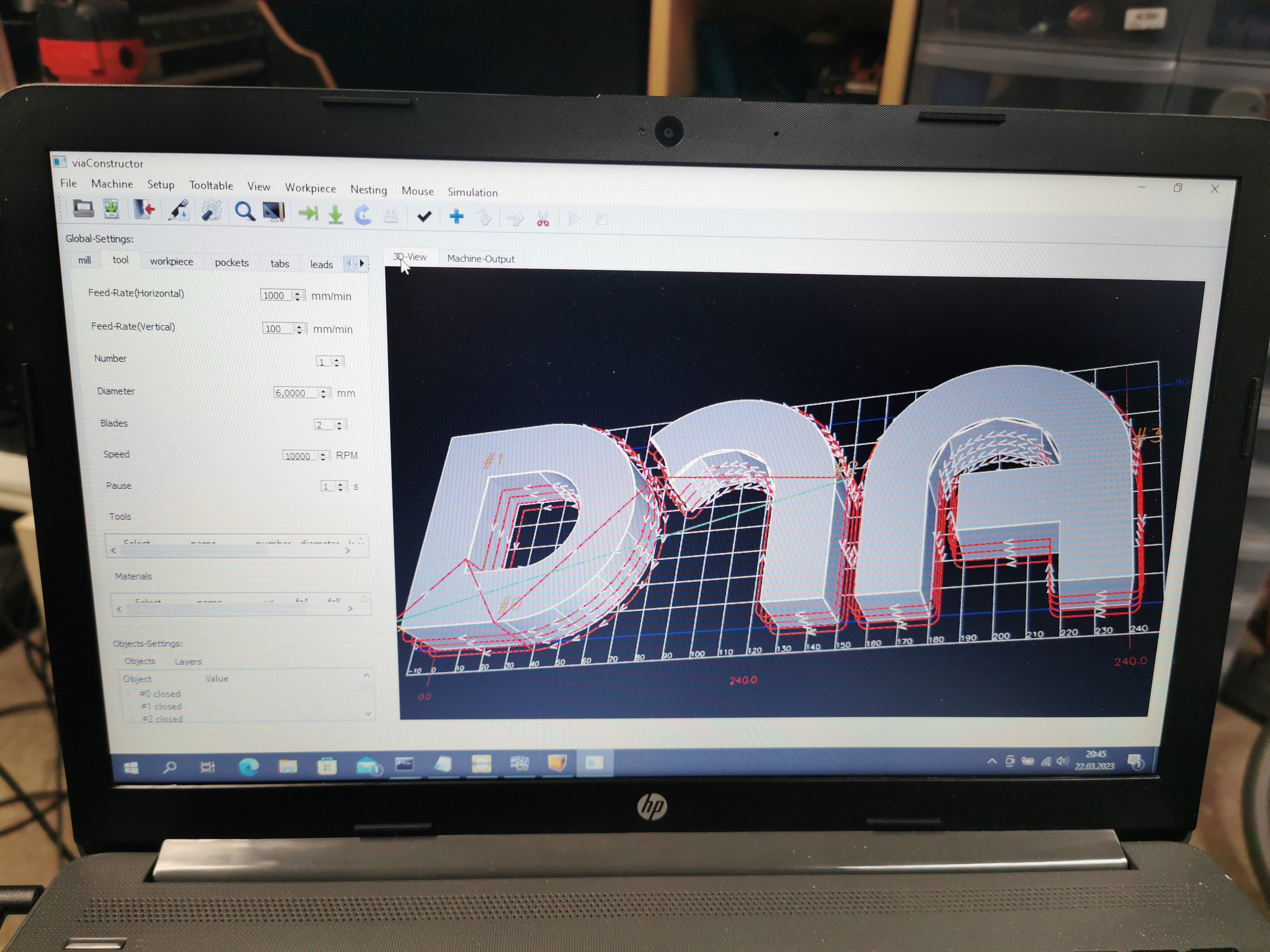

little demo video
now, viaconstructor runs also on mac/osx:
viaconstructor runs now also on windows
