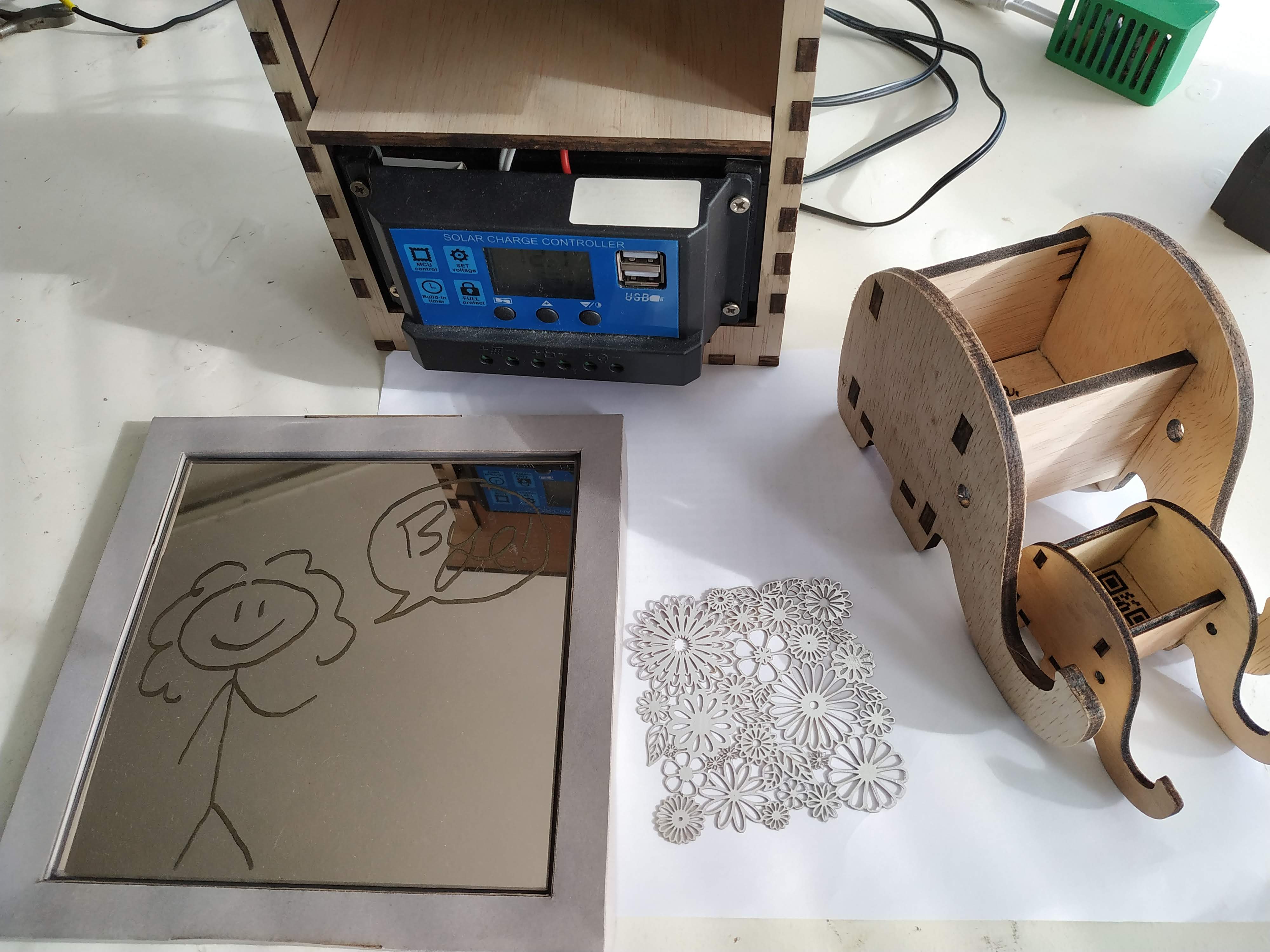

I have a similar unit (claims 40W with a 0.08mm spot) and it does many wonderful things, it engraves wood, etches mirror backings, cuts paper, cuts plastic foils and engraves multi layer plastic signs. It also cuts thin wood and ply, and I have made nice things with it.

It will need some practice and time to learn how to use it properly, but I only got my machine last summer and here is a selection of wood+paper things that it has cut, and there is more I’m not showing.
(‘40W’ diode laser with my home-made air assist)

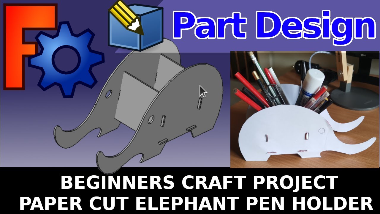

That looks like the MangoJelly elephant?
Lol, that took a bit of googling… turns out elephants like mango.
It’s very similar but not the same, came as a drive-by download from 3axis.co (warning, ad-bombs) when I was gathering some DXF’s to test LW with.
It has horrible import scaling problems, but is such a nice model that I’ve actually made half a dozen now, at various sizes scaled by wood thickness, makes a good simple gift.
Didn’t mean to send you off googling! For anyone else I confused, “MangoJelly” has been creating youtube tutorials on FreeCAD, and relatively recently did one in which he showed how to create a design like this. I had no idea that elephant pen holders were a thing more generally. I guess I don’t get out enough! :stuck_out_tongue:
