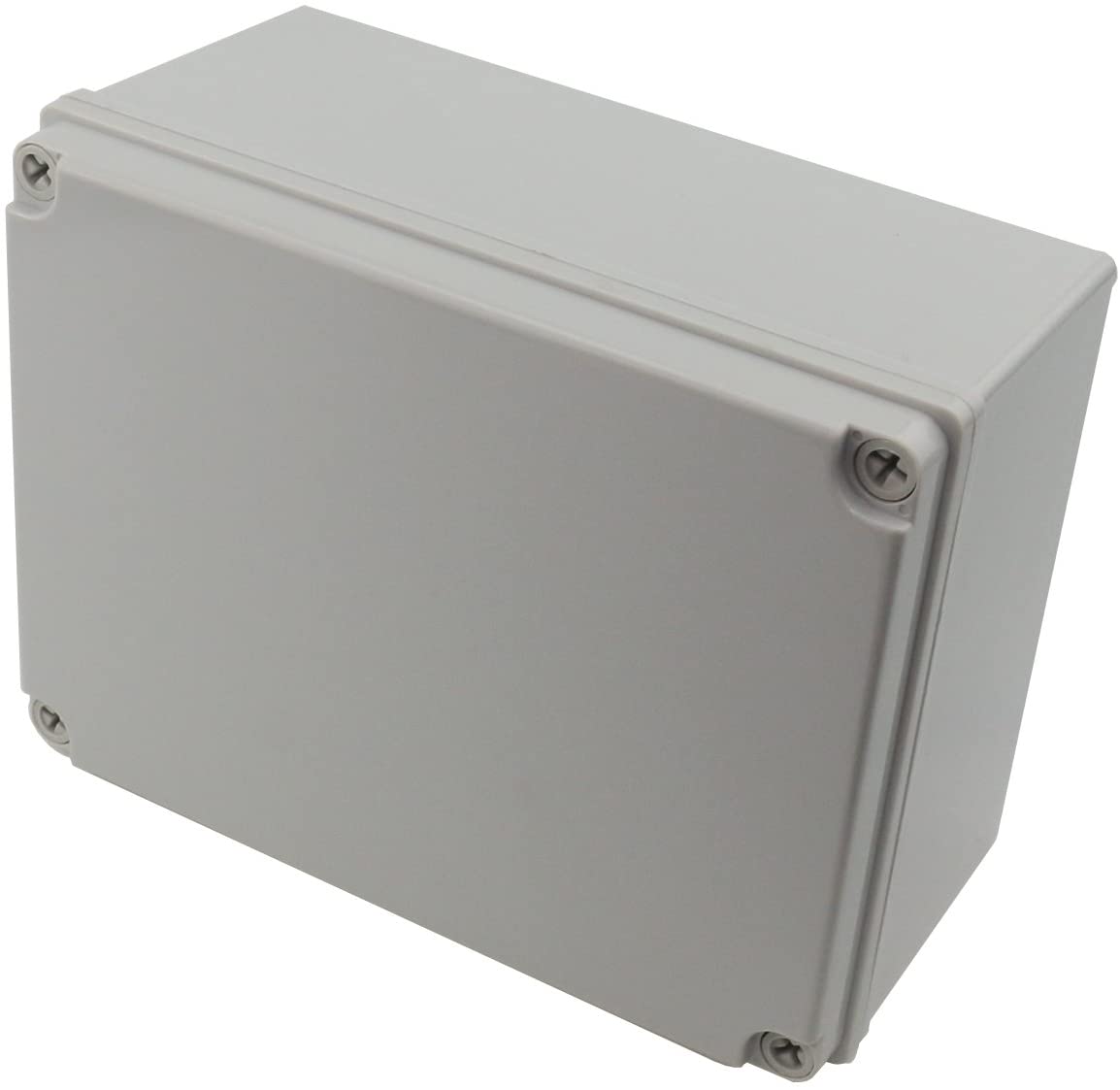

For projects like this I use junction boxes. They come in various sizes.

Designing the enclosure seems to always be harder than the solution itself!
Example: waterrpoof outdoor lighting controller with power supplies:
