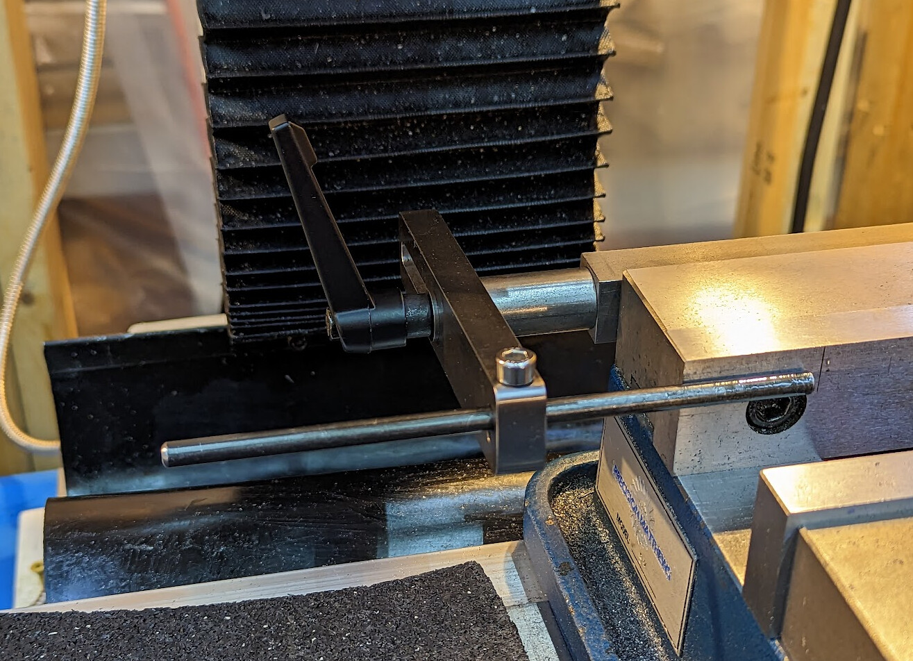

I cut 1/4" and 3mm rods, and rounded off the ends of screws to hold the rods in place. Initially, I used an old M8 screw I had in my M8 recycle drawer to hold the arms to the back piece. Here’s a family photo partway through:
I measured the longest spare M8 kipp handle I own, and cut a 35mm long spacer, with ends face flat, bored 5/8" (a nice close fit on M8 hardware), to hold the arm away from the vise in normal use. If I ever need the arm to be right next to the vise, I can just swap the spacer and the arm.
When I’m not using it, it will probably be nicely out of the way most of the time back like this, without having to remove it from the vise.
