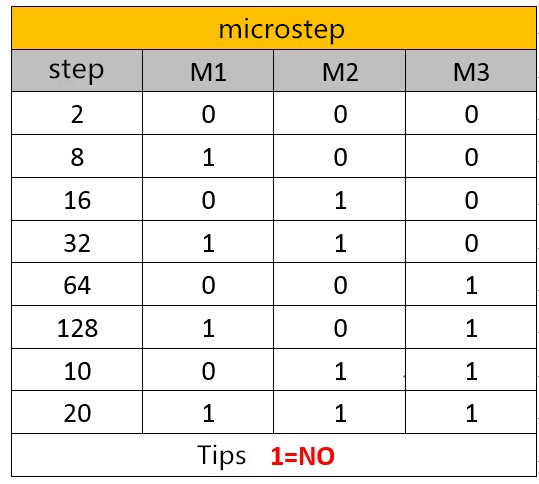

The LV8727 drivers I have for my OX have choices between 2 and 128 microsteps (no full-step option), and default to 2. With a 1000x1500 OX, I’m guessing that belt stretch will be my dominant constraint. I’m already down to 70% holding torque by using the minimum microstepping, and the next option is 8:
That would be only about 20% holding torque (relative to full steps). That doesn’t seem like a win.
I expect to be routing mostly wood and a little plastic. Is there any reason for me to use anything other than 2?
