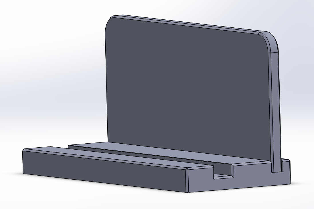

I made a parametric design in Solidworks that takes the eyeball distance and elevation as two primary parameters, and the phone dimensions as the other three primary parameters, and gives a phone stand that can be printed with minimal included supports (no slicer-generated supports needed).
Because I’m boring, all my models are greyscale. Sorry.
Empty:
Holding a phone:

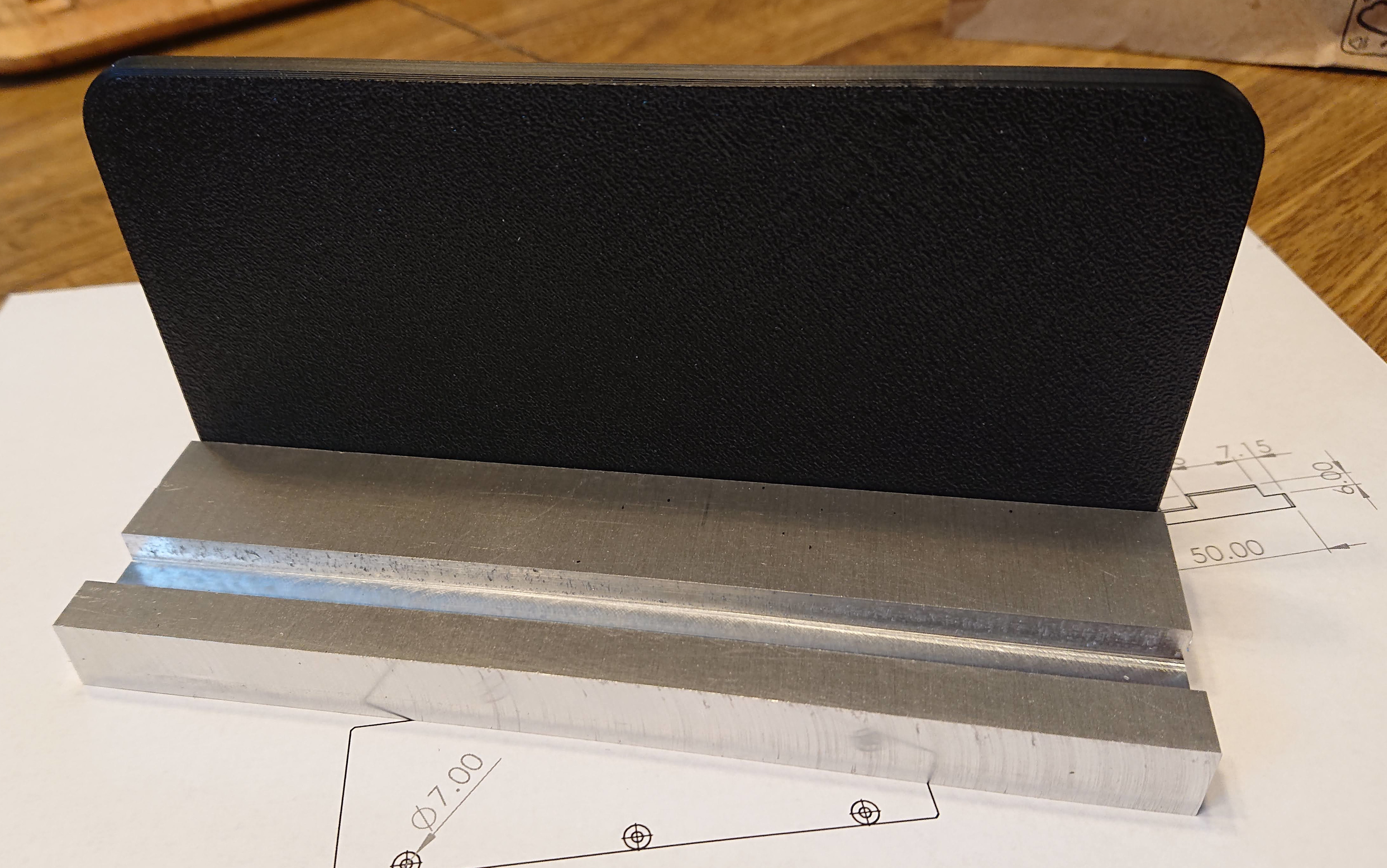

That was better, but one piece of the base still broke free from the bed during printing, spoiling the base but not the back. I should probably make the base heavier for stability, so while I’ve redesigned it and pushed the new design that won’t have this particular problem, I’m going to mill out a chunk of aluminum and use the 3d-printed back that looks fine from the last print for the back. That way the back won’t get in the way of WiFi reception, and two-tone textured black and sanded aluminum should look nice.

In the end, I suppose that chopping off a piece of aluminum and cutting a slot in it with an end mill isn’t that much more complicated than doing the same thing with a chunk of wood and a table saw, though it takes a little longer. The reason for the back and the weighted base is that this phone isn’t being used as a phone, it’s being used as a music player and is intended to live semi-permanently in the stand.
I couldn’t find any good light, and this is a hard contrast to photograph well anyway, and these pictures are before I took it back apart and broke down the corners to mail it, but…
But I’ve finally lived up to the category “Made by Makers” not just “Designed by Makers” :wink:
