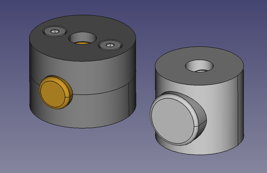

This is really in the not-quite-yet-made-by-makers category right now. I’m trying to design a quill stop for my mill. I want quick adjust, which means a choice between a squeeze nut and a push-button nut, and I want fine adjust, which narrows that choice to push-button nut. But I find for sale only a ½"x20TPI imperial nut, and I primarily work in metric.

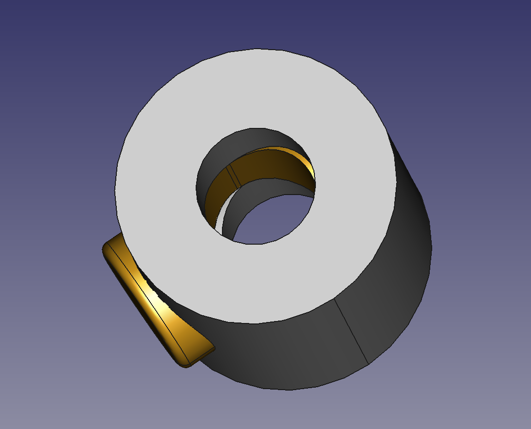

I don’t really know how the existing push-button stop nuts work inside (I’ve never seen one) but I can imagine one way to do it, so I modeled my idea in FreeCAD, and after going through a few iterations I got to something that I think will work, using an easily-available Delta RP4993 faucet seat spring that you can get on Amazon or pretty much any big box or hardware store. [Edit: Spoiler alert: this is way more complicated than the commercially-available units, it turns out! This post now has models of both kinds of nut, including the one that you might actually want to make…]
Here’s an example of it set up for the non-standard, fine-pitch TR 8 x 1 rod and tap that I bought:
Here are the parts (except for the spring; I didn’t model the spring):
I’m sure I’ll keep making changes, especially after I get around to making it, but… here’s where I’m tracking all my changes:

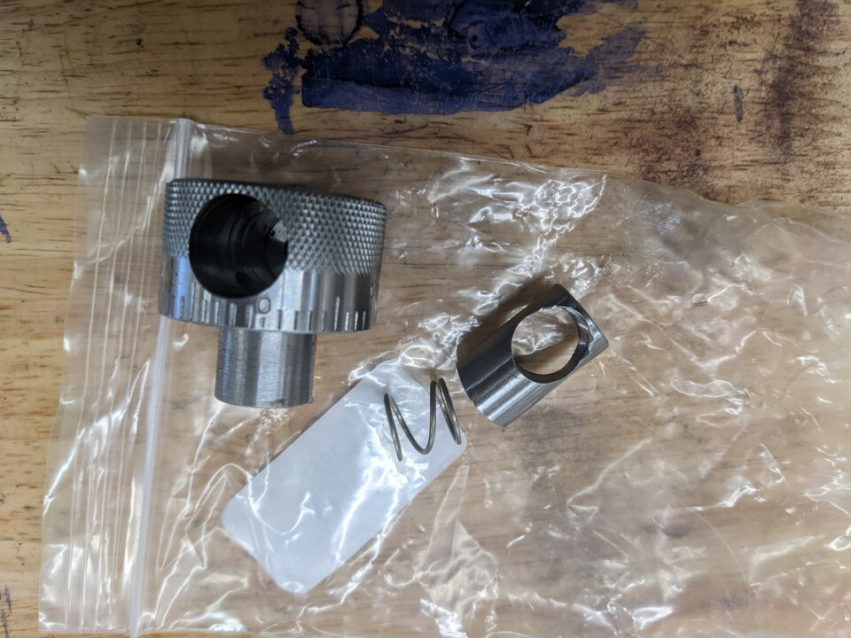

Of course, after I worked out that design and posted it, I found a picture that showed me that that the commercially-available nuts are much simpler. A single piece knob, a round plunger with a hole, and a spring, and the button is captive only by the rod threaded through.
This allows them to be narrower; no need for the extra diameter from a separate shell. On the other hand, getting extra thread engagement requires either a larger total diameter or a racetrack button and corresponding hole.
If I had heard the joking term “educated nut” (it has graduations printed on it, “graduated” → “educated” sigh) I could have found these pictures faster.

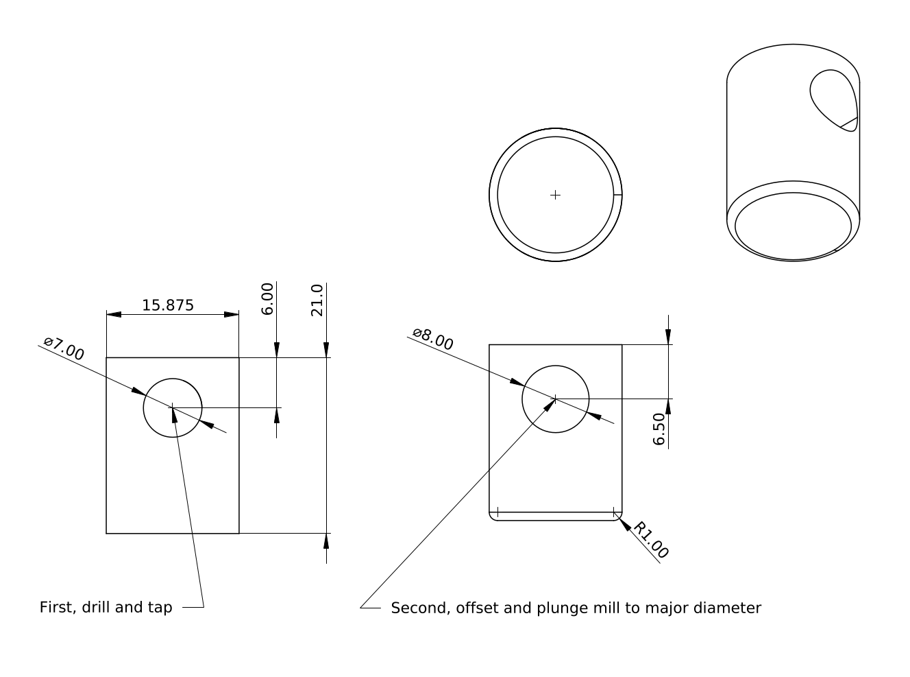

I haven’t yet made drawings for the simpler version that more closely follows the model in the picture I found, but I’ve created a parametric model of that simpler version. I’m doing some things different from the commercial unit. In particular, the commercial unit has an asymmetric collar for the threads to bear on; I’m using the same approach as the complicated nut of having three threads worth of contact at both the top and bottom in my simple version. It’s symmetric and I like that.
Here’s the model with 5/8" stock for the button and a 25mm nut body (a skim pass on 1" / 25.4mm stock). The outside diameter is actually not a critical dimension; there’s plenty of room for the spring. This uses the same spring as the original, and in fact is driven from just a few new parameters in the spreadsheet.
My weird complicated nut might actually be useful for the 1mm pitch because I can make it arbitrarily taller for more thread engagement without making it thicker, and 1mm might need that to stay put.
The normal nut should be fine for 2mm pitch or even the classic 1/2"-20tpi thread in between the two metric pitches.
In this one, as in the commercial unit, the rod holds the button captive, which should be fine.
Drawings for the classic style of nut:

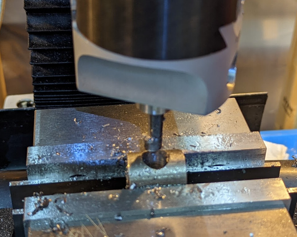

Got to work on the nut. I decided to use 1" stock and leave the rough finish on the outside, as an aesthetic choice that forced me to recalculate depths slightly. I also decided to make a single nut body long enough to accommodate both the 1mm and 2mm lead screws. After cutting a piece and facing both ends, I drilled it out to almost 8mm — 9/32" — and then drilled it through with an 8mm end mill. Then over to the mill.
I realized that I didn’t have a great way to fixture it, so I put it up on parallels, found the middle, milled a flat face on the top, and drilled a pilot hole.
I don’t have a 5/8" mill to plunge, so I pulled out the boring head after milling it out 1/2" so that the boring bar could fit. (I actually milled it to 12mm oversize for the spring pocket.) Interrupted cuts are a pain.
Cutting through the hole in the middle meant that it recut chips a lot. I stopped frequently to clean them out, and used copious amounts of oil as I went to help it flush the chips out.

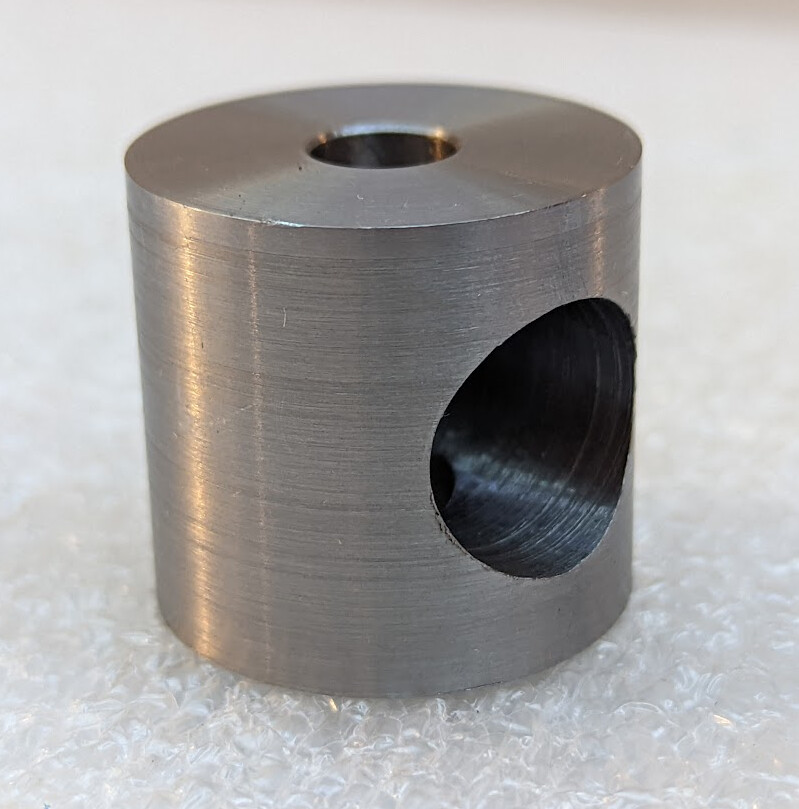

Here are a few views of the part so far:

It looks good!
Sadly, it doesn’t function, because I did something wrong while centering, and the hole I bored in the side is a bit off-center. This means that I can’t actually use this one, it’s just decorative. For weird values of decorative.
However, the half-threaded nut itself works. I can run it up and down the rod on the smooth side of the hole, but the threaded side engages well. So starting over and making a new set and taking more care to center the hole should work.
I think that my fixturing was not good. If I make the whole nut on the stock and then part it off, it will be easier to fixture. I started by cutting off to near final length on the bandsaw and I think that gave me challenges that I didn’t actually need.
Also, the unfinished outside I thought would look nice just doesn’t. I’ll at least polish it up with scotchbrite if not skim it smooth for the next one.

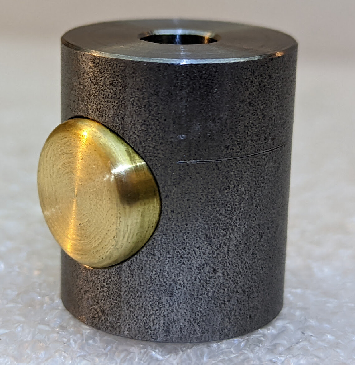

I started over. This time I centered directly on the stock; previously, I centered on the vice jaws with a collet holder in them that I thought had low runout. Maybe I did a poor job of centering off the jaws, or maybe the collet holder has more runout than I thought. I measured repeatedly as I went to make sure I got it right this time. I also used a piece of 0.001" shim stock as a feeler from the body of my edge finder with the mill stopped instead of watching for the bottom of the edge finder to kick out. I kind of like this method and might use it more.
I started with 1.25" 1215 stock and cut it down to 30mm diameter. Just for fun and practice, I hit within .0005" of 30mm for the diameter. I know that’s a weird way of expressing that. I have an imperial lathe without DROs, so I set the micrometer to 30mm exactly, put it in incremental mode, change it from metric into inches, then measure difference from target as I go, and the measurements translate directly into marks on the lathe dials. :relaxed:
The 30mm wide nut (about 28mm tall; you’d think I would have just made it square…) has a much better feel. And I might be crazy enough to try 100 lines on the fine side.
This picture was before I noticed that I needed to fettle that large hole some more. I tried to use a diamond needle file to work the edge until it was comfortable to the touch, but ended up with a deburring tool. I also had to use that to clean up the insides of the intersections of the holes. That was a slow process.
Then I made a new plunger, taking the same care to center everything perfectly. This time, before I cut it off to length, I made sure that the screw would fit through — if I had messed up again, I could have scrapped less material to start over another time. But it fit nicely!
I cut the plunger to length, put a light fillet on the outside with a chamfer tool and a file to round it off, polished it lightly with scotchbright, and it’s ready for engraving.

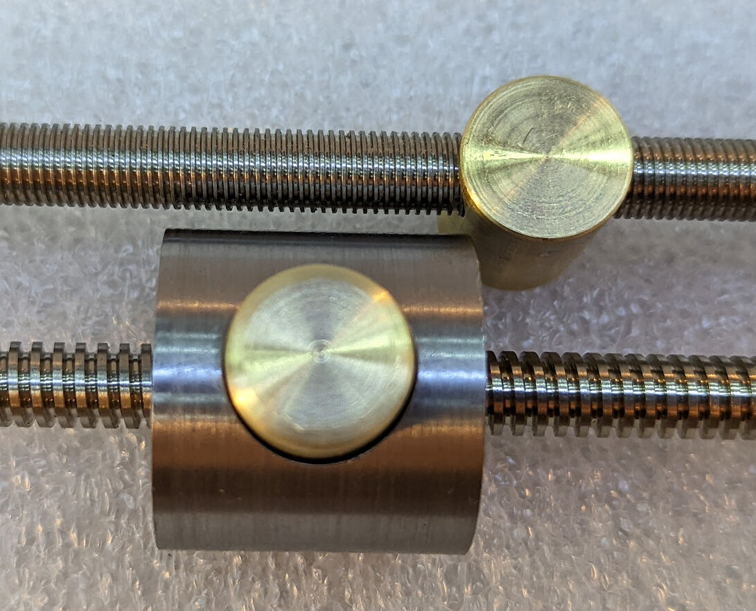

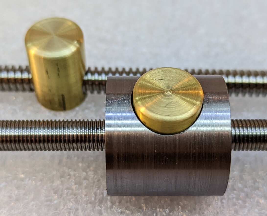

I want a single nut body with two buttons, one each for TR8x1 and TR8x2, so I can use two separate rods depending on what I’m working on; probably TR8x2 for most work, but TR8x1 for higher precision work. They have the same major diameter (8mm) so this shouldn’t be a problem.
I did the TR8x1 button first, and intentionally made it tall enough to support three thread lands of TR8x2 so that one nut could work for both rods. However, when I bored out the body, I didn’t think about the extra half millimeter of travel that the TR8x2 nut would need to disengage the threads when I made a TR8x2 button. Rather than try to set the nut up perfectly to bore out another 1/2" of depth, I just took half a millimeter off the spring end of the new TR8x2 button so that it could depress enough. I also milled a slot to make it easier to move when it is disengaged.
So now I can switch easily between the TR8x1 rod…
…and the TR8x2 rod!
