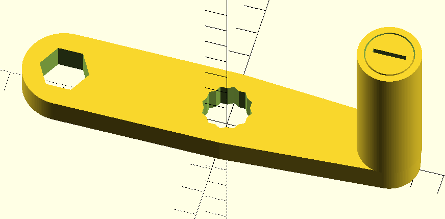

So I modeled it. It allows you to choose the size socket, whether to use a six-point or twelve-point socket, the length between sockets, what thread spec to use for attaching the handle to the crank, how much plastic to put around the sockets, how many thread turns used to attach the handle to the crank (and thus how thick the crank is), how long to make the handle, how thick to make the handle, and how much margin to leave between the handle and the shoulder bolt so that the handle spins freely on the shoulder bolt:
socket_size= 5/8 * 25.4; // 5/8" — 0.625 * 25.4 = 15.875
base=60; // lengths between centers of holes (sockets and handle)
margin=6; // thickness of handle outside sockets and handle nut
thread="M10"; // thread spec, M10 is coarse thread M10x1.5
turns=6; // thread turns; thickness will be turns + 1 * pitch of thread
twelve=true; // false for six-point sockets, true for twelve-point sockets
handle_length=70; // total including depth of crank
handle_margin=0.5; // space between bolt and handle
handle_thick=5; // thickness of shell of handle and of bolt head

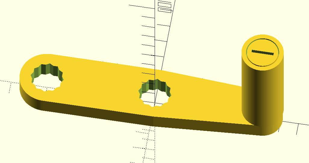

The central socket hole is for speed; the end socket hole is for strength. I think the default should be that the central hole is twelve-pointed and the end hole is six-pointed, like this:

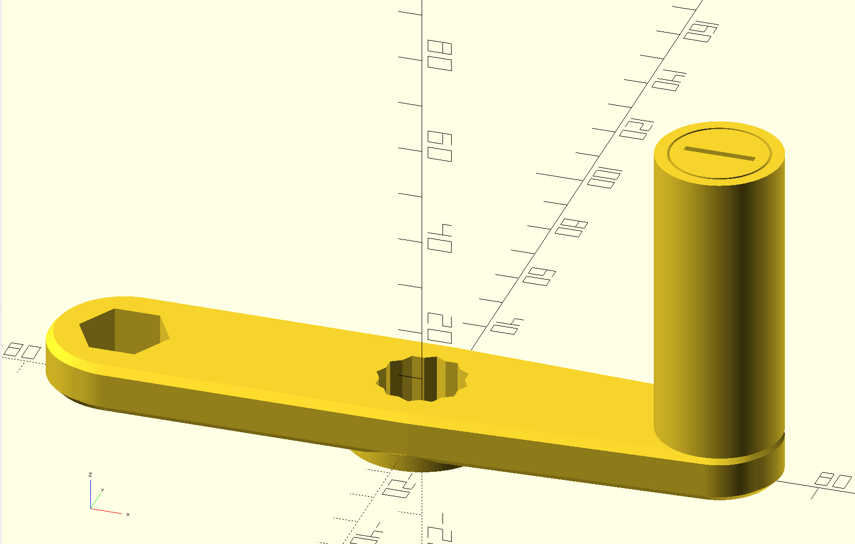

When I first made this, it broke, so to make the existing design stronger, I embedded a smaller metal screw for strength inside a 3d-printed screw. This was needless complexity! I was constrained by my initial idea. It did last three years, so yay! But now I’ve come up with a modified design that is less complex and yet more robust.
I have some extra M10x30 countersink screws from my outrigger vise stop project (that will be another post when I finish it…) so I used those in the design, but you can just choose your screw and thread profile if you make your own. With OpenSCAD nightly builds now enabling the Manifold kernel, even though I’m modeling threads, rendering is almost instantaneous!
