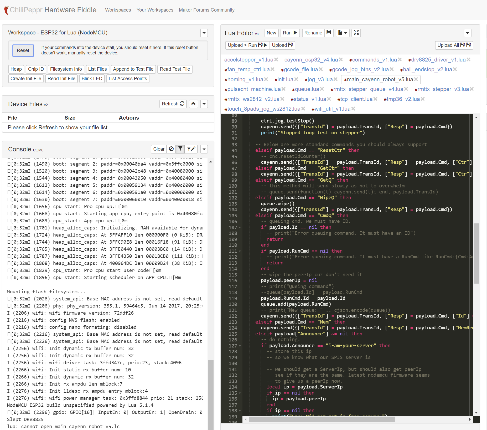

I have built the board, have all the components wired in, and loaded the Lua code from robot-actuator-esp32-v8-master. I loaded the code through ChiliPepper Work space.
Questions:
Is the "cannot open main_cayenn_robot_v5.1 a problem? Screen shot
When I go to the Chilipepper workspace, it says I should choose robot in the json drop down, my json drop down does not have robot or robot2?
I saw from Johns video that he knew he was operational with his board when the WS2812 (white led lit up) Mine does not light up, when should I expect that?
The ESP is lit up and the 5V power led is lit up.
Thank you

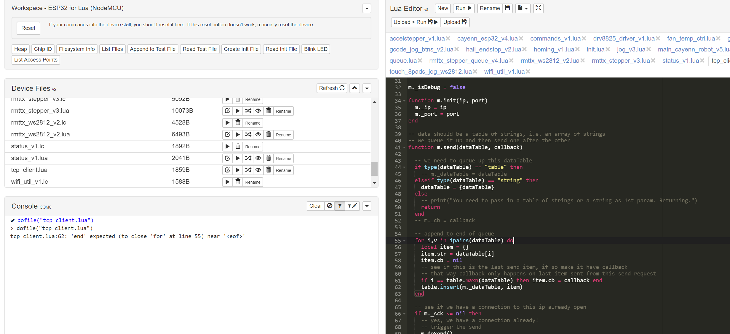

Wow. You got really far. Yeah, are you sure you uploaded all of those Lua files to the ESP32? They seem to have red asterisks meaning you didn’t hit save on them (if you modified them, which i doubt you needed to). That Upload All button can be your friend. Then you should hit Refresh on Device Files to see all your files on the ESP32. Post lots of screenshots as they massively help us/me figure out what’s going on.

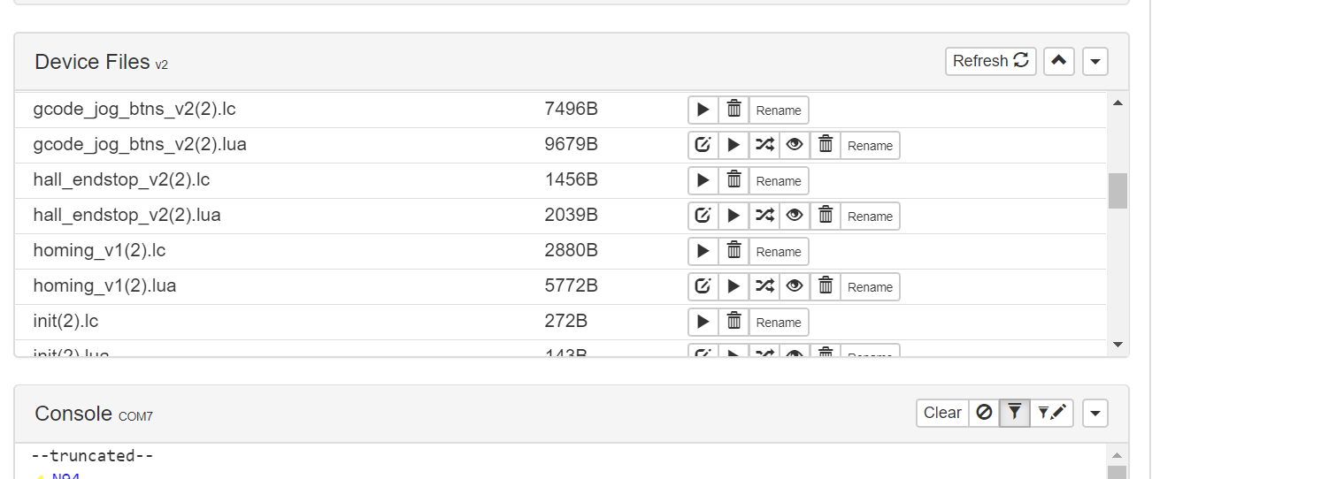

2b. Upload the Lua code, it looks like it all uploaded fine this time. I made sure the scrips were all new by renaming them with (2) at the end.
I did hit the run action for each device file just to see what happens. There were some that did not execute, I do not know if that is a problem?

Hmm, you might want to do a tutorial on how to create Lua modules to help understand how all of the code works together. Renaming the files breaks everything as they all have a “require” line at the start of each file that tells Lua what sub-files to load. By renaming you broke all those “require” lines.

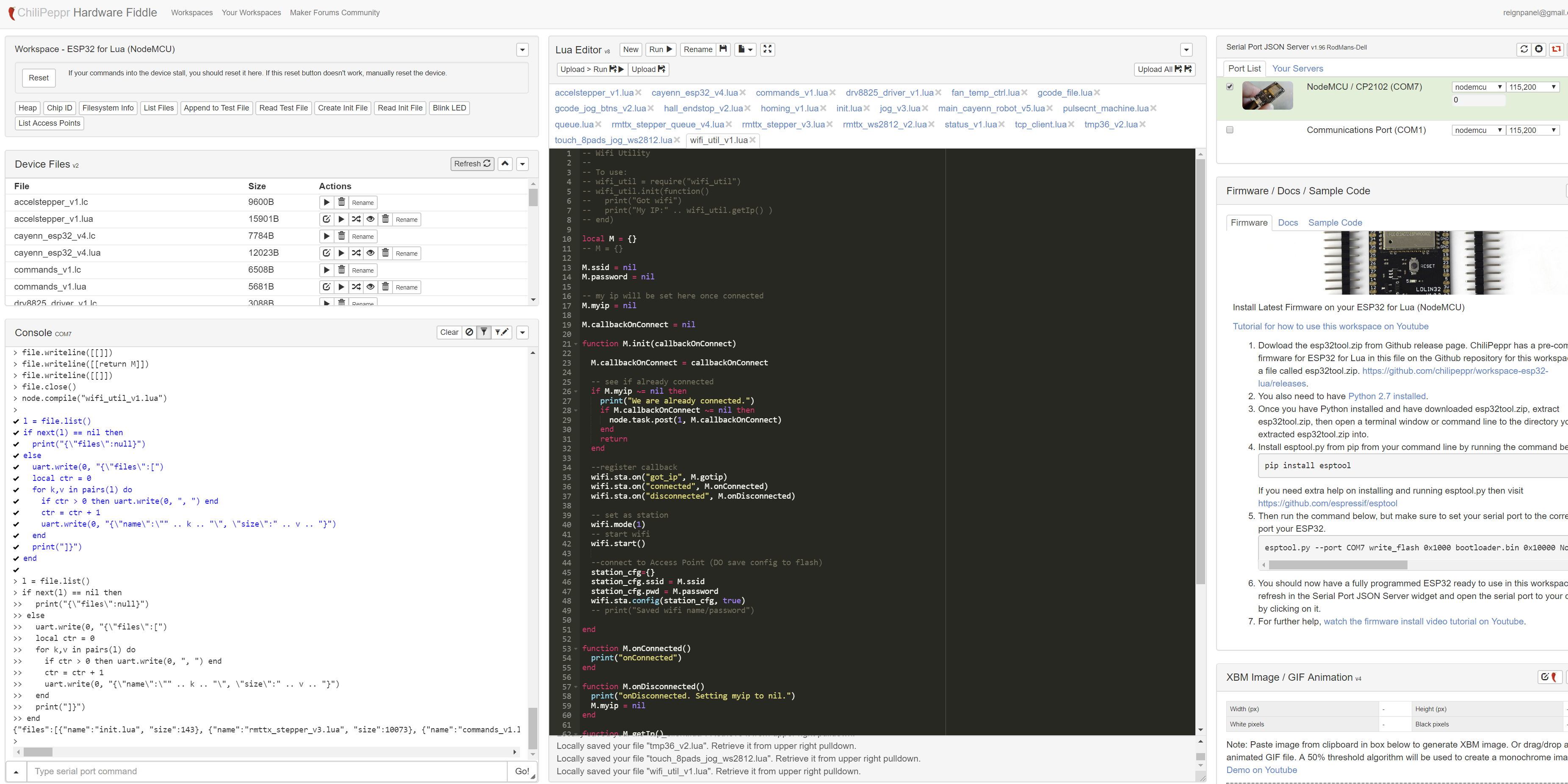

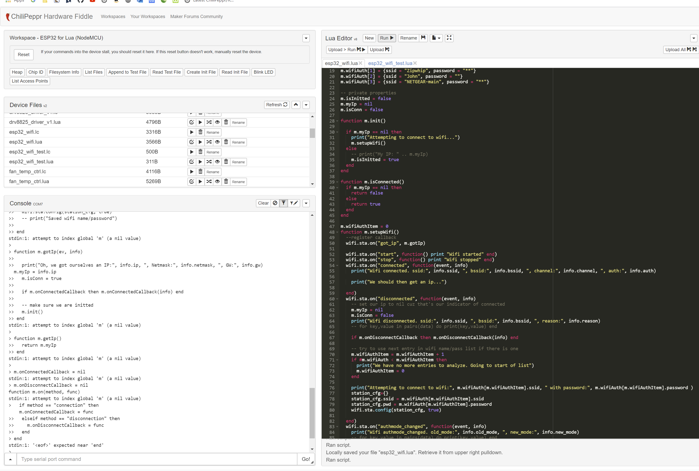

I uploaded the sample esp32wifi code, its scrolled past my password and SSID on the edidtor screen shot. I ran it
I uploaded the sample test WIFI and Ran it
I edited the wifi_utility code to have my SSID and Password, it is scrolled past that on the editor, I ran it.
It still does not show up on the Cayenn devices… guess I am stuck here!

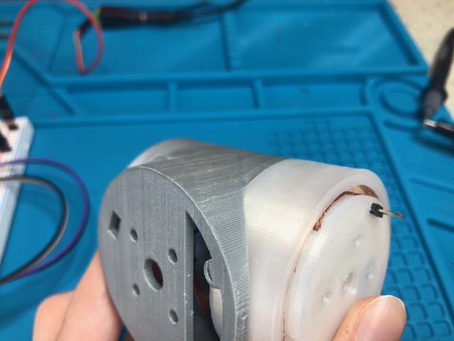

Here are some photos and advice.
This is about my 5th actuator circle, 3rd un-smoked esp 32. Recommend if you have not soldered surface mount before or not for a long time, do some practice and get extra actuator circles. Also, don’t forget to set your step down power supply to 5V. I don’t know what its set to out of the box but I did smoke 1 esp 32 with it and the other by miss-wiring. I tried right out the gate to get the PCB set up wired into the wrist shell before testing… don’t do that! Bench test the board with motor, fan, temp and hall effect jumpered. Getting the pcb to fit into the wrist shell is a job in its own and requires custom jumper wires. You should know it all works before stuffing it into the shell.
Fusion has two files you can follow to build the board, the “Actuator Circle” file actually has some extraneous male pins shown for the DRV, if you solder them on you will wind up replacing them with female when you go to plug DRV. The actuator circle in the “BotBot” file is has it correct. There are a few other things that the BotBot File shows better, I recommend using it to review the components.
The White LED is wired in by the jumpers in the photos because I had been breaking it off accidentally in my subsequent test boards, it really should be soldered directly to the board. The other jumpers go to the Hall effect and temp sensors. I don’t have the fan plugged in in the photo.
The actuator took about 3 attempts to get, I finally settled with nylon and 100% gears. I did its pre-testing with a simple Arduino circuit. I used PVA supports between the flex part and the base of the ring, I guess you don’t have to do that.
FYI: I found that a portable foot spa with bubbles and heat is really good at resolving PVA.

I just looked for you. It’s line 8 thru 10 you have to edit to setup your wifi settings in robot-actuator-esp32-v8/lua/ main_cayenn_robot_v5.lua
– **** User Defined Variables **********
cayenn.ssid = “NETGEAR-main”
cayenn.password = “****”

BTW, that shell looks too small for that actuator. It doesn’t seem right in the photo. They should be identical diameters. I don’t recall any major change in shell diameter such that it would have been a file version, although then again maybe, but is it just an optical illusion in the image that the shell is so much narrower than the actuator? or is it that just you don’t have it screwed down so it’s just off center?

You have a good eye, I had some fit up problems and had to torque the shell a little to get it screwed down. Once I get the board working I’ll get the shell/actuator perfected. I will probably make the shell a little bigger though in the final version, I had some problems getting all the wires to cram in the first attempt. And you can see I eventually broke the bottom of the shell on one of my attempts to pull the board back once I had it wedged in.
Yes I am using that repository.
Ok, in that photo the shell looks fine. Maybe it’s just the white actuator vs the grey shell color. Yeah, I had a very hard time fitting all the wires in. That’s why I ended up using very soft silicone wires and really small ones for the TMP36 and the wire connectors. I believe i put a link to the aliexpress 4pin silicone wires.
Sometimes I find that when uploading the files, especially lots of them in a row, the lines can get corrupted. So my guess is just re-upload it and see. Or dump out the contents of the file from the ESP32 and compare to the original file to see what went wrong. From that screenshot that code on the right looks correct.
That actually fixed that issue for now.

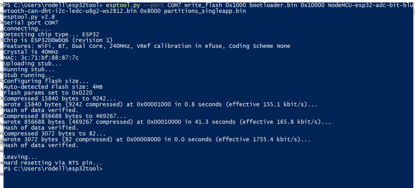

Yes, the “is the attempt to indext global “rmttx” (a nil value”) a problem?" is the problem. You are not running the firmware I included in that repo. Or, you are, and I screwed up the latest version of that firmware. Did you upload the firmware I included in that Github repo? It has the rmttx C module I wrote that is an add-on to the NodeMCU base firmware. It let’s the stepper motor steps be queued up in the RMT hardware for smooth step delivery with acceleration/deceleration to the stepper motor.
Oh my G, I had been loading the esp/32 firmware from the workspace link instead of loading the firmware from the repo. Your instructions were quite clear, sorry I have been wasting a lot of your time.
Starting a redo now…
To be clear, the firmware repo looks like this
I am running the command
esptool.py.exe --port COM6 write_flash 0x1000 bootloader.bin 0x10000 NodeMCU-touch-pulsecnt-rmttx.bin 0x8000 partitions.bin
From the directory it looks like this
PS C:\Users\rodell\Downloads\robot-actuator-esp32-v8-master\robot-actuator-esp32-v8-master\firmware> esptool.py.exe --port COM6 write_flash 0x1000 bootloader.bin 0x10000 NodeMCU-touch-pulsecnt-rmttx.bin 0x8000 partitions.bin
That is all I am doing for the firmware.
There is a file buried in the SCR folder under modules called rmttx.c, I assume that is being picked up in the firmware update above?
You got it. That looks correct.
