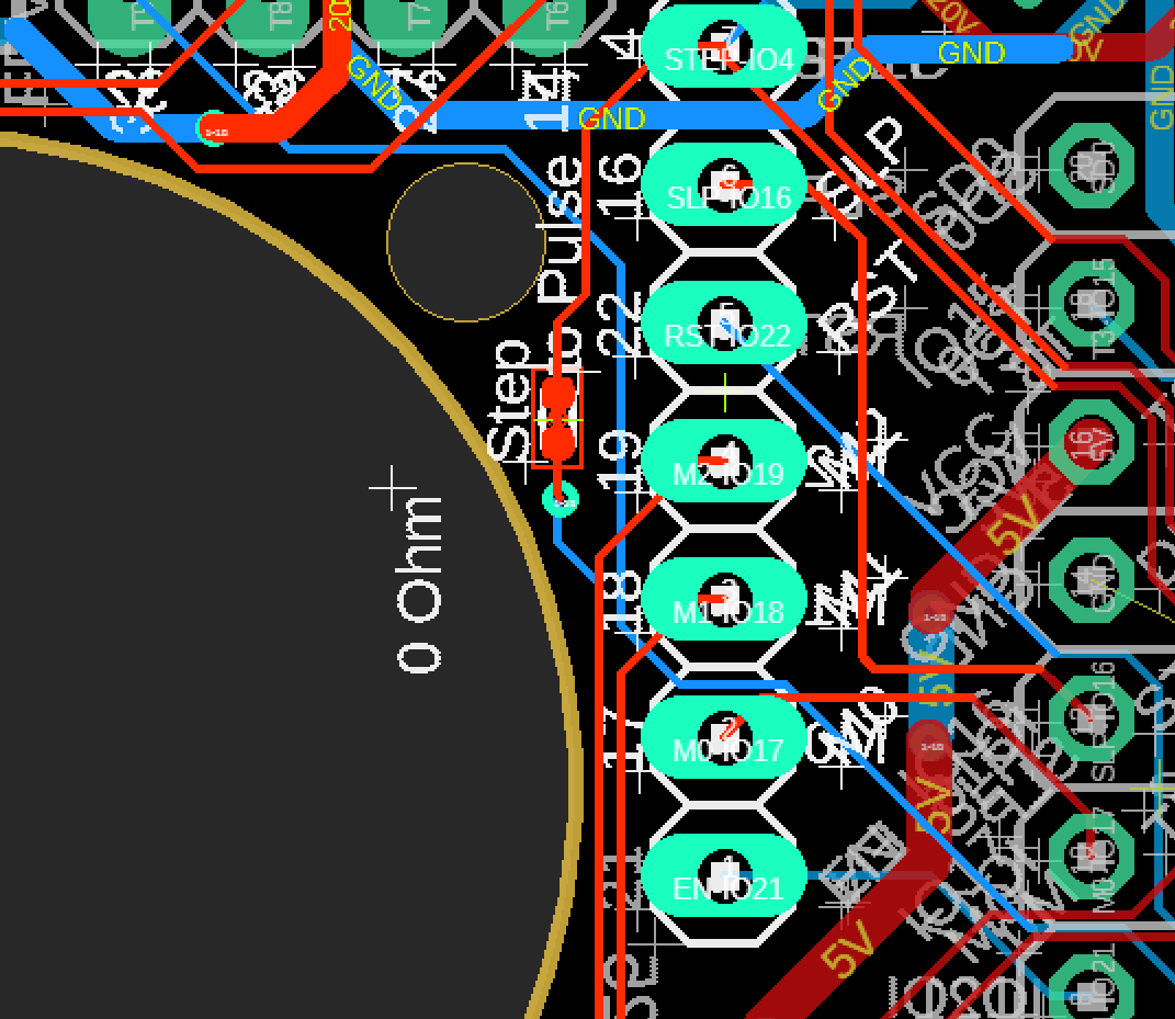

Does a resistor really go here, 0ohm?
That 0 ohm resistor is already connected. Just don’t cut it, otherwise you’d have to put a resistor there. It’s the connection point between the stepper pulse out on the GPIO and the loop back in to the GPIO that counts stepper pulses. This is needed because when jogging we’re just using PWM frequencies and thus only know the stepper steps due to this loopback signal.

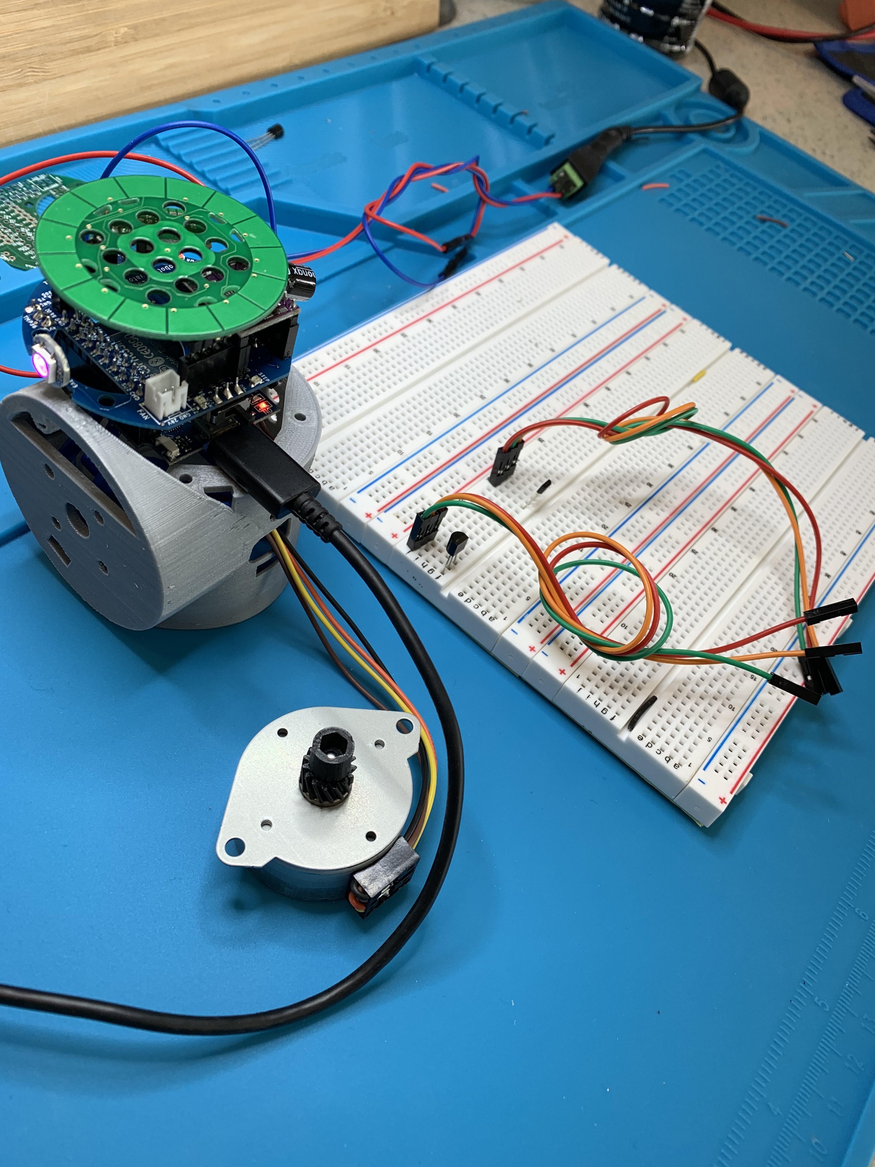

Getting the correct firmware got me a lot further that is for sure, now I am hung up with a hardware error which is why I built a second board from scratch to make sure it was not my soldering. Getting same error with second board.
I will get some screen shots to you.

Okay! Progress!!!
John, I still would like to take you up on a screen share to get the rest going!
The touch pad is working I can see the arm work space console respond to the touch pad and the white LED is responding as well, first time I had that working.

I am still not getting the board to show as a cayenne device in the arm work space, guess that is where to start.

Here you go John, all set up an ready.
This is the best indication yet, the code finally stopped continuous scroll on the left and is now stopping after each command. Led stepper light goes on with touch and finger slide, the status light is orange when sliding finger, white when the center touched, pink on stand by. I was not getting any motor movement but it got hot anyway so I unplugged it.

Do I need to get a 0.0 ohm surface mount resistor? If yes where it should be mounted exactly? Thank you.

No, you don’t need a 0 ohm resistor. That is already connected on the PCB. I wasn’t sure when I designed it if I truly needed the loopback as there is supposed to be a way to map stuff internally inside ESP32. I just haven’t quite figured out how to do that yet, so i took the hardwired approach.
