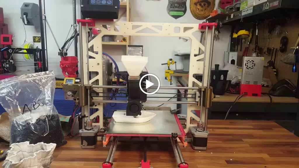

Pellet extruder with 0.6 mm nozzle, layer: 0.3 nmm,
Pellet extruder with 0.6 mm nozzle, layer: 0.3 nmm, calibrating steps and mixing colors with samsung pellet, this works !!!

Have you tried how it mixes pellets with a masterbatch yet? I could imagine that the screw is a little too short to get consistent coloring in the plastic.

@Cristian_Martinez , @mahor_muniz_cadenas sure can give us more details, I have published a video with the assembly of pellet extruder, https://www.youtube.com/watch?v=U3y28Xm6qKI
It is in Spanish but the details of assembly are seen.

@Daniel_Stauffer I mixed black and white abs, the mix was good and the result was a gray but I’m newbie mixing I suppose we’ll learn to make good mixtures of colors as the filament manufacturers do, surely they can have similar results.
@Cristian_Martinez yo lo monte sin problemas, pero esta extrusora es para piezas grandes, con boquillas de 0.6 mm a 1.2 mm, seguro que llena su MK2 rápidamente!!!
Acabo de comprar una de 0.6 y una the 0.8
@Miguel_Angel_Salmer1 its good mixing with abs from filament to add printing proprieties
@Miguel_Angel_Salmer1 also is good for 0.4 nozzle and thin layers, try it
