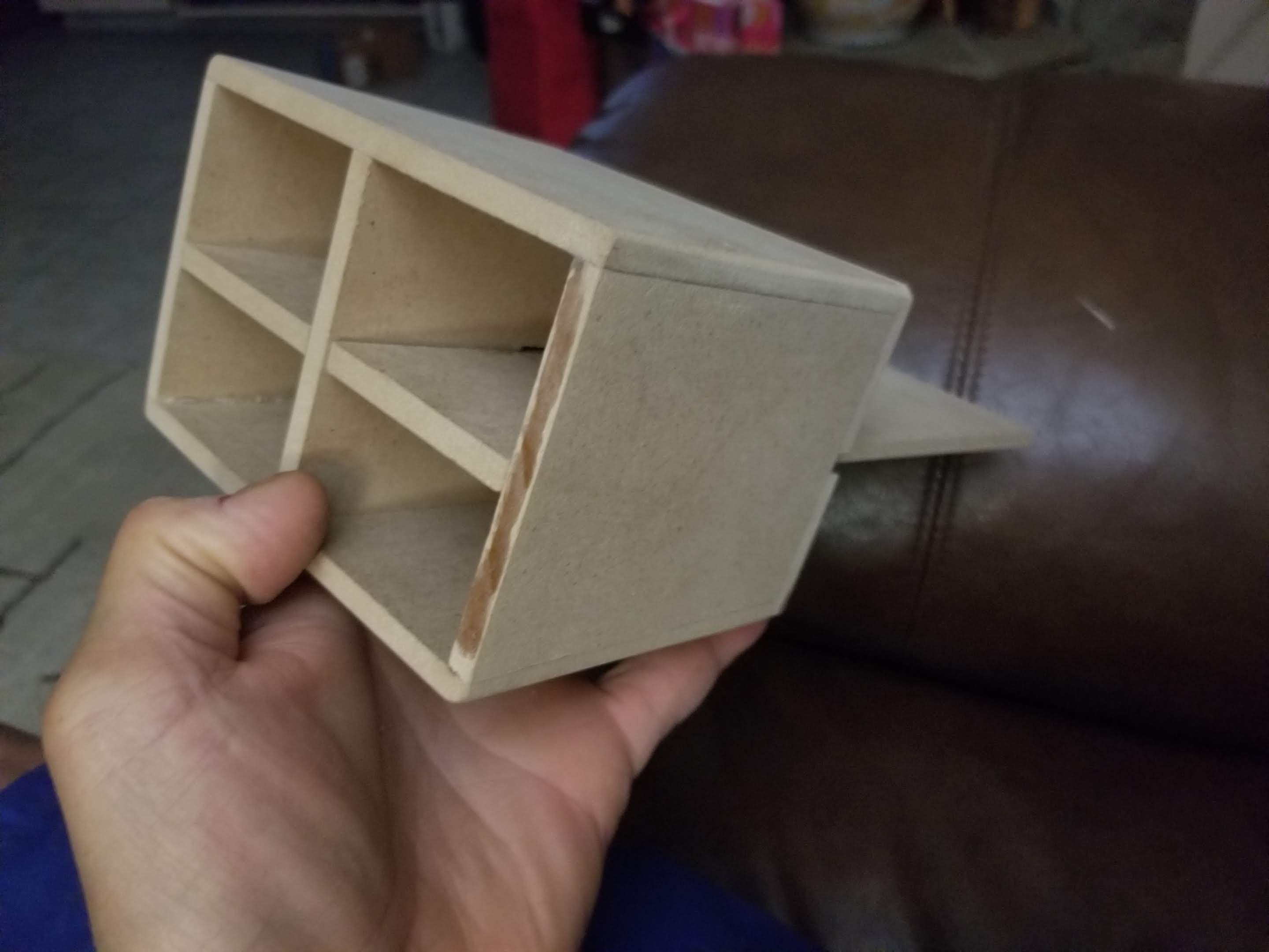

I use it extensively on low force assy that need a fast setup time like this remote control holder.
In this case I apply CA and wood glue on one edge and accelerator on the other. The CA and accelerator hold the assy in place while the wood glue dries.
