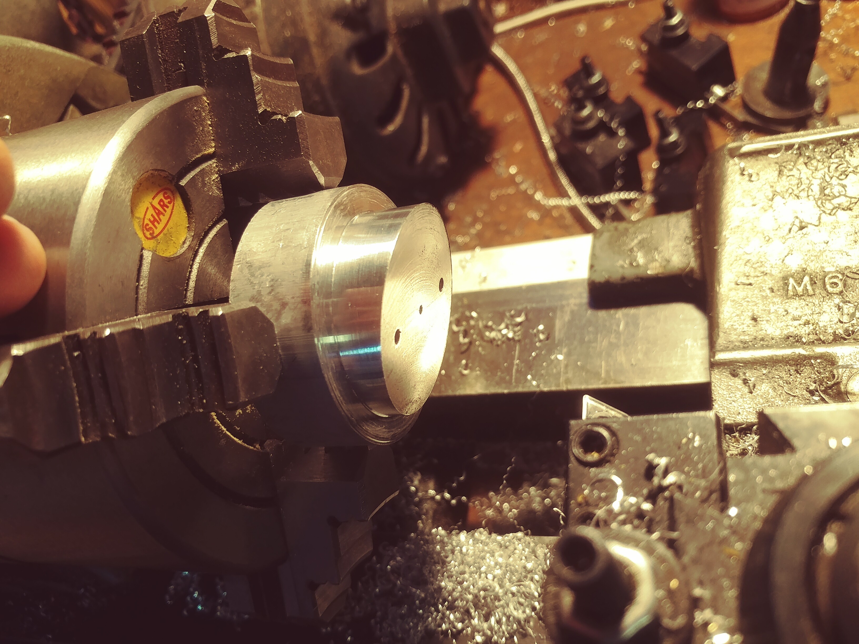

Here’s a pic of the setup for cutting the throttle plate. It needs to have the edges beveled and be cut elliptical, so when it is in the closed position it has a circular cross-section to the bore even though it’s at an angle.
As it turns out there are behavior changes depending on the angle: a throttle plate cut at about 6 degrees to the bore opens faster, so is more compatible with a high rpm race engine; a throttle plate cut at 12 degrees (which appears to be the standard) is more gradual in its opening and more compatible with a car being driven around in town.
I cut the chunk of aluminum cylindrical, then took it to the mill and mounted it using an angle vise and sine bar, flycut the top to the right angle, marked and drilled the mounting holes for the throttle plate, then recentered it on the lathe, made a cap plate to hold the metal down, and cut an oversized piece of (in this case) 0.060" thick aluminum to bolt in the middle, and lathe cut it to the right (in this case 42mm) diameter. This is in fact a little large for the engine I’m using.
