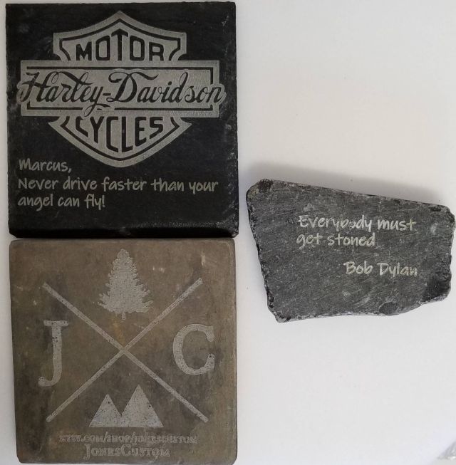

When you laser on most slate and rocks, the etch can be very light looking. Checking out other forums for answers, most agree that pre-coating with varnish or shellac can bring out the contrast. Here is some experiments pre-coating with varnish.
I have been post coating my slate engraving with a clear sealer. Will have to see if there is much of a difference between pre or post coating.
I spray with poly after …
