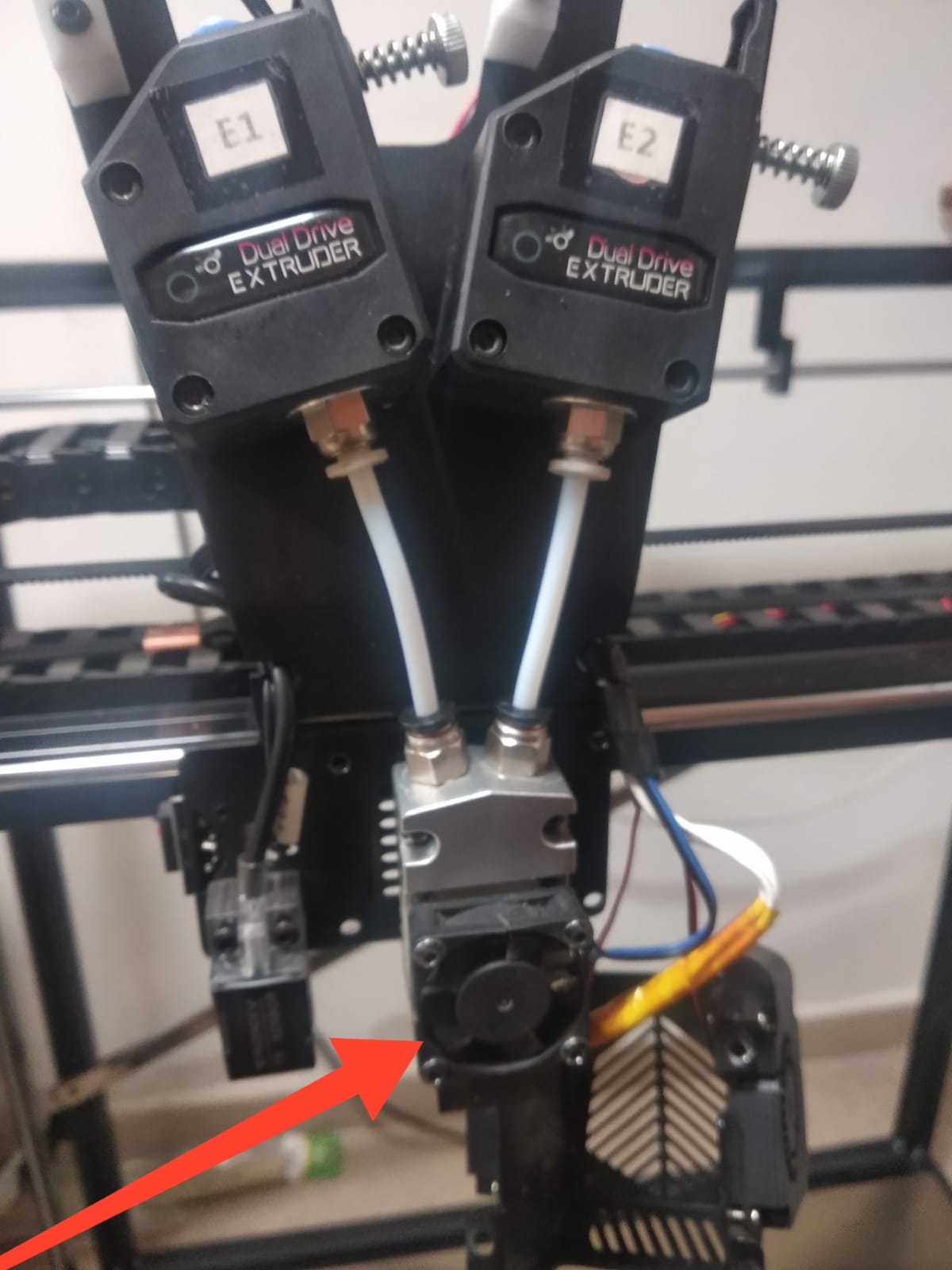

I have a Tronxy VEHO 600 2E, it has a double extruder even though it only has one nozzle. It has a 30 x30 x10mm fan for throat cooling that always works at 100%. Tronxy only offers the technical information of the fan partially, it is 24 volts, 0.5 amps and 9,000 revolutions per minute, it does not say anything about the air flow. I have bought a fan of the same measurements and voltage, this one is 0.6 amps, it is a double bearing, it reaches 12,000 revolutions per minute. The intention is to replace it and make it work at 75% to lower the revolutions to 9,000 per minute and reduce consumption to a maximum of 0.5 amps. Being a double bearing, I suppose it will reduce the noise.
Is this idea viable? Or I better not do it, I installed an original fan.
