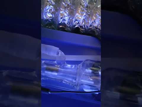

I know this is a long shot as this feed over 3 years old but i need some help i think my tube has gone just received this k40 from Facebook so no warranty no matter what power percentage i run at it only puts out 4-5 amps will attach a video here is a link as video was too big.

@harrison_fletcherpri there is no way to tell if a laser tube is good or bad just by looking at the tube while you fire it. And the fact that you are reading off percentages tells us you probably have one of the K40 machines which has what is called, a digital display. THAT in and of itself is a problem and as @HalfNormal mentioned you can learn all about by reading all about the K40 in the K40 Intro linked at the top right of this page. Or also: Don's Laser Things: Understanding the K40 Digital Control Panel???
