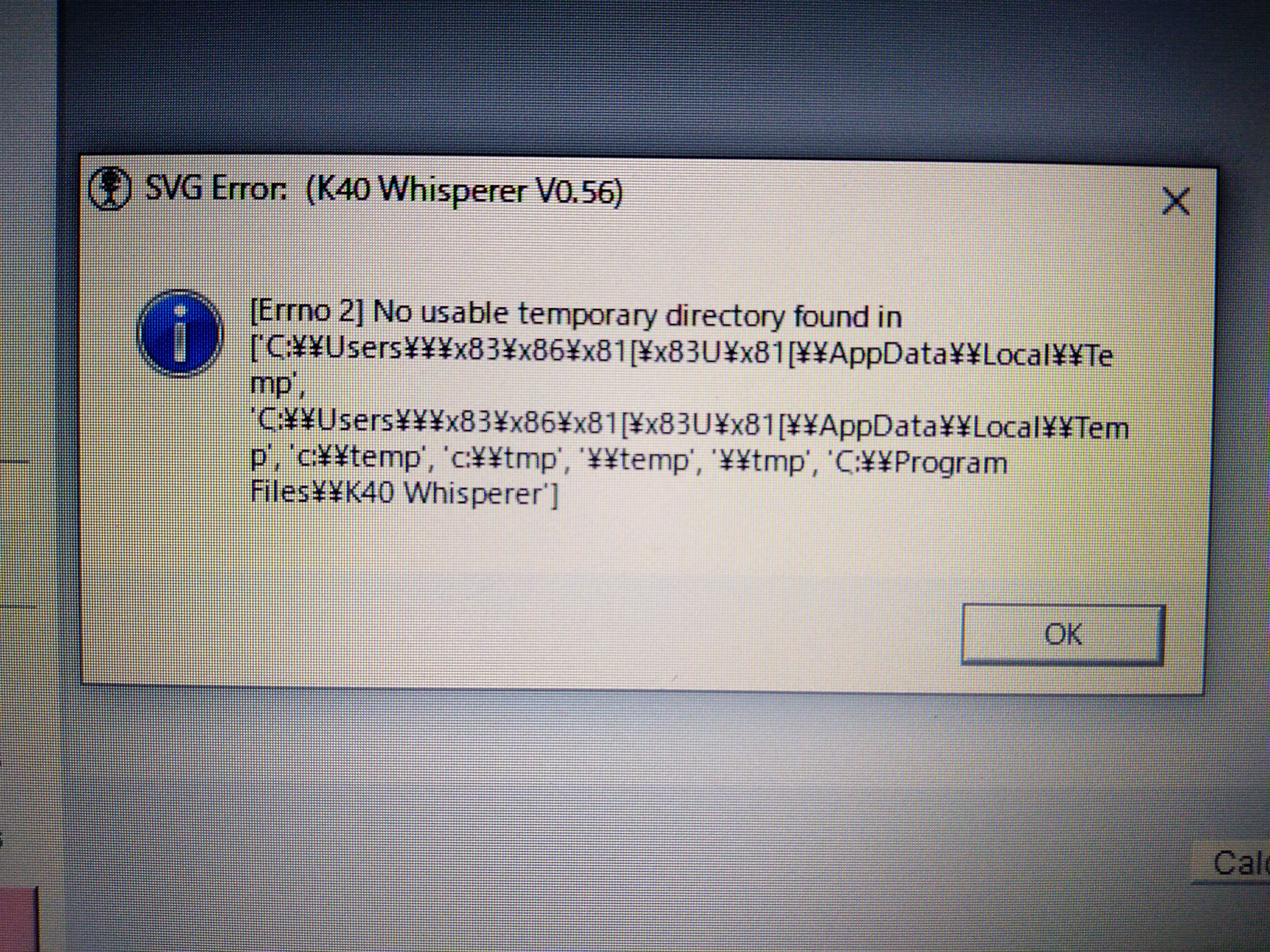

Please let me know. Unable to open SVG file with k40 whisperer
Unable to open SVG file with k40 whisperer.
You cannot open the file using the sample on the official website.
Teach me Please.
This is a picture of the error.

The error window has some characters that are not typical (i.e. the character that appears twice after C:) Generally the character in those places would be “”. I don’t know what would cause this. Possibly your operating system language is set to something other than English. I don’t know if the characters are causing an issue or not but it is something that I have not seen before.
Getting „ instead of \ is an ASCII thing. There was no code point reserved for „ (the yen currency symbol) in 7-bit ASCII. As a workaround, lots of Asian fonts simply replaced the \ character (0x5C) with „.
So, there is nothing wrong here. That’s just how a “backslash” looks like with that font.
In order to get to the message shown, K40 Whisperer must have found the Inkscape executable and Inkscape was execited to creste the raster data. After that the raster data was not found in the temp folder.
I am not sure what is causing this error. Usually this error ocurs when the wrong execitable is specified in the general settings entry. If that entry is blank I am not sure how this happened.

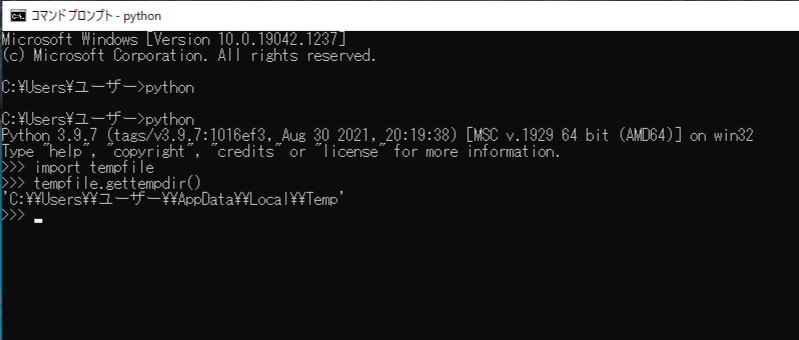

If you know how to use the command line, run the Python interpreter from the command line and then type these two lines:
import tempfile
tempfile.gettempdir()
It should then print the path of some temp directory. Does that work or do you get that error message?

For what it’s worth, I assume it’s the tempfile.mkdtemp() call in the convert_text2paths or Make_PNG function. I assume that call fails for whatever reason.
Since finding the user temp directory did work just fine with Python 3.9.7, running K40 Whisperer with that version of Python might also work. I assume there is some encoding issue with the Python version which is used by the EXE.
