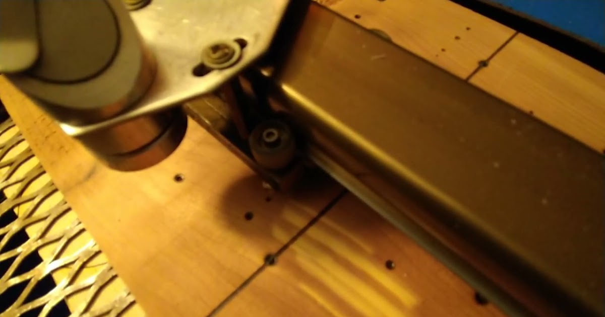

The crackling sound is coming from the burning end at the lens not near the laser tube itself. It makes this crackling sound at lower power settings. Almost like a high pitched soft buzzing. Kind of like a broken speaker makes as the coil rubs past the magnet.
Upon further investigation, the sound is mostly coming from the transformer. I took the cover off the LPS last night after posting the last video. That’s when I discovered the origin of the sound. So, I reinstalled the old LPS and it generated the same sound at low power. It goes away at around 5mA. Since I had it hooked up, I also tested the “IN” voltage and got 4.8 v. I’m guessing I prematurely replaced the LPS. It looks like I didn’t need to do so. I should have asked you guys before I started replacing items, again.
