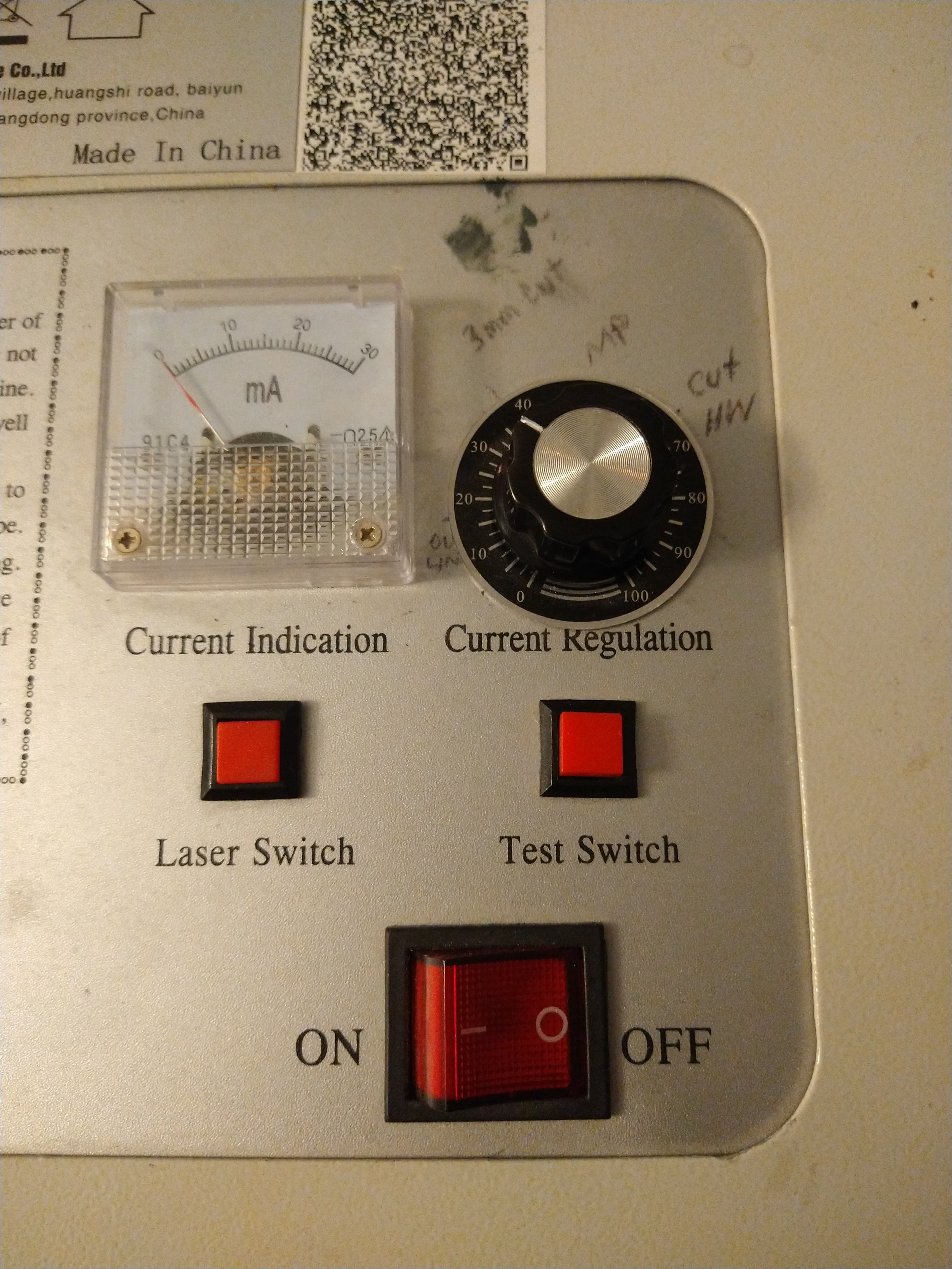

Please post pictures of;
-The control panel both front and back
-The LPS showing the input wiring
How do you know the tube was only drawing 8-10 ma. I. E. How did you measure it?
Sorry, I didn’t actually measure anything to get the 8-10mA reading. That number is based on what the ammeter is saying. Anything above that number and the laser fires but no beam shows up to burn the wood. I checked the mirrors and everything is aligned correctly.
Attached are the requested photos.
Here is another video of the laser firing. I’m adjusting the POT from low to high power.
I haven’t received the new POT so what you are seeing is my current setup.

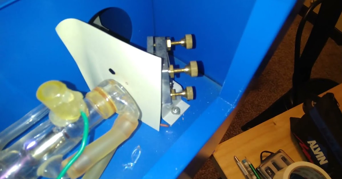

Sorry, the visible burning of the laser seems to stop around 8-10mA according to the ammeter. Anything above that number on the ammeter and the burning stops. When I said the ammeter is pegged, I can get it to peg by turning it up all the way but nothing comes out of the laser. The laser is still firing (tube is lighting up) but nothing burns above 8-10mA. In fact, nothing comes out of the laser itself above those numbers. I put a piece of paper directly in front of the laser tube.
I just got the new POT installed. Nothing changed.
I’m going to post another video. That will probably better explain what’s happening.
Yes! It’s losing power. Or, at least it seems that way.
In the video link you’ll notice at full power, the laser doesn’t burn a hole in the paper directly in front of the laser tube but, at a lower setting it does.
