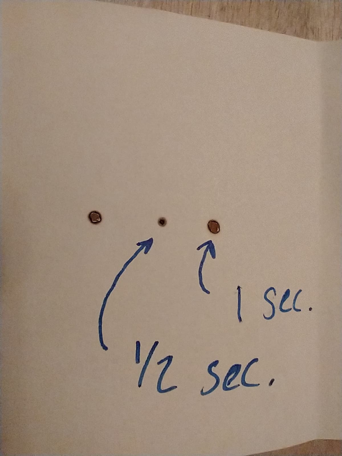

As @mcdanlj we need to see a clean burn on something at the lasers first mirror.
Hold the fire only long enough to make a mark but not burn…

Here is a picture of the test burns. The ammeter said it was about 10mA for each test.

I don’t get any burn above 10mA, that is correct. The laser fires but nothing comes out at the end of the tube. Soooo. Replace the tube?
It’s tempting to go with “its the tube” because the LPS seems to test OK and that is all that is left. Normally in weird unresolved cases I recommend to first replace the LPS then the tube as they are both consumables anyway. In this case the LPS is already new … uggh!
I am unsettled as the symptoms do not correlate with my experience:
  • Laser tubes don’t generally fail this way. They loose power across the full range. In this case the power is dramatically reduced only above 10ma but perhaps ok below. This is a gas discharge device and they usually do not behave like this :thinking: :thinking:
