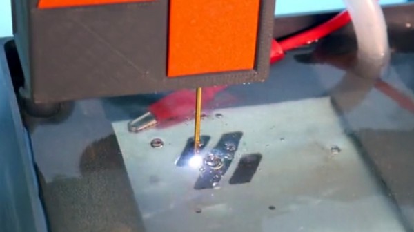

Cooper explains that they’ve prepared a special fork of the LaserWeb4 for use with EDM that will constantly lower the Z height at the proper rate to counteract the electrode itself becoming shorter over time.

I’m guessing they modified lw-comm.server rather than the LaserWeb app itself. That’s what I’d do anyway; it’s easier to add an ever increasing Z offset there than having to play with the gcode generator(s!) in the main webapp.
Wouldn’t you want to add to Z only while actually in contact with the metal being cut?

Part of the ‘cleverness’ of this is that you do not need to modify the Ender’s firmware, they apply the ‘wear rate’ calculation to the gcode instead, which seems pretty sensible to me, beter than requiring a firmware mod.
Yes, I’m imagining starting with mill cut path (that will do Z lift between cuts) coupled to a post processor that adds a z offset continually while doing G1 cuts but not otherwise.
This could be done as part of the path generation itself, but more likely as a post-processing operation, either in LW or in lw-comms.server (which is, imho, easier to implement. The path generators are complex, fragmented and not nice to work with).
