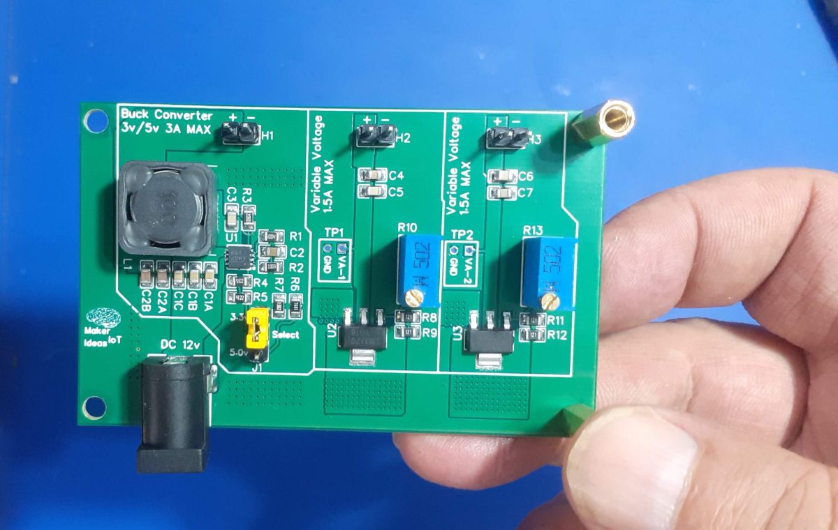

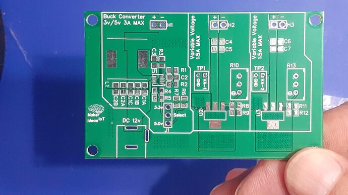

Variable Power Module
What is on the PCB?

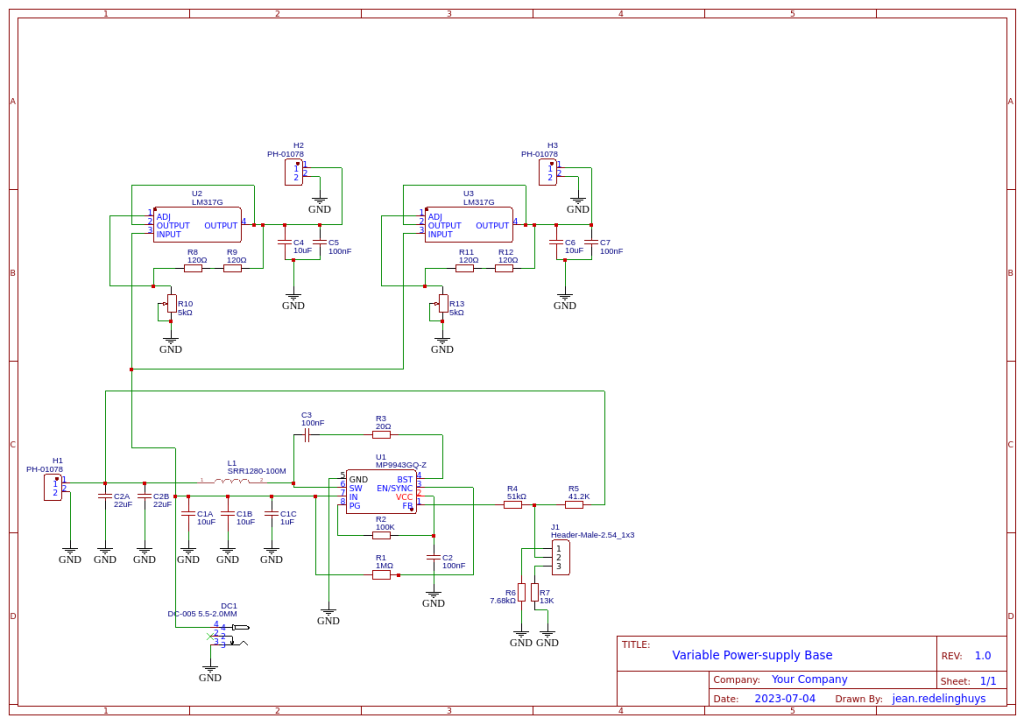

The PCB consists of 3 independent power circuits, the first of which is a DC-to-DC Buck module, based on the MP9943 from MPS. This chip can source up to 3A at a preset voltage. In my case, I chose 3.3v and 5v, as I use those the most.
The second and third parts are a mirrored section, with the humble LM317G at their hearts. These are set up as variable voltage regulators, with their outputs adjustable via R10 and R13. These two can source two independent voltages, from about 1.0v right up to about 11.5v ( if VCC is 12V) at a respectable 1.5A or current.
All of this is powered by a single 12v Power supply. Note that the 12v supply should be capable of sourcing at least 3A of its own…
The stepped-down voltages are provided via 3 2-way headers at the top of the PCB.
How do you use the board?
Using the module is easy. Power it from 12v DC ( or up to 24v if you really want to)
The 3.3v or 5v output is selected using jumper J1 ( Please switch the power off first, BEFORE you change this). The selected voltage will be available at H1
H2 and H3 provide variable voltages, that can be set using R10 for H2 and R13 for H3. Turning the potentiometer anti-clockwise will reduce the voltage, clockwise to increase.
Test points ( TP1 and TP2) can be probed with a multimeter while adjusting the voltages.
The Schematic

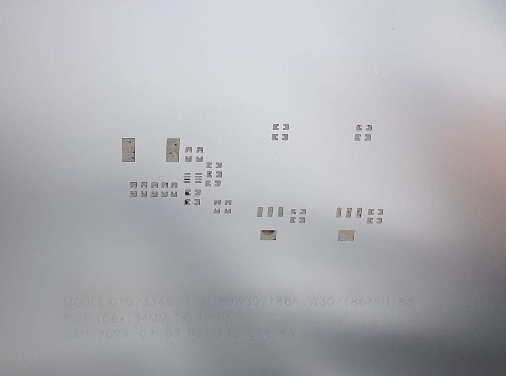

This PCB uses some very tiny components, so a stencil is highly recommended.
The Buck Converter IC is especially tiny.
Most of the other components can be soldered by hand, but I chose to do the entire assembly on a hotplate to reflow everything at the same time.

Nice project! Where did you get the stencil for it from?

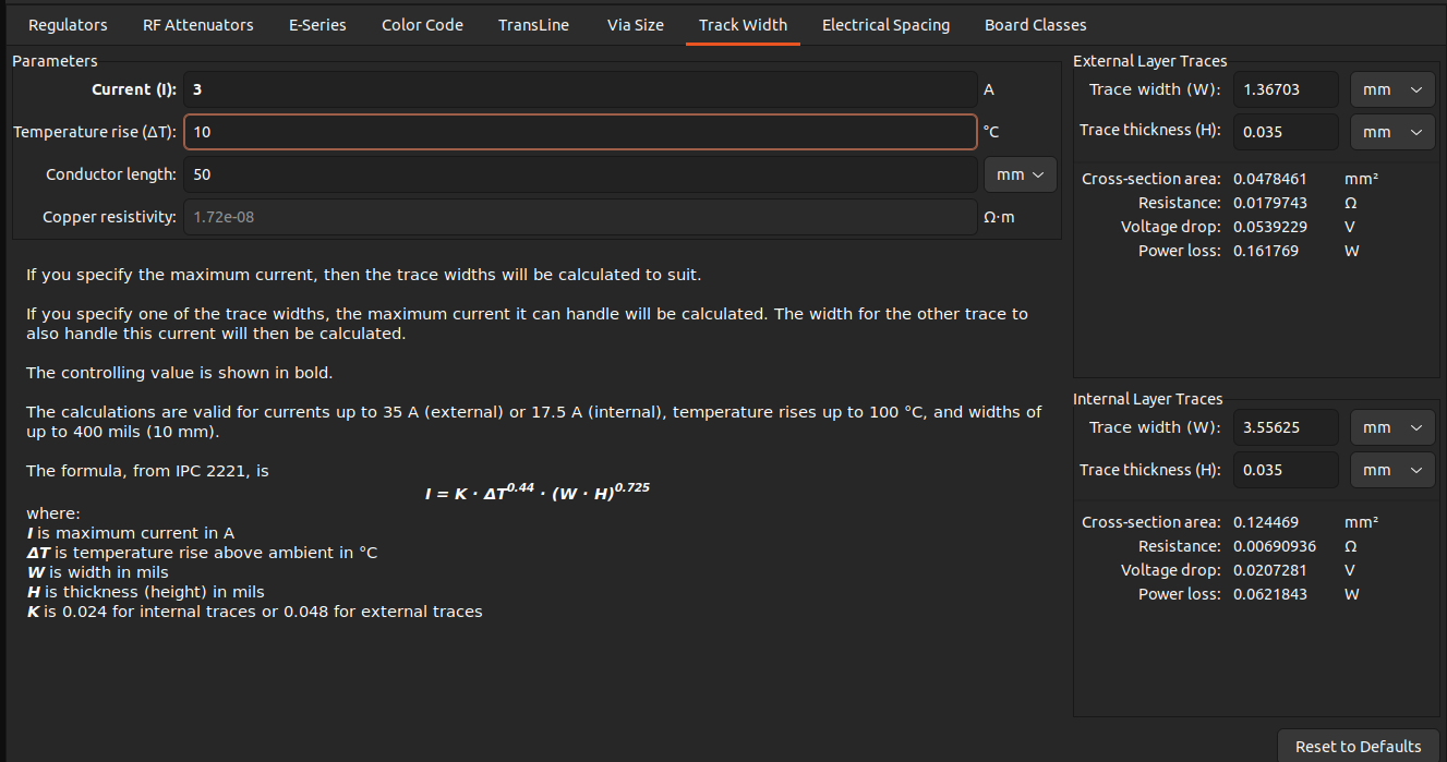

Curious about weight of board (thickness of copper)… I have some 1 Oz copper boards and when I get around 1/2 amp the traces are too wide to be usable…

I had it made up together with the PCB’s , so came from the same PCB manufacturer as the boards

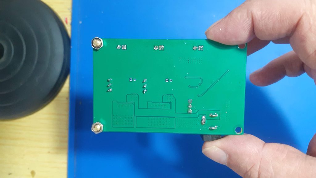

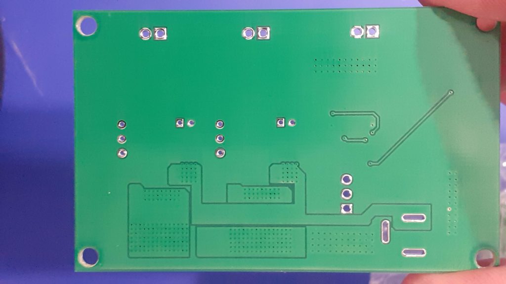

I went with big copper fills where possible, and did some calculations in KiCad… I am however quite unsure if those are actually correct, as the board in it current state does not even get warm when pulling 3A at 3.3v… The LM317G side does heat up to about 30 degrees C when pulling near their rated current of 1.5A but that seems to be only the regulator dissipating excess voltage as heat…
So, to be honest, I am as confused about correct trace widths as you. I reckon that making them as wide as possible, with sometimes double-layer traces, stitched with vias, seems to be working well up to now…
That is a bit of a cowboy attitude, but it seems to have been adequate up to now, with zero burns or issues on any board… I want to enjoy the hobby, and not get too technical and mathematical unless exactly necessary :slight_smile:
Using Eagle, it allows you to compute the width required for a certain current… Just have to have the weight and the current, it does the rest.
I did one for a 4A circuit and the recommended trace was more than I had room for…
So, I was just curious how that worked with yours…
Thanks…
:smile_cat:
Yeah, kicad has the same kind of calculator. It’s based on an industry standard, IPC-2221.

As we see here, My traces are WAY thicker than the recommended ones… so I really dont always know what to trust…

I would rather have too big tracks, that never heats up or burn :slight_smile: I dont think too big (about 8 mm here on the Mosfet outputs) are actually too big…

I do however get WAY better thermal performance ( in this case lower heat production ) with the bigger tracks. Also, the integration of on-pcb heatsinks helps a lot there ( the LM317G in this case is SMT, so a normal heatsink can not be used… I usually solve that with a generous copper pour on both sides of the board, that is then via stitched together for better thermal conductivity) - So far, that one works quite well, and are inexpensive as well :slight_smile:
