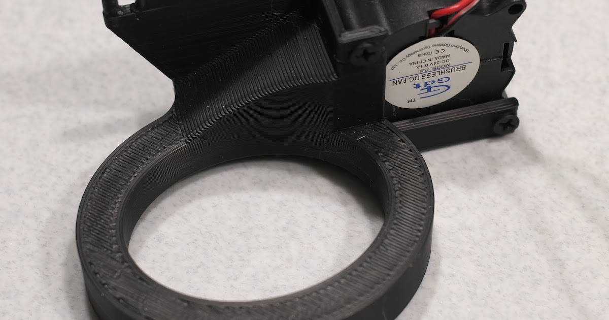

If the fans run faster in the assembly than in free air, they won’t do anything useful for you. (If this doesn’t make sense as a test, have you ever blocked the nozzle of a vacuum cleaner?) Looking at the picture in that ebay listing, it really looks to me like it’s doing nothing for impedance matching. This is similar to part cooling fans on 3D printers, which even with a very short nozzle like this is done with a radial fan.
Read, and watch the videos, in this post:
Those videos and my suggestion that people test their print cooling fans to see if there’s any air actually coming out of them generated so much vitriol and animosity that I decided it was time to delete my reddit account.
The point of the videos is not that I designed a bad duct. The point is that predicting what a compressible fluid like air will do when you try to move it through a duct and out a nozzle is not intuitive. You can design the most aesthetically pleasing duct and nozzle in the world, but ordinary mortals can’t be sure that air is going to come out of it until they actually check it. Checking it is as simple as putting your finger, a flame, a piece of string, or trying to blow a ping pong ball across a table to see if there’s any air flow. Once you’ve established that there is air flow, you can try printing to see if there’s enough air flow and if it’s going in the right direction.
So before even bothering installing this in your laser cutter, I would suggest doing some tests to see if it actually moves air. :smiling_face:

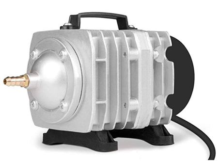

Absolutely, will do. As @mcdanlj says it may not do anything, I’m hoping the two fans focussed through the nozzle will give enough airflow but I realise they’re not really designed to create pressure against resistance, but I haven’t seen this approach tested anywhere so who knows, maybe the maker knows something :smiley: If not I guess I’ll go with a small piston air pump; would this type work? https://www.ebay.co.uk/itm/273556486409?var=572964450839&mkevt=1&mkcid=28&chn=ps It says not to run it with zero load but would a nozzle or narrow output pipe provide enough back pressure? Or is there a different type you’d use?
I would expect that putting a valve in place to regulate air flow, as well as narrow diameter tube, would provide the expected back pressure.
At least I hope so; I am using a larger version of a similar pump for my 100W build! :wink:
