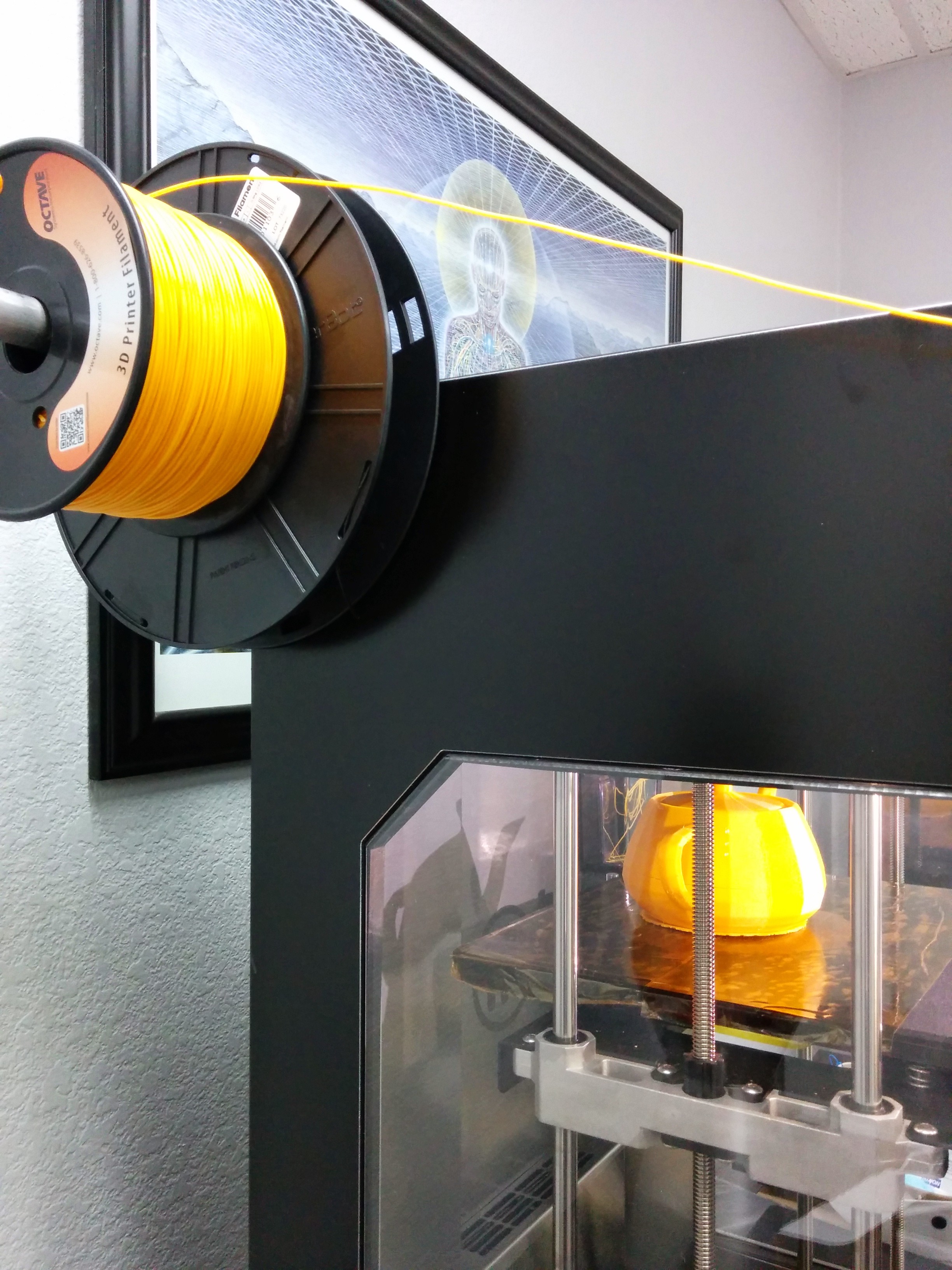

I’m an unfortunate owner of the Makerbot Z18. I was so excited for this printer and pre-ordered it as soon as it was available. I own the Thingomatic, Replicator, and Replicator 2X I thought that this printer would be a great addition to my Makerbot collection. I immediately started having problems with the print quality. Extruder was constantly clicking, filament feed issues, inconstant leveling, surface artifacts, etc… I was not going to pay the extra $$$ for Makercare. Makerbot’s tech support is beyond horrible because they are afraid to admit that there are fundimental design issues with the printer and smart extruder. I ordered a 3 pack of extruders hoping to solve the extruder issue. After having waited for over a month for my replacement extruders to arrive the first extruder was bad right out of the box. Makerbot only warranties the extuders 2 months after ship date, so if you buy a 3 pack test them all because I doubt Makerbot does. The new extruders made no difference. I was almost ready to give up and rework the entire top end of the machine and replace the electronics because I’m not going to buy Maker Care, but before I do that I decided to do some experments printing ABS. ABS is my plastic of choice because of its strength and work-ability with acetone. I took some kapton tape and covered the build platform with it and applied some ABS acetone mixture to it with a paper towel rubbing until the acetone is evaporated. I mounted a roll of Octave ABS filament so that it feeds into the top feed. I set the extruder temp to 225C and chamber to 48C. I turned off the PLA cooling fan. There is a bug in the Makerbot firmware that causes a timeout when waiting for the chamber to get to temp. (Error 1001: Toolhead not heating), so you might have to restart a few times until the chamber gets to temp. I’ve attached some photos from my experiments. The printer took 13 hours to print the teapot (3 shell 10% fill). I was pleasantly surprised this morning to see the teapot had printed without major issues. The surface quality is better then anything else I have ever printed on this printer. I really think that Stratasys had Makerbot intentionally neuter this machine’s capability. The Kapton tape does not stick to well to the build platform tape, I’m going to try to add a sheet of aluminium or stainless to the build platform and see how well that works.
