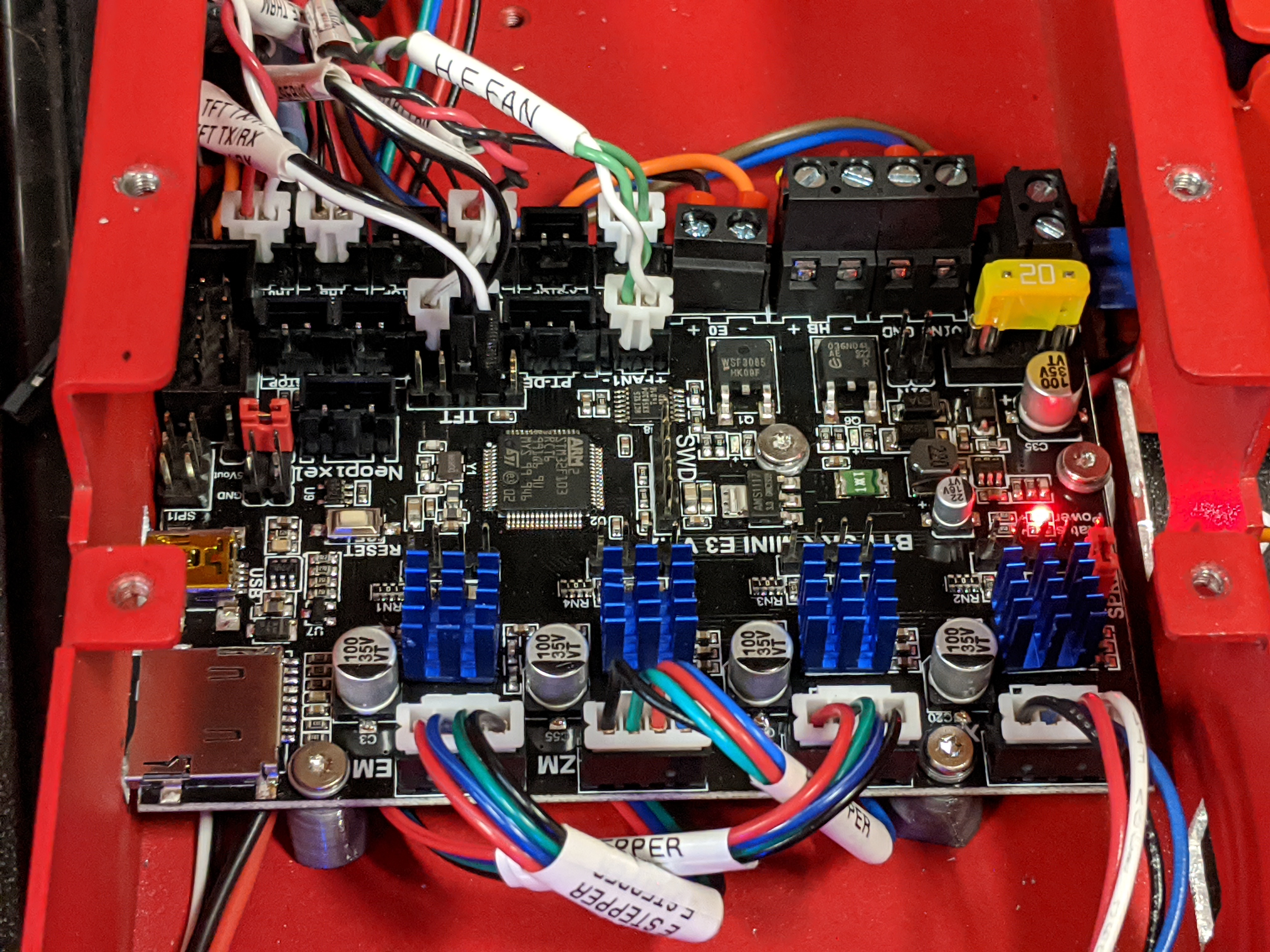

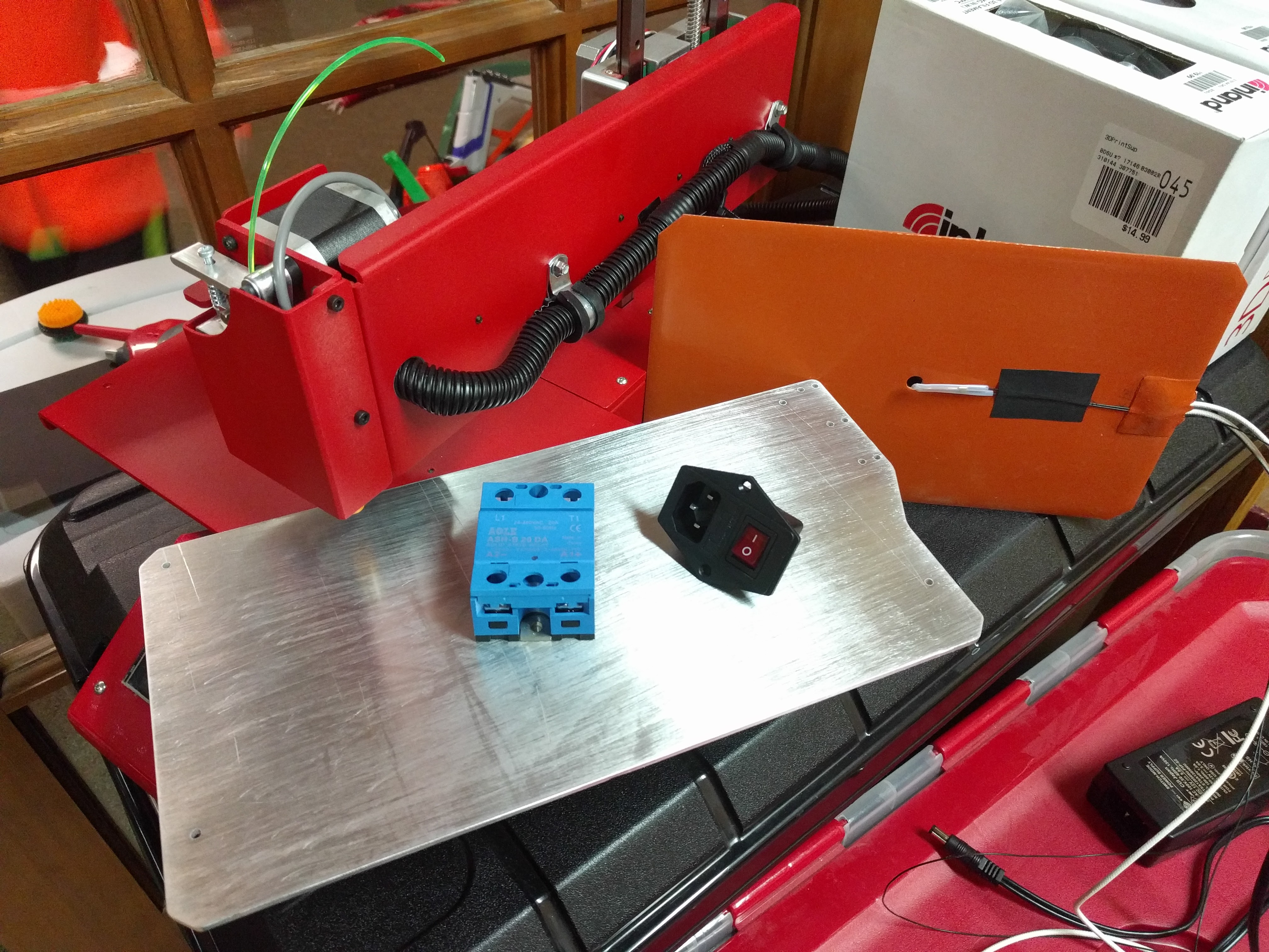

I went with the v1.2 back in the day on a printer I modified for a local robotics club. It was one of the adoptabot printrbot pro hardware kits he donated. The printrboard died, so the skr mini was a good candidate. It took modifications to fit. But has been running great for them. I also put an lcd screen on it for them as well and converted the bed to 120V for fast heatup. SSR for mains bed required a metal sidecar be added to the printer.

Mine was a frame only from Brook Drumm at the end of Printrbot. So it didn’t have any of the wiring. I ran all my wiring in a split loom.

Not easy since it’s really not the correct size for the space. With lots of cutting and a sidecar box it was doable. But not for the faint of heart :slight_smile:
