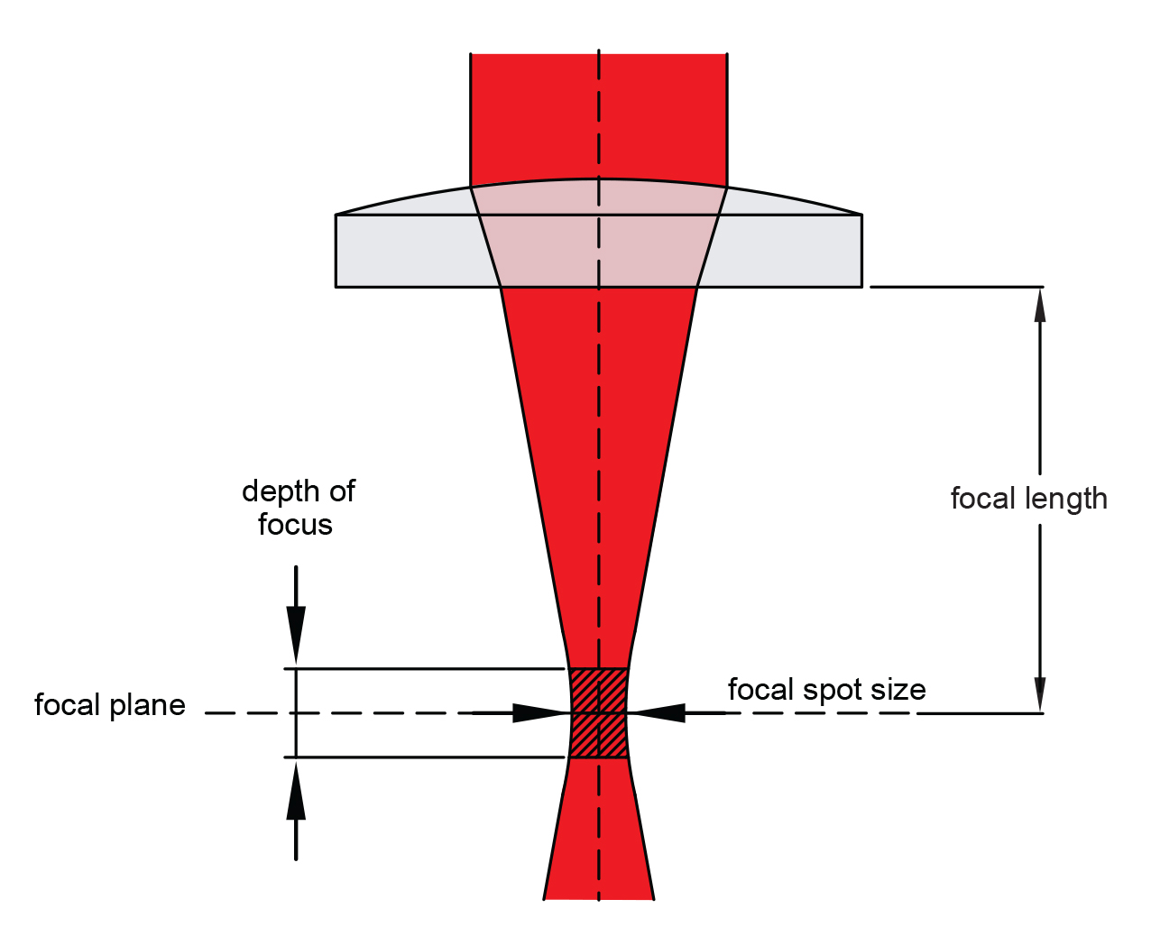

While the depth of focus increases with longer focal lengths, so does the spot size (and thus minimum kerf). This means that the power per unit of area is lower, so you need higher power to cut with a longer focal length, though you get a straighter wall on your cut. @NedMan just posted this:
