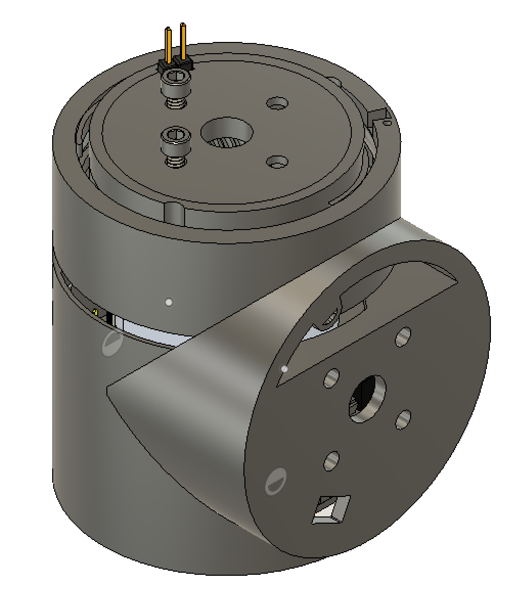

Progress of actuator design
The goal of this actuator is to create an open source 3D printable robot arm actuator with an open source PCB and open source software for an ESP32 to control the actuator. The actuator just needs 20V fed in through the slip rings so there are no wires. Communication across the actuators happens over wifi or Bluetooth so the signalling is wireless. Making progress, but still have a long way to go.
Outside of actuator
From bottom to see touch sensor on end
With outer shell removed
With touch sensor removed
With fan removed
With stepper motor driver removed
With DC to DC converter removed
With stepper motor and actuator removed
Better view of ESP32 underneath main PCB

Yeah, it’s been some work, but not too bad. There are a lot of new ideas being worked on this actuator that I’ve not seen out there on the interwebs like the ESP32 driving it, or the Wifi, or the slip rings, or the touch sensors. The key as well is the 3D printable planetary gear. I think all of these combined could be a really great step forward. Just theory until it works though.

Latest version of my actuator. Took the anti-backlash small actuator design and tweaked it a lot. Tweaked the shell design a lot making it as wide as the anti-backlash case. Designed some custom PCBs. The coolest thing, I think, is the touch dial on the end. The next coolest is the slip ring to carry the 20v across actuators without wires. There’s a heatsink around the motor now, a 25mm fan PWM controlled from TMP36 temp sensor, and code to increase fan speed as motor heats up. From tests I can keep everything below 36 deg C permanently now. And you can train Gcode to the flash RAM of the ESP32 for later playback via the touch dial.
I’ll make a full Youtube video soon of the whole darn thing, but it’s rad.

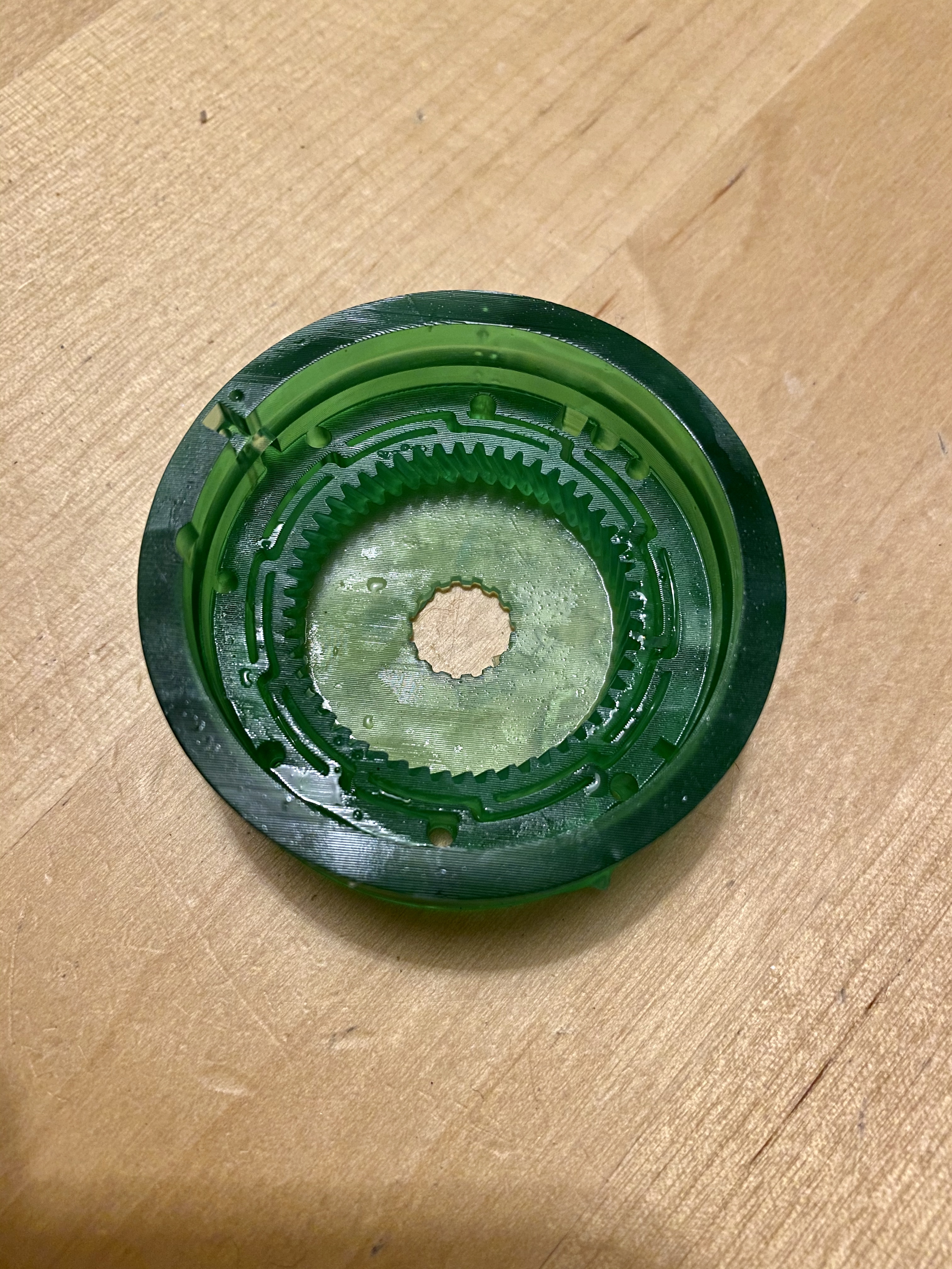

Looks like there is just enough space to print it on my resin printer.

I would love to see how this comes out on a resin printer. I don’t have one, but I’m curious how functional you’ll find the parts with the light cured resins.

I’ll let you know how I get on with the prints, I can use my fdm printer as a backup if it doesn’t work out in resin. I ordered a modified version of the pcbs tonight from jlcpcb (changed the resistors to 0603 and put them all on the same side to aid with hotplate assembly)

Fresh out the ultrasonic cleaner.
0.05mm layer height, 15 degree print angle, anycubic green resin, sparkmaker Fhd printer
Wow! That is awesome seeing that done via resin. Now, I wonder how the mechanical nature of that flex spine will work out with the resin since PLA is nicely flexible.
It will flex when pushed with a finger, i’ve done one in pla on my FDM printer as well, just to compare. Just need the remaining bits to arrive from aliexpress, then I can get the gears in and try it out :smiley:
