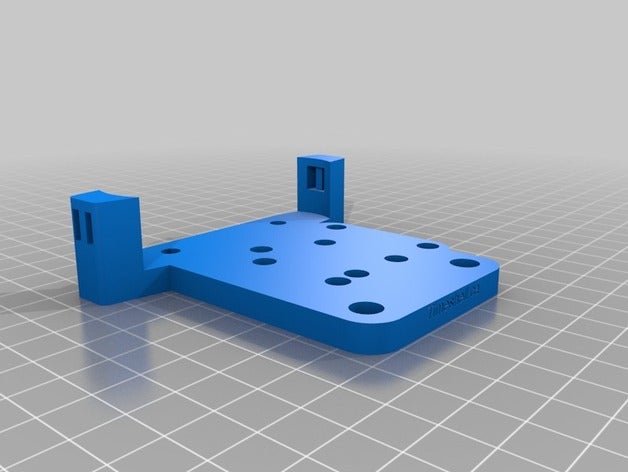

Prototype for 2040 rail carriage for the TEVO Tarantula to mount Toranado geared extruder/E3D
Prototype for 2040 rail carriage for the TEVO Tarantula to mount Toranado geared extruder/E3D V6 mount is complete!

close @Greg_Nutt this will work for the Tevo tarantula on the horizontal mount (stock style) but I was looking for the vertical carriage just like the one for the cobblebot to hang it from the front, kinda like a prusa I3 x carriage sits.

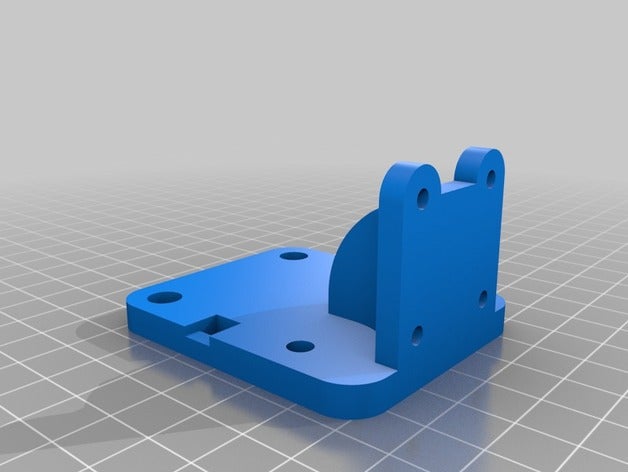

My modified Cobblebot is the same way. The open rails are a great thing to build on when done right. I can push over 200mm/s and still get a very accurate print. @_KaT_KaTZWorld I can probably create a completely vertical version as well but I do have concern about the 40mm height. I have found that the 20mm can already create some bending in the printed carriage and I’m a little concerned that 40mm vertical may end up being very loose.
I can see how that can be a factor flexing … I would reinforced it with a flat plate to put different addons to it, mostly need it to make swaps easier
I could make it thicker too I suppose. I’ll see what I can do.
@_KaT_KaTZWorld Are you looking for the belt to be on top or underneath like the Cobblebot?
just like the cobblebot one you made just with a 40mm front instead of 20mm
I don’t have a 2040 rail to test this on, but the length has been increased by exactly 20mm so hopefully it will work. I have also made it 2mm thicker to help reduce warping.
Except there is an error in the hole postion… that will be fixed shortly.
Fixed.
looking good … if you add the 4th hole in on the carriage its a perfect prusa i3 rework and a win for everyone … once you get the holes moved on this last one I will print it and give you an update
LOL… why didn’t you say that before!?
I’ll get right to work on it.
Holes already moved BTW.
@Greg_Nutt just noticed it would work when I was measuring the holes on the carriage vs other prusa style attachments
Will update the thingiverse item with 4 hole variation momentarily.
