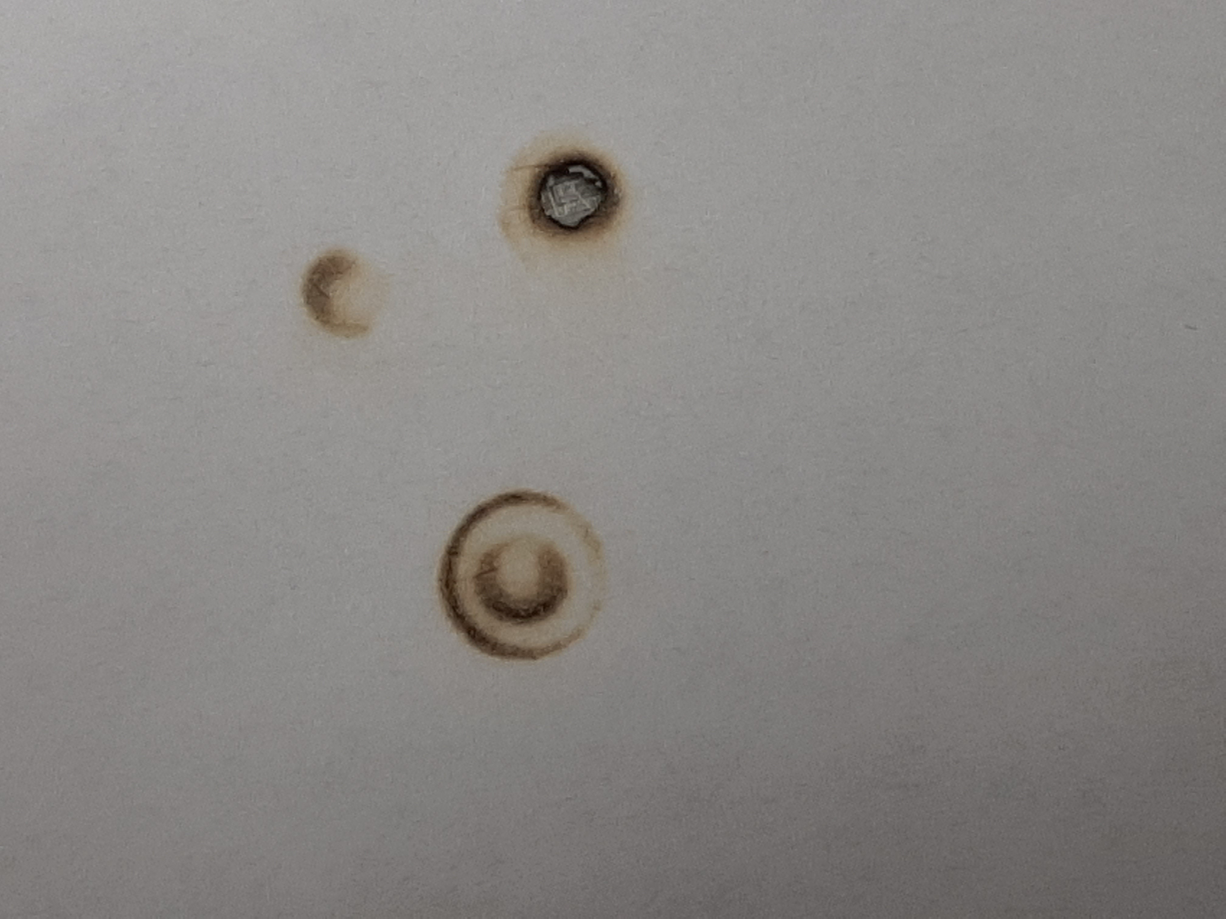

Here’s a few things I did before I remembered to test the output of the tube. It’s heartbreaking to have to wait for a resolution when I had so much fun with it just yesterday.

Not that it matters to you at all, but just for anyone searching the site for example images of degraded TEM, I think that’s TEM10.
From Transverse mode - Wikipedia
Well dang. I didn’t read it before buying :confused: Isn’t white on the TEM picture representing the presence of light and black the lack of it (TEM00 being the good one pictured with a white dot). Tbh the two donuts confused me a bit but since TEM01 has no light in the center it felt more like what I see. Anyways…

It was my interpretation of the burn marks that they looked more like TEM10 than TEM01* because it looked like there was burn in the center. In any case, it doesn’t matter very much since any mode other than TEM00 has reduced performance at best…

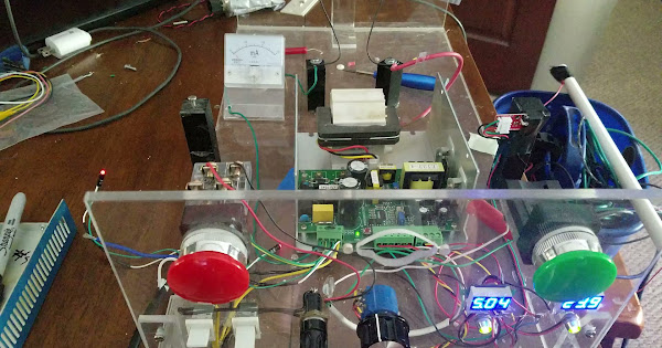

I do not get near the HV end of the LPS unless the supply is installed in my testing jig… one which has HV safety features.
