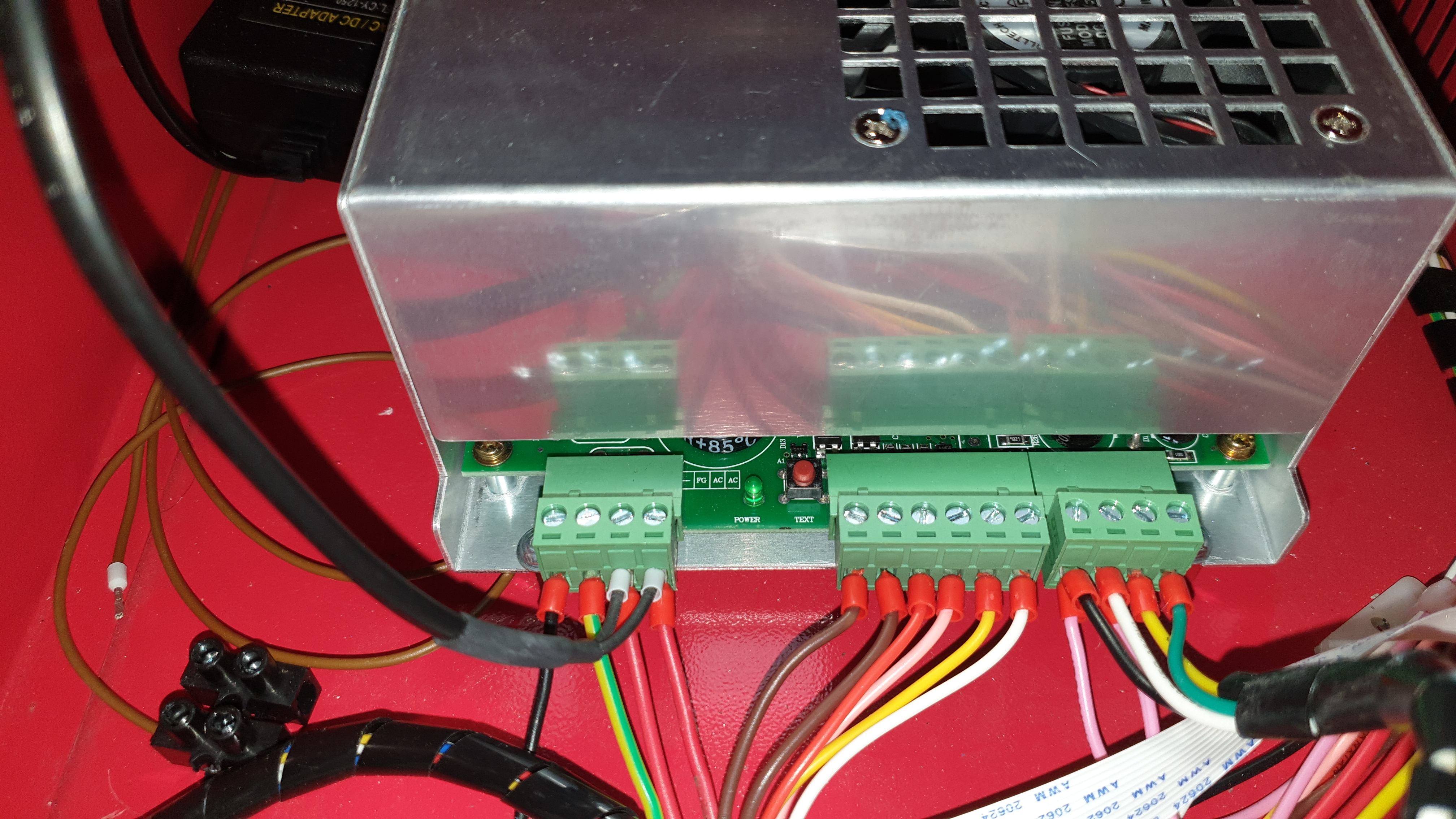

Please, post a picture of your supply taken from the connector end.

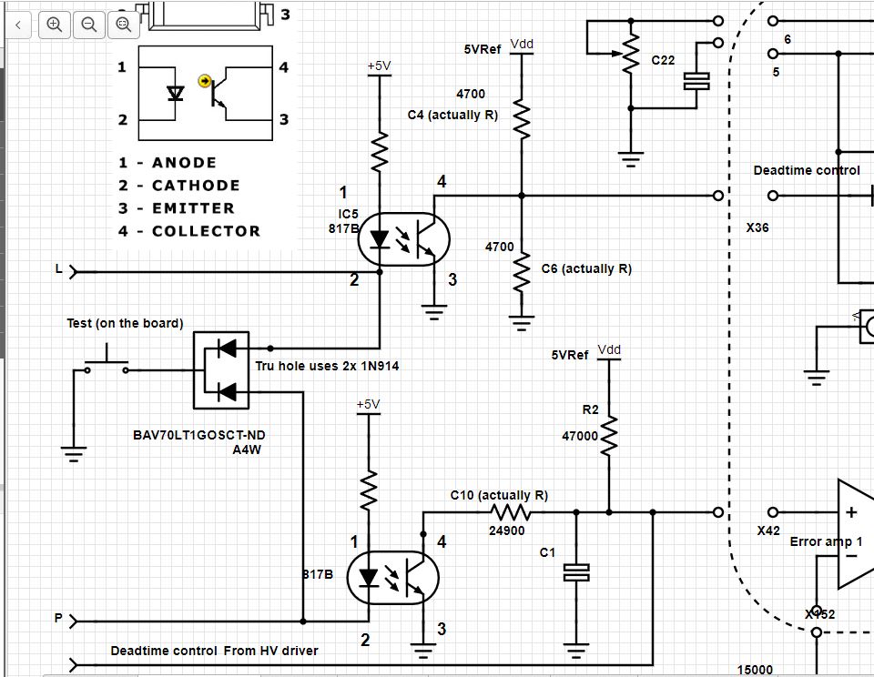

Hopefully, I am not jumping to conclusions, this is quick guess:
There is a diode array* that allows the LPS test button [down on the supply] to override the LPS enable schema by asserting both L & P at the same time.
This diode array can short and if it does when you assert L, P is also asserted.
In fact, I just finished helping another with this exact problem with similar symptoms.
You can test this by disconnecting the digital control connector on the supply [the P and L connector depends on what kind of supply you have] and measure with a DVM:
  • With the power on; ground L and see if P goes to ground, it shouldn’t
  • With the power on; ground P and see if L goes to ground, it shouldn’t.
*the diode array can be implemented with 2 discrete 914’s or an A4W smt.
Alternately you could have a short in the connector or on the back of the board between P & L

Thanks for the fast reply.
This is the PSU.
Your guess seems legit. I disconnected the wires from P and L. Measured the voltage against ground and got 4.3V for P and 4.7V for L. Vcc is 5.08V.
I then grounded P and measured L. Got 4.7V. Like expected.
I then grounded L and measured P. Got 2.1V. This is not what should happen. Seems that the diode is a little too conductive in the reverse direction.
Do you agree?
For the moment I would just unsolder D13 and wait until I get a BAV70. The test switch on the PCB is useless anyway.
Yes it looks like a bad diode.
Remove it and see if that fixes it.
The PB on the LPS is useful for troubleshooting as it bypasses all the fire enabling functions outside of the the supply and verifies that firing problems are not in the supply.
