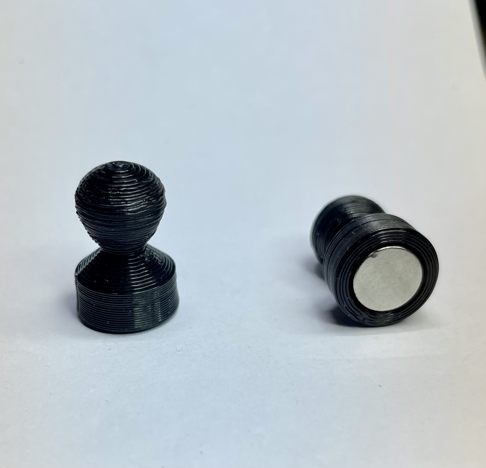

I’ve got a number of small cylinder magnets around the work area for holding different pieces of paper or what have you. Decided a wanted an easy way to pick up some of these. Designed some small holders for some 3x8mm Nd magnets. Printed in PLA.
I designed them to have the magnets to be press fit tight. Which worked great when I printed one, but when I went to print 12 at a time the magnets no longer fit. :grimacing: Probably due to some shrinkage as each one cooled between layers? :man_shrugging:
This was better for the round upper part but not so much for my magnet fit. I used a micro torch to slightly heat the cavities and pressed the magnets in. Had to use some CA glue on some, but they work great

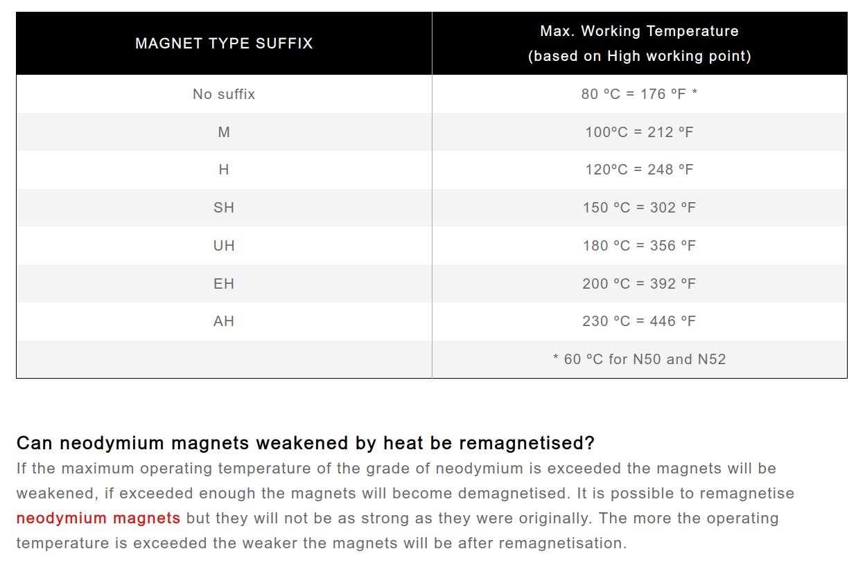

It’s not red hot for neodymium magnets. You have to buy high-temperature variants even to make them safe to 130°C for use for heated magnetic 3D print beds. Apparently that’s operating temperature, and their Curie point (permanently completely demagnetized) is around 300-400°C, but they are permanently partially demagnetized above their working temperature.
Here’s a random reference:
On the other end of the spectrum, some AlNiCo magnets have a Curie temperature of 900°C — which blows my mind.
