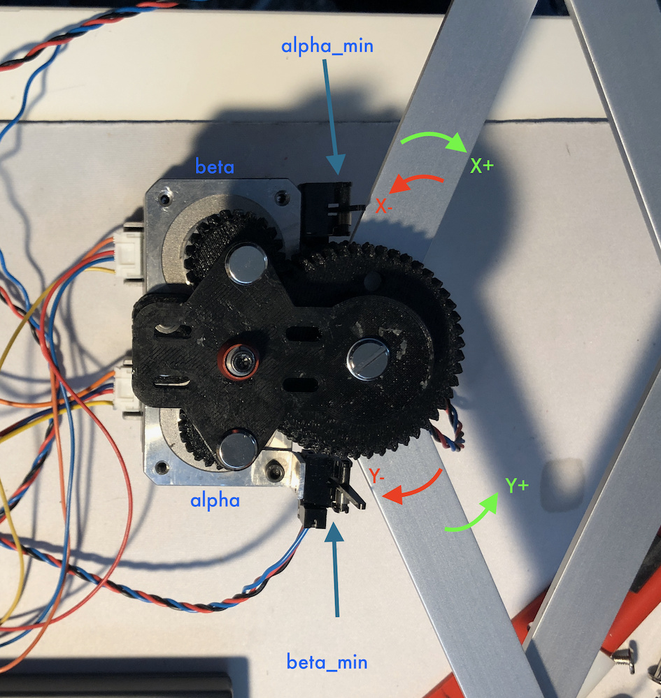

Here’s what the bot looks like with the motors and homing switches labeled, as well as some indications of how the arms should move when given various commands.
If it’s not obvious in the photo, the beta_min switch is on the opposite side of the beta motor because of how the arms are driven. A simple way of thinking about it is that when beta moves it drives the “Y” arm which uses the beta_min switch. Same is true for the alpha motor and switch, except it drives the “X” arm.
I’ll also include the end stop settings from my config, but it’s worth mentioning that the I’ve set the config so that when I send G0 X1, the arm in the top part of the photo moves clockwise (assuming my original position was X0. If X is at 10, and I send G0 X5 the arm moves counter-clockwise. Same goes for Y positions.

When I send G28, the X arm rotates clockwise, and the Y arm rotates counter-clockwise.
These are the exact opposite of what I would expect.
If I don’t send G28, and instead send something like G0 X5, the X arm rotates clockwise as expected (since X is increasing). G0 Y5 does the right thing as well (rotating counter-clockwise), since Y is increasing.
It seems then that G28 is trying to increase X and Y from 0 when trying to find the alpha_min and beta_min switches.
It’s almost as if it’s using home_to_max instead home_to_min. Except if I switch the home_to_max for both switches, it doesn’t change the behavior at all.
The only thing I can think of is that using the morgan arm solution is changing the behavior in ways I don’t understand.
