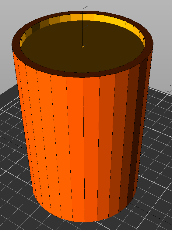

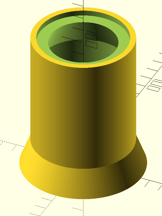

RapCAD doesn’t seem to honor $fn which I used for angular resolution a lot. Also maybe it isn’t as… flexible about the idea of a cylinder as OpenSCAD is?
I grabbed a random OpenSCAD file I’d used recently to test with RapCAD.
od=72;
id=64;
cd=48;
bcd=od+15;
cone_h=20;
height=100;
h_lip=4;
$fn=180;
difference() {
    union() {
        cylinder(d=od, h=height+h_lip);
        cylinder(d1=bcd, d2=od, h=cone_h);
    translate([0, 0, height]) cylinder(d=id, h=5.1);
    translate([0, 0, height-cone_h]) cylinder(d1=id, d2=cd, h=cone_h+0.01);
    translate([0, 0, -0.01]) cylinder(d=id, h=height-cone_h+0.02);
In OpenSCAD, it looks like this:
In RapCAD, it looks like this:
It does, it’s just that the special variables don’t have parent scope, so you just have to pass it into each module cylinder(d=od, h=height+h_lip,$fn=$fn); That is a bug, but it’s never been much of a problem, because often that’s how I find people use it in OpenSCAD anyway. I should fix it though.
A better variable to use is $fe, this works out an $fn that gives an error within the tolerance of the resolution of your 3d printer so for example, I use $fe=0.01 for my prusa mk2, which gives nice results.
There is a prism module which takes a sides parameter, which is my preferred way for creating n sided prisms instead of overloading cylinder.
cylinder(d1=id, d2=cd…
That’s an oversight, when I implemented cylinder OpenSCAD didn’t have diameter parameter support at all. I implemented a d parameter, but not d1 and d2. That said r1 and r2 for cylinder do work.
