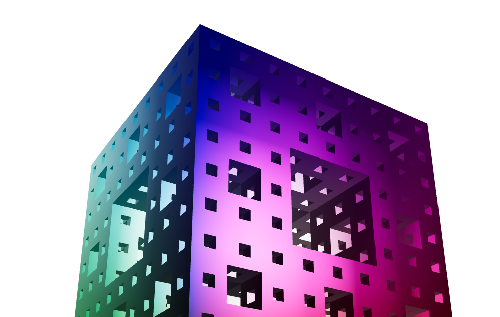

Talking about being able to support multiple languages reminded me of Emmett Lalish writing models with his new Manifold kernel directly in C++. Have you seen it?

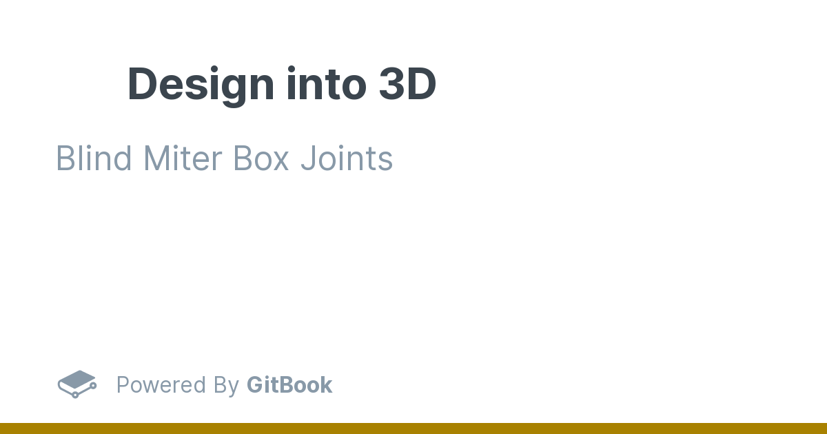

The benefits are:
  • programmability — tedious tasks can be automated
  • customizability — a design can be provided to non-programmers who can then get a customized result by just tweaking some numbers/settings
  • use of non-standard tools such as cove/roundover bits
  • 1:1 mapping of machine capability to design — the result of any movement which the machine can make can be used to express the design — it’s not possible to create a design which isn’t machinable
You can see some of the designs which I’ve been working toward at:
and the balance of that site.
No, I had not seen it, but it just puzzles me that folks just don’t break down and do all this math as integers, avoiding the need to round at all.
Laudable goal though, and interesting project — in particular, the solution for avoiding the need to pad dimensions so as to avoid infinitely thin geometry is elegant (in the original sense of scientifically correct).
I would love to see it made the back-end of some opensource CAD/3D programming/modeling tool — if I read the GitHub page correctly there’s a Python library?

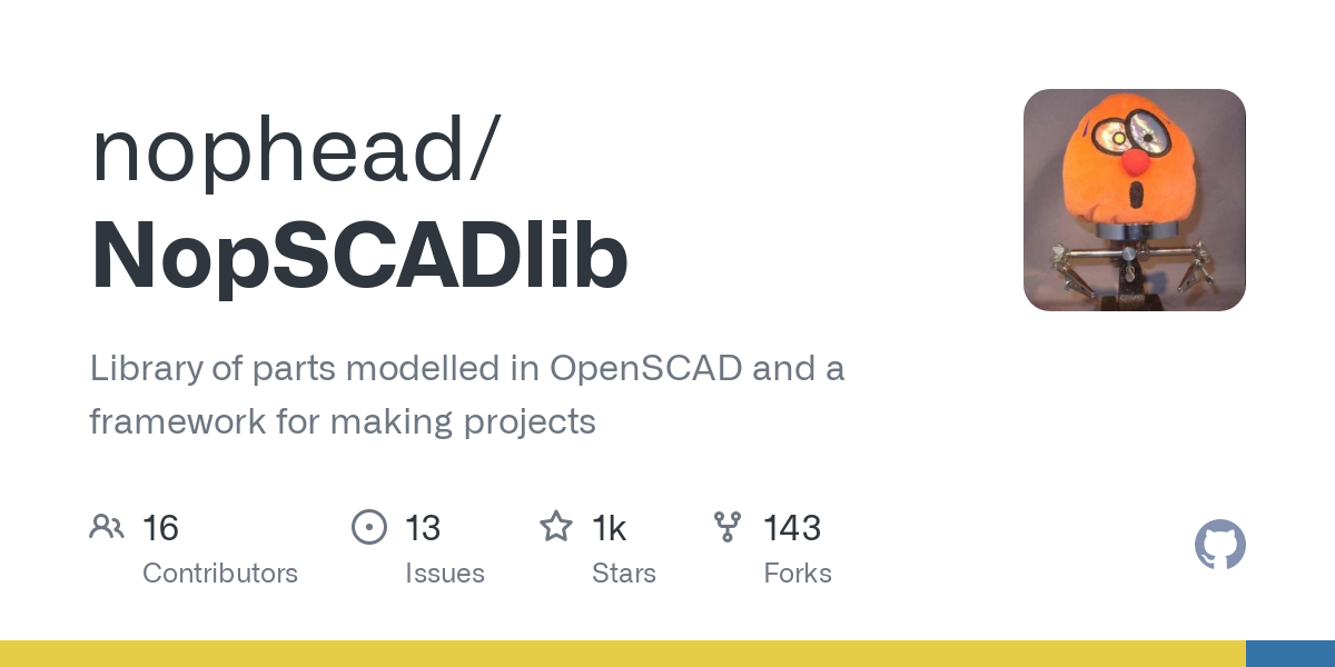

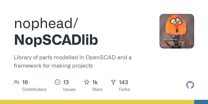

This is one of the things confusing me. I thought @Giles intentionally implemented a similar but not identical language, since changing the language was one of the driving reasons for starting the project in the first place. How much of that universe doesn’t care about the difference? For example, how well does it cope with @nophead’s amazing library?

I always intended RapCAD to be a superset of the OpenSCAD language, but I haven’t been able to avoid divergence since both languages are evolving. A lot of NopHead’s library should work. But when I tested it I think it currently doesn’t because of the way he has structured the project with respect to the usage of include and import, to workaround openscad bugs.
