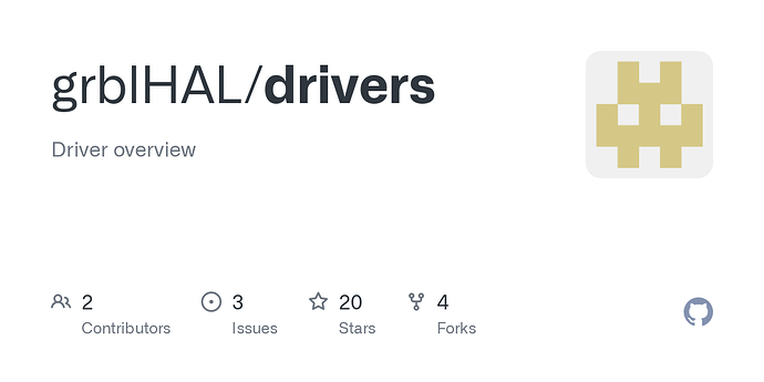

If it is not supported, then see grblHAL:
Re-ARM is included in the supporte boards for grblHAL, as are the SKR 1.3 and 1.4:
Thanks a lot, this gdblHAL seems what I’m looking for. I’m going to investigate it.
