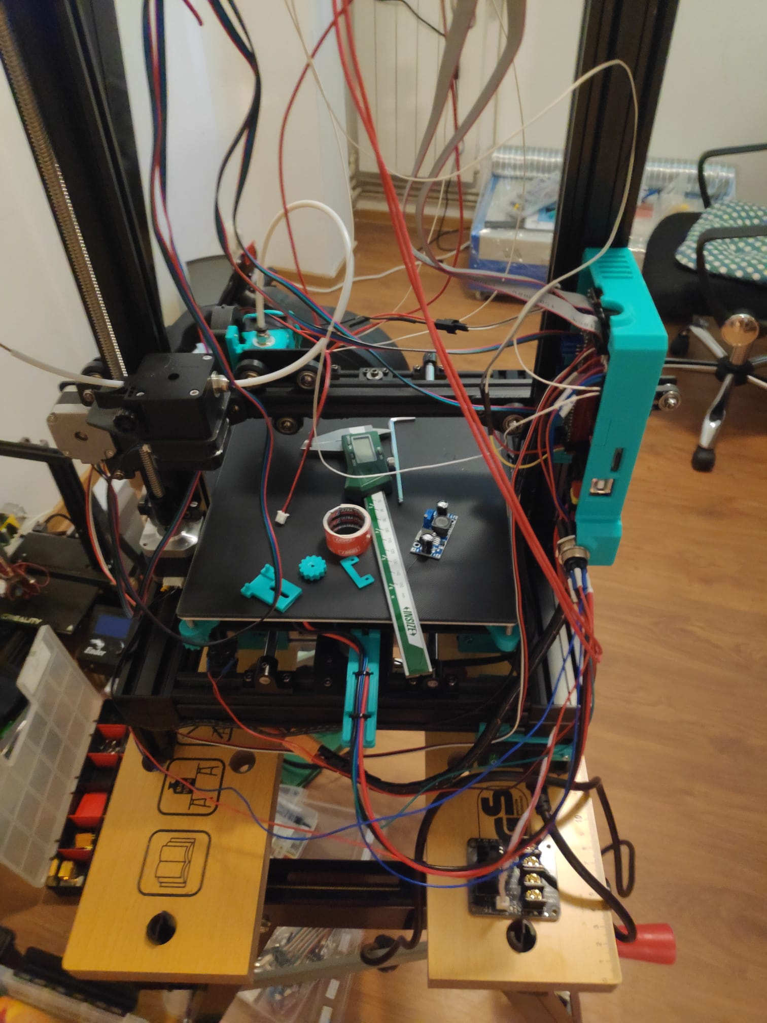

Hello everybody,
One of my colleagues and a friend bought some bulk Anycubics Mega Zero v1.0 refurbished from AliExpress, the version without the heatbed. He sold them price pretty fast excepting one that he stripped down of steppers, mobo, psu, almost everything. He accidentally broke the screen and he found himself in the end with a pile of pieces that he wanted to get rid of.
Lucky for me i was able to buy that pile of pieces for a modic sum <45euro /50$: so practically at the end of September i had:
-skeleton/chasis of the printer (2020, 4020, 4040 profiles)
-nuts, blots and v-rolls (almost all of them)
-a generic broken screen
-1 Nema stepper. and 3 endstop switcher of which 1 i broke due to a short
-a warped and melted bed, because he toyed with it and he planted the heatbed in it for couple of times)
-some cables and 2 fans (1 radial, used as partcooler and 1 axial used as mobo cooler)
-the hotend with some teflon tube and a clogged nozzle)
Now almost 1 month later, Iam still working on it and I was wondering if you will be interested and give some oppinion on my job?
The main steps taken into account:
  • bought many new, cheepish parts
  • added a new carraige - the old one was hard to adapt and was bent to a V6 Hotend
  • added a heatbed
  • better, silent fans
  • a new enclosure for the motherboard, with aviation connectors
  • a titan clone extruder
  • a MeanWell 24v PSU
  • overall tinkering with pieces and understanding the Marlin SW
    Next steps:
  • working on a cheap ABL solution, even if the Glass bed limits the options.
  • cable management, now it is a mess.
  • still working on a mounting solution for the hotbed MOSFET and the 24v-12v stepdown module
Waiting for your feedback, I feel I learned so many things in the last weeks it would be sad not to share the process.
