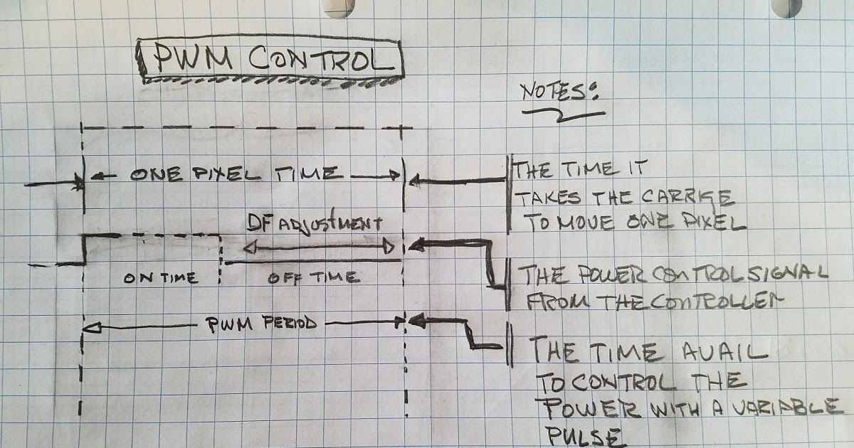

I did a lot of work on this early on and walked away unconvinced that the laser has anywhere near the response that folks think or need for the resolution they think they are engraving at… never found any evidence of what the real laser response time is.
My conclusion for engraving was, slow way down and get to the smallest spot size possible. Alternately just use dithering. Since that time spot size reduction and better optics has shown good results.
There are a couple of references where PPI systems have been built with quite a bit of complexity.
There is plenty of evidence that holding the tube pre-ionized can improve response time, however I have not seen any clear response results. There is also a debate as to whether driving a tube this way shortens its life.
I don’t do much engraving so I never went into more depth. Not surprising to me, I have seen lots of tweaking to get to acceptable images, then there are other users and machines that just seem to work like magic :)!

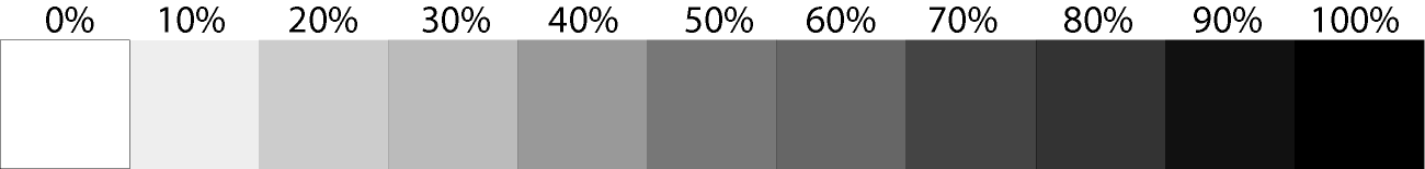

Mmmm I dont know where those images are. However there ARE many files out there for grey shade testing.
They may be these:
Calibration 5%.BMP (746.6 KB) Calibration 10%.BMP (98.8 KB)
