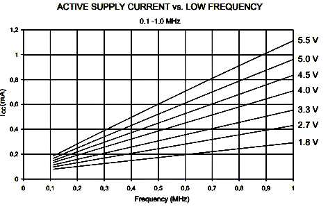

I didn’t even think about something that. I haven’t done a ton of coding, but I’ve done enough that this would be within my wheelhouse. I wonder what the power draw is on something like an attiny while its dormant.
Note: Even an LED will drain the battery faster than the ATtiny85 (in sleep mode) - its capable of extremely low sleep current - less than 0.5uA
You can see that if the processor only sleeps then current draw is extremely low 414nA (but its not doing anything!). It is obviously the best mode for saving battery power and getting the best ATtiny ultra low power operation.
Lots of information in there for reducing current requirements. :smiling_face:
That’s incredibly low. And the ATtiny would save a lot of room compared to the timer I was thinking about.

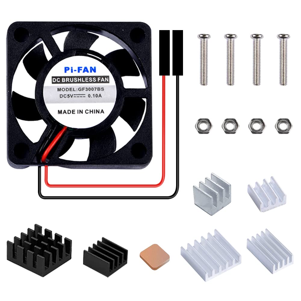

Any recommendations for a low power fan?
I have used these small fans before
Or something like this which can handle 5V and has 50% less power usage( 0.10A vs 0.20A ).
You can search for the fan size you’re interested in and look at the power requirements as most all of the specify the input voltage(or range) and current draw( some you can see on the label ).
