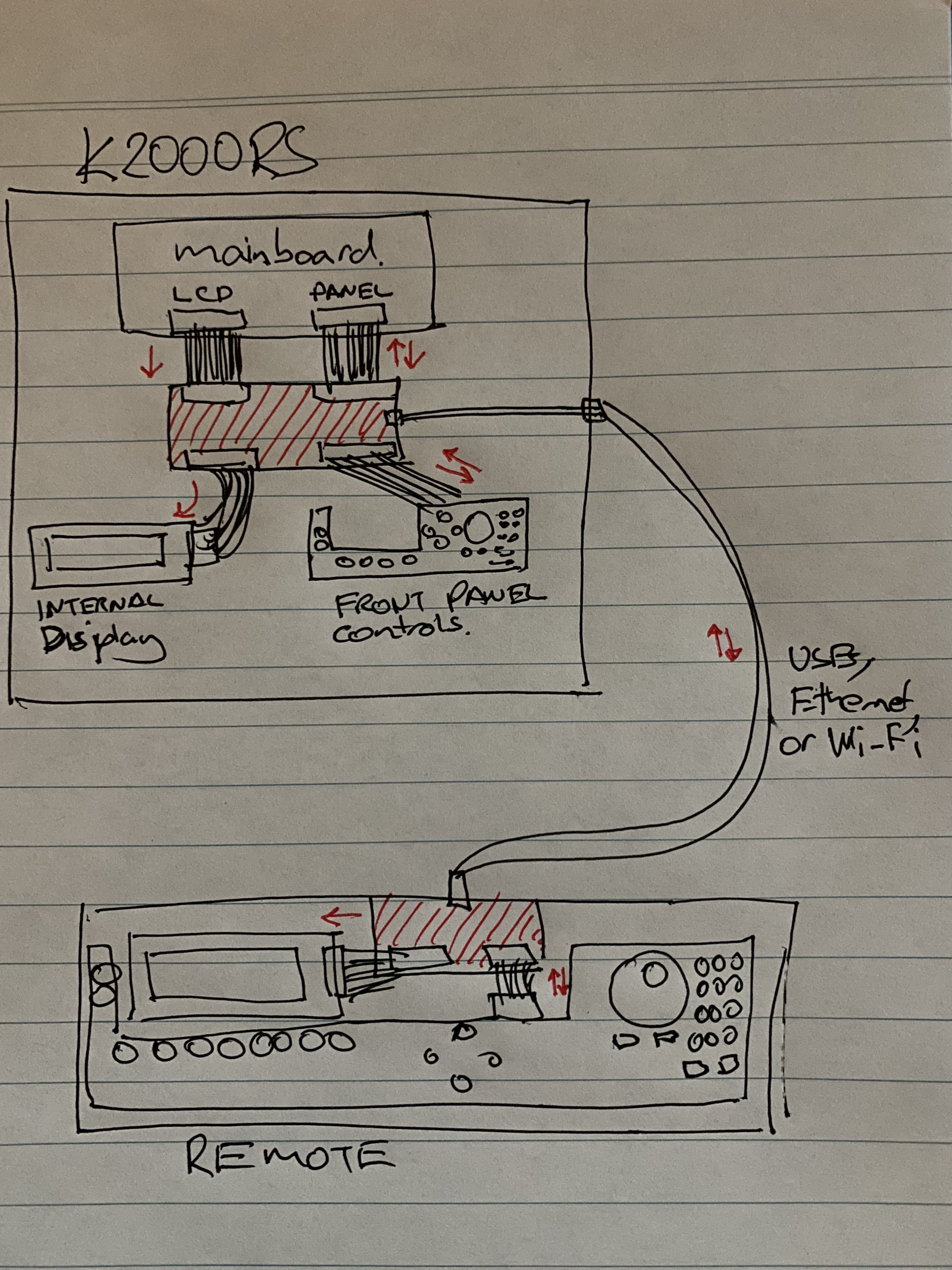

Below is my back-of-the-napkin “design”:
So my question is how feasible is this?

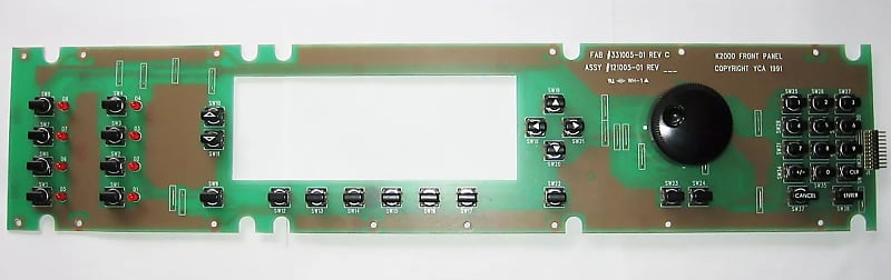

Keyboard version of the panel board:

I’ll record some random thoughts here. They aren’t complete, but it’s maybe helpful for getting started thinking this through…
Chances are good that something that age is using 5V TTL signaling, which is what the 8 bit Arduinos use. You’d need to work out the purpose of each of the 20 wires in the two (?) ribbon cables. The connector to the display may be sufficiently standard that you can find this out from published documents like application notes for that display; with a 20-pin cable it’s probably a typical parallel connection. (If you can’t find documentation, you’d be ending up buying and learning how to use a logic analyzer.) To remote the display you would either have to “sniff” the data fast enough to not lose any data, or implement a logical interposer where the arduino basically pretends to be the display and then forwards the commands to both displays. I don’t know which would be best but my gut feeling is that I’d look first at the logical interposer as more likely to be reliable.
You might end up needing a high-pin-count Arduino like a the Arduino Mega 2560, which has 70 general-purpose IO (GPIO) pins, at least for the board inside the synth.
USB would be hard because one side has to be host; USB is directional and it’s trickier than you might think. Both WiFi and wired ethernet are hard because you need a whole network stack. All three tend to be easier on more capable 32-bit devices, but those are mostly 3.3V and often not even tolerant of 5V signalling. Easiest would be to use ethernet cable but run CAN BUS over those wires; it’s reliable (it’s used for safety-critical signalling in cars) and takes only two wires, and at short distances can run fast enough for your purposes. This would leave the rest of the ethernet wires for delivering power.
Speaking of power, don’t assume that the power supply in the synthesizer was designed to support the extra load you put on it with two arduinos and an extra display. This is really tricky because you also don’t want to introduce electrical noise into a synthesizer; you might really hear it in the output. I’m presuming that the synthesizer section is reasonably shielded from digital noise from talking to the display and the buttons, but adding another AC/DC power supply inside the case is probably outside their design intent. Also, the Arduino chip introduces noise on the power rail; probably a synth has good power-supply noise rejection but if you tap power from a place they didn’t expect it might reasonably not be filtered. I wouldn’t be at all surprised if you ended up with audio noise as a result of your work. Also, a separate power supply would have to be tied to the same ground as the system so that you have a single voltage reference. So there’s no obviously best option here from my perspective. (I’d probably use a digital oscilloscope and record before and after waveforms of a pure sine wave sample signal to evaluate objectively whether noise was injected.)
I also am a software developer by training, and I have only played with electronics as a hobby. I’ve done successful circuit designs from scratch, including getting circuit boards of my own design made. With that background, if it were my Kurzweil, the electrical noise considerations alone would make me pause to think whether I really wanted to do the project. :relaxed:
I don’t want to be too discouraging, but did want to give some sense of where I’d be starting if I had this in mind for myself.

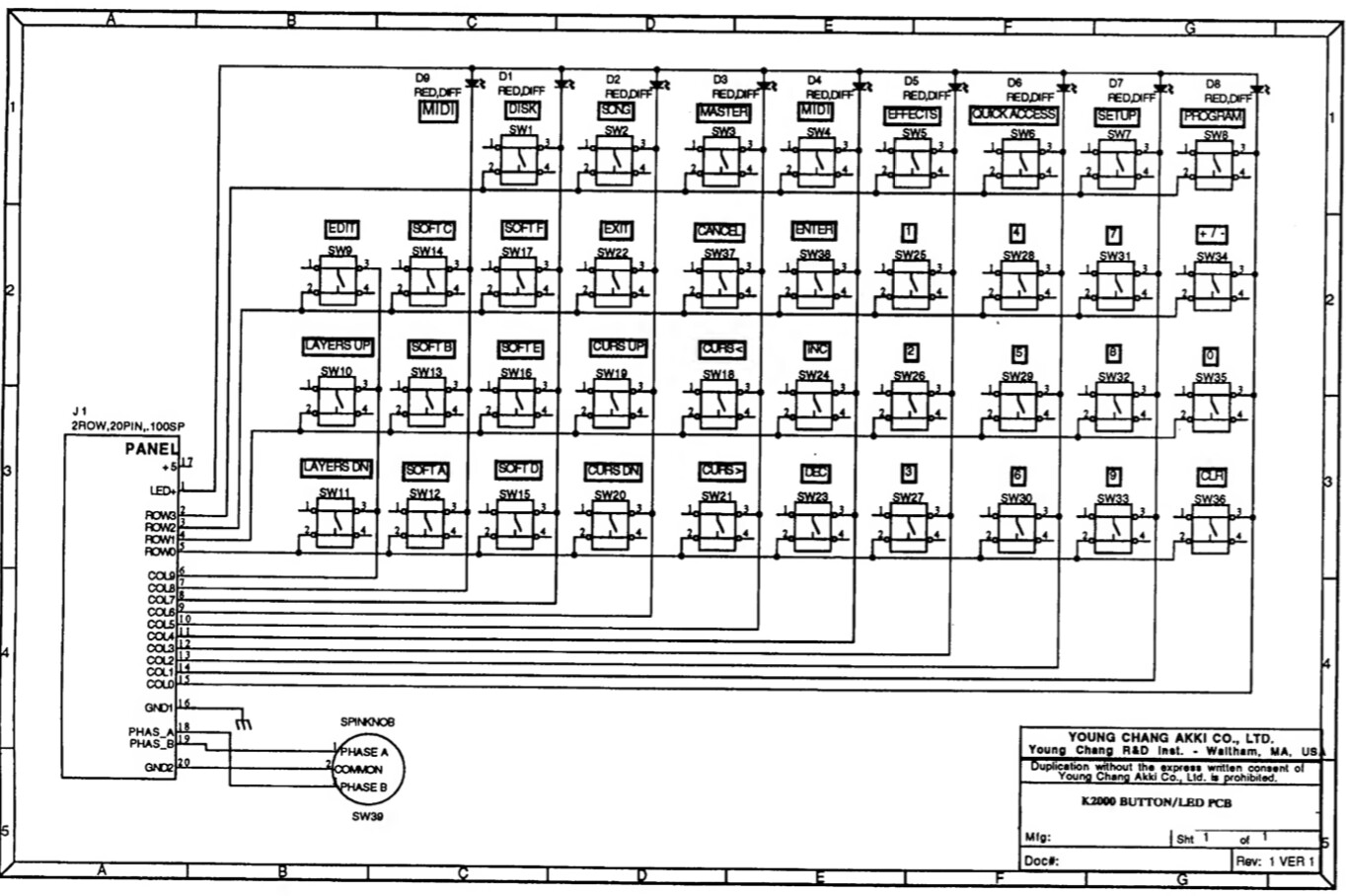

BTW the K2000 service manual shows a schematic for the front panel buttons, leds, rotary encoder and the LCD pins:
Actually the schematic says the original dispaly is a Sharp LM24014H:
