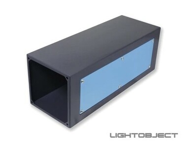

LO actually sells a case extension for the K40 to use with longer tubes. It would probably work for you if you wanted to put in a longer tube.
Just to be clear: the protection that matters here is against the 20,000V or so going to the end of that tube. :smiling_face:
