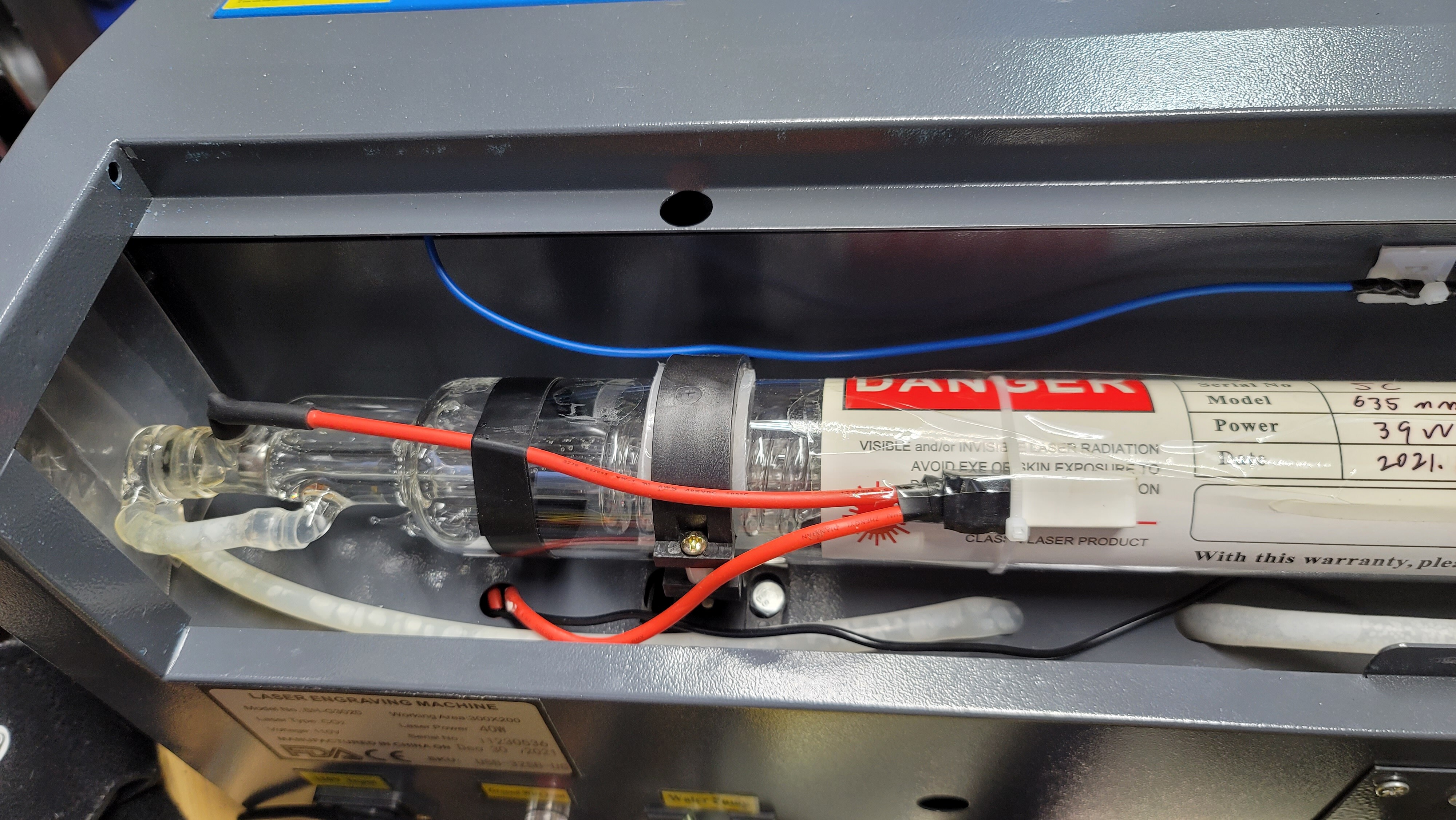

New K40. Had arcing and tube wouldn’t fire. Company sent me a new tube. The existing setup has a ballast resistor? on the current setup. The tube they sent has wires attached but doesn’t include the ballast. My question is: do I splice into the ballast and keep that setup with the new tube? Or splice into the wire to the power supply (or wire to the power supply)? I bought some HV tape and intend to solder the connection. Input appreciated.

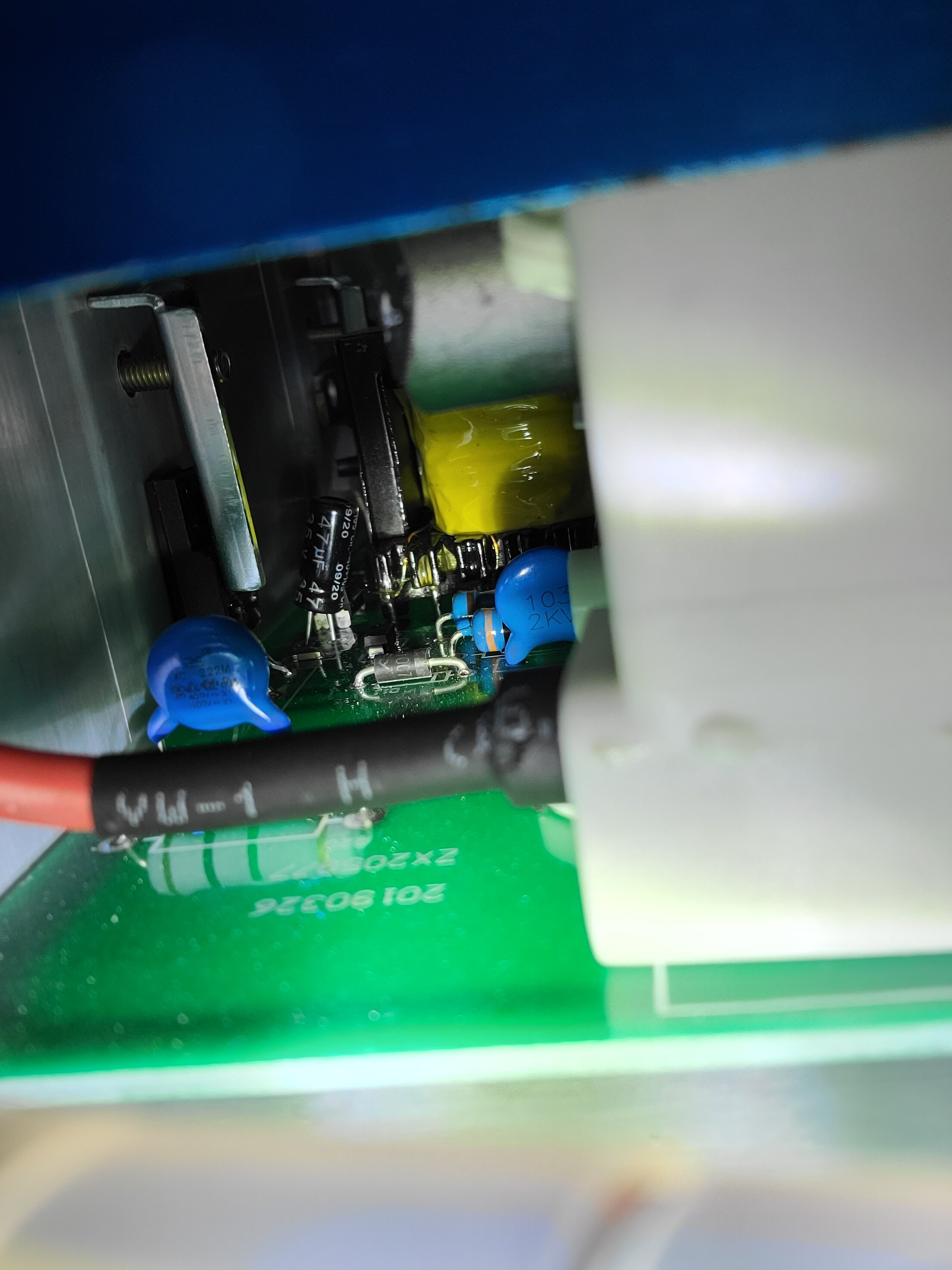

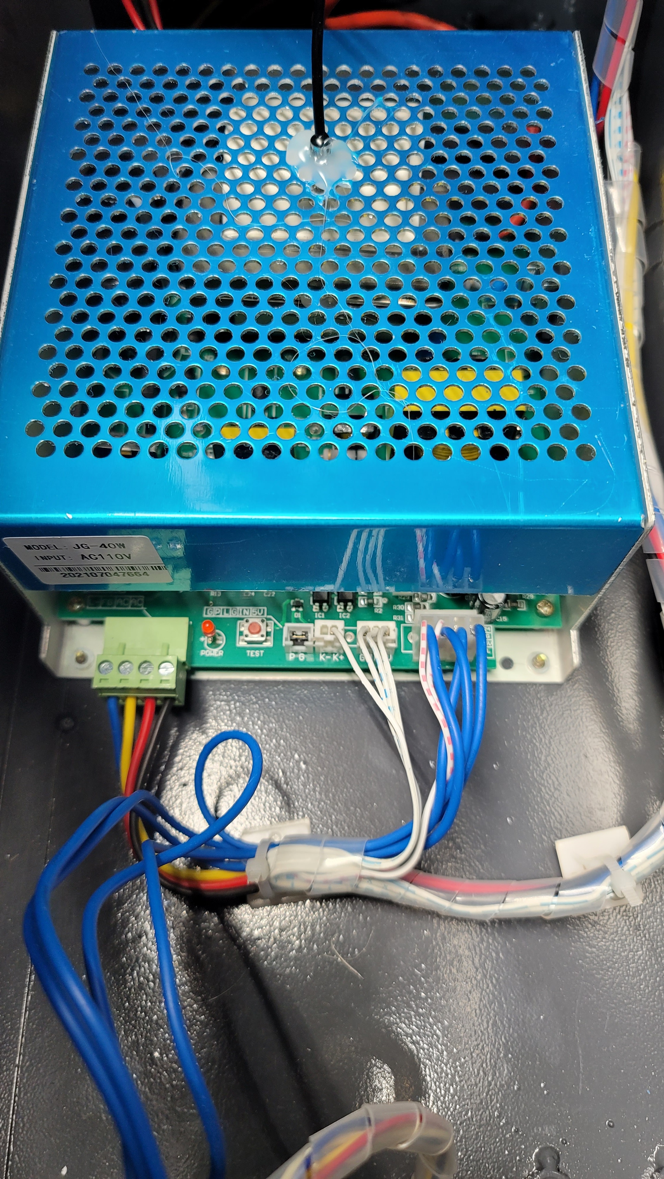

Post a picture of the LPS.
The old supplies used to have ballasts I do not think the new ones need them.

That should not need a ballast can you show me where it is wired in the circuit.

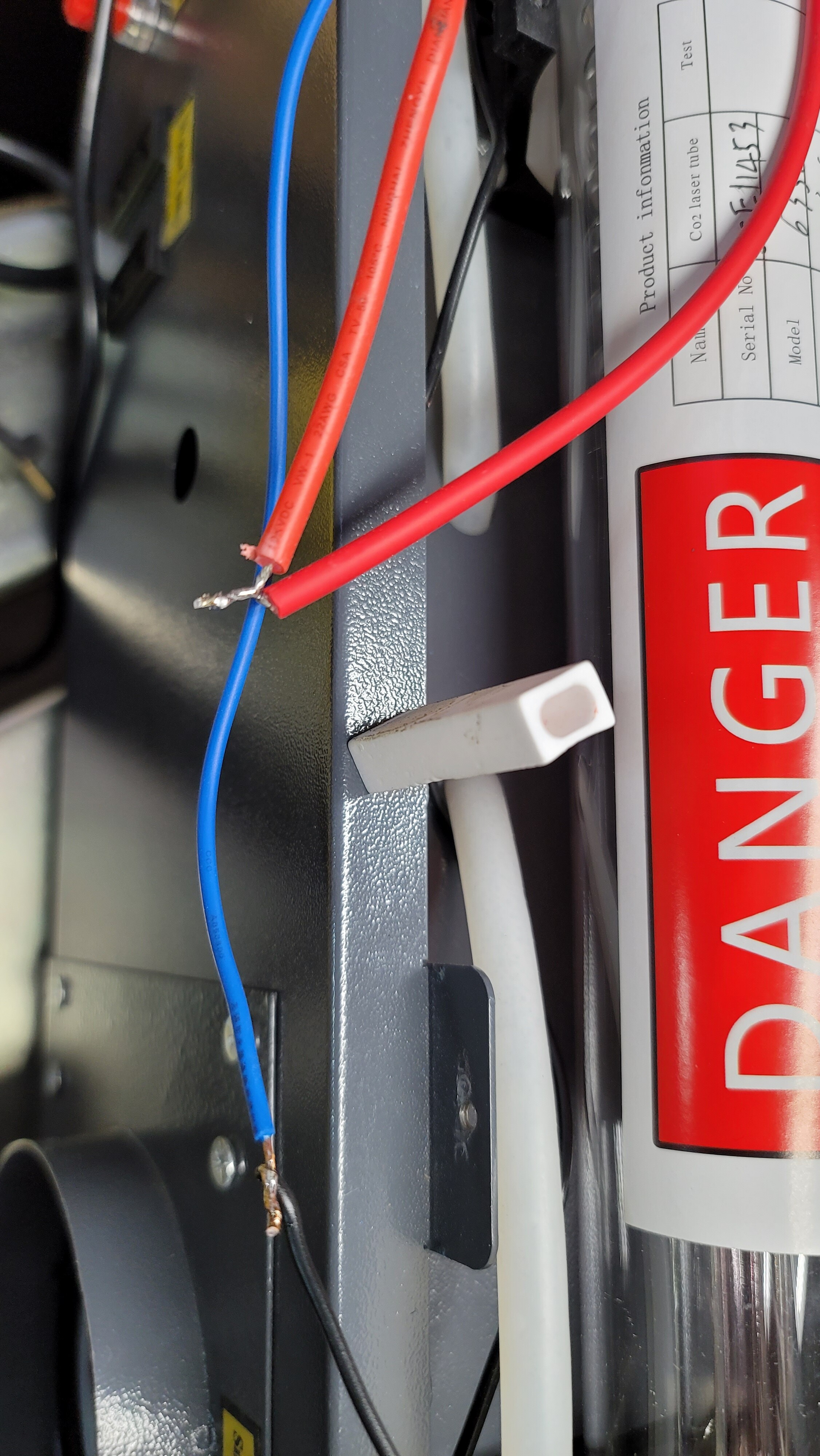

That’s a ceramic sleeve/cap which is used for insulation.
If your new tube is also pre-wired, you can reuse it. You just push the joint into it and fix the wires with some electrical tape in place.
I was able to get a couple of shots without removing the PS. I also have an email into the vendor.

But, it’s not a ballast. Says so in the video… “ceramic block” for electrical insulation.
I don’t buy that that ceramic connector and electrical tape is HV secure! I would expect it to leak out the open end of the ceramic connector. But that is just me!
I would take the ceramic connector assy and pot it with RTV. You can do this by pushing the wire into the ceramic and then slide a tube filled with RTV over it. Then fill any voids in the tube.

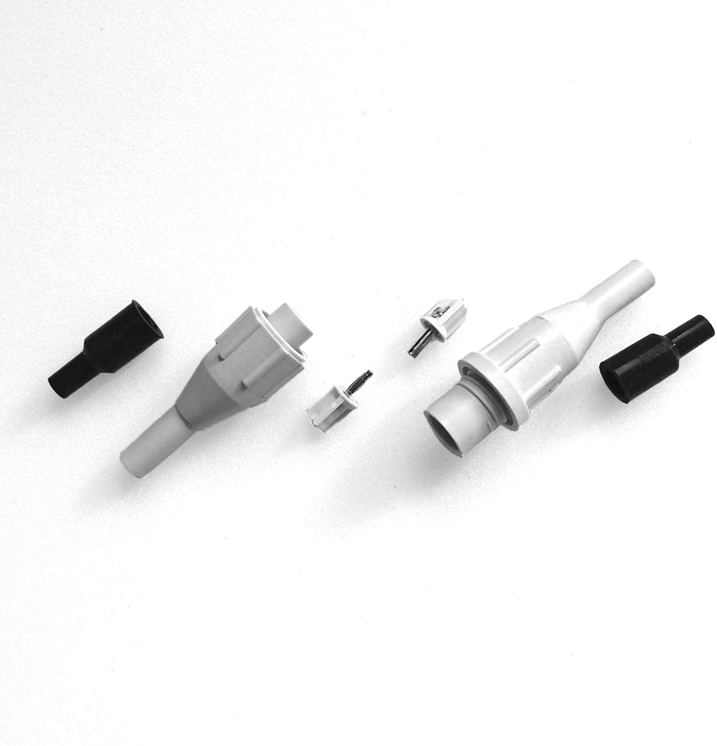

Alternately use a HV connector.
So I finished installing the new tube today. As stated, the ceramic block is not a ballast but only a ceramic cap to go over the wire connection which I soldered and then wrapped with HV self-fusing tape. Works fine now. Thanks for all the inputs!
