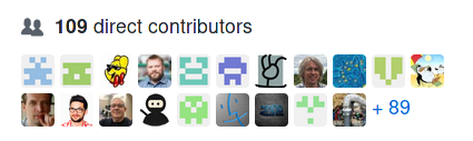

Overall, Redeem is basically a monoculture motion platform with a small user base, which makes it hard for people to choose to volunteer to put their time into improvements. Klipper is fairly robustly cross-platform, and work put into klipper will positively impact more people. Especially with the failure of the negotiations to build the Revolve, thinking about the Re* hardware platform as a Klipper target should make it more attractive overall to more people.
Klipper contributors
contributors
vs. Redeem contributors
redeem
With Klipper, they already have Beaglebone installation instructions, so instead of building a custom image, perhaps the focus could be on helping improve those instructions where improvement can be made, and providing documentation with sample configurations for Klipper-on-Re* boards?
I don’t have the space to do any of the work, so this is only providing an external perspective from someone with a long history working in open source, not implying that I have the answers. I do think that you’d want to provide an alternative perspective that addresses this if you were going to attract another key Redeem developer though, because I’d think that anyone else showing up and interested in joining in the fun would see the same patterns I just highlighted.
