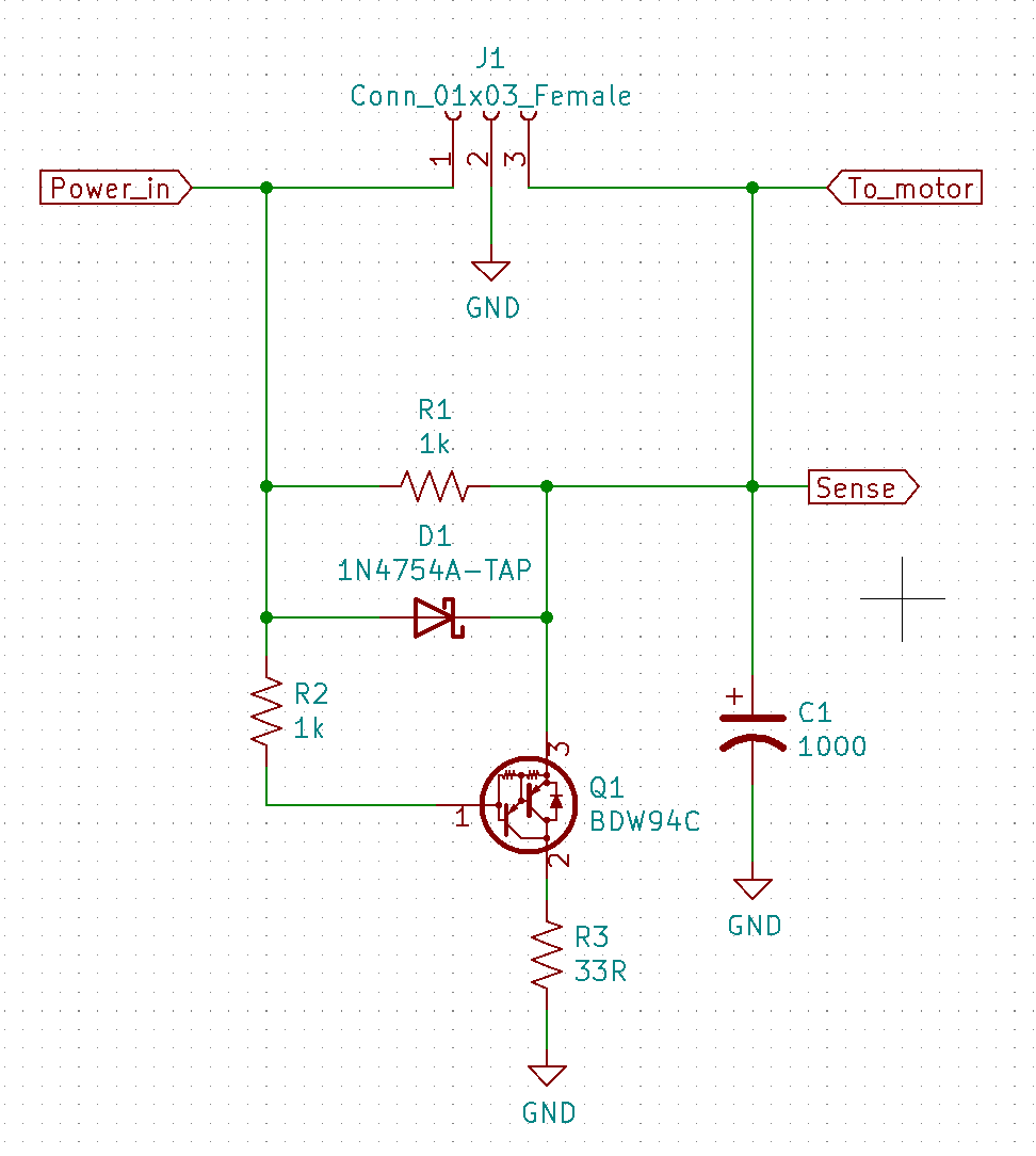

Over on Maker Forums Social, I’ve been live-posting my design work on an enhanced returned energy dump. This all started because I am considering converting the X power feed on my mill to something where I can set a table travel speed. That means more expensive electronics than the junk that Blondihacks found in the unit and I’d like to protect it!
If the table reaches a hard stop, or (horrors) I have a tool crash that hangs up the head, I’d like the controller to stop the table motion. That would require fault detection.
I would really appreciate review from folks who know more than I do about circuit design!
This part of the circuit is the original circuit from Gecko with a few part replacements for what I find available now. This part I’m reasonably confident in.
Here’s the sub-circuit for sensing fault:
This one I have no idea whether it would actually work.
My idea is that it triggers when the motor voltage rises above about 42V. 39V through D2, 1.4V (or slightly less) through the optocoupler, and about .25V through R4. (R4 of course dissipates more power as the voltage across it increases.)
Then Vcc from a microcontroller (any voltage up to the 18V maximum of the 6N139 optocoupler) will pull up the Alarm output high when it’s working, and pull it low in a fault. So it should be ~Alarm I guess; it’s inverted.
Does that circuit make sense to those here who know what they are doing? I know there are several of you. :relaxed:
More in the README.md · main · Michael K Johnson / ReturnedEnergyDump · GitLab — that repo has complete KiCad 6 files for the board, gerbers and drills, and datasheets for most if not all of the components.

I think that case B (without an alarm sense circuit) is why the original Gecko circuit uses a huge 10W load resistor — it can dissipate a lot of power before starting to glow. The wire-wound ceramic resistors I found had short time overload rating of 2.5x, 5x, or even 10x their continuous rated power for 5 seconds, so with a working fault detect circuit, it is not clear to me that a 10W resistor is necessary. In my use case, size may end up being important (I haven’t pulled apart the power feed to see what I have to work with) and perhaps a physically far smaller 2W or 3W ceramic wire-wound resistor would be sufficient.
I suppose that a 65-75V clamping voltage MOV between the motor and ground would help dissipate very short transients that might otherwise damage the 100V components like that tremendous capacitor.

On a different note, I was also wondering if you could sense the reverse current on R3 as there will be no signal across that resistance until Q1 turns on.
Would that be a simpler circuit since you do not have to worry about ignoring [filtering out] voltage changes on the motor drive under normal operation? Would this prevent false alarms? I do not know how much reverse current Q1 sees so I have no idea how big that signal might be and therefore what a good interface circuit might look like.

My initial circuit used a photodiode optoisolator instead of a darlington optoisolator, and then I didn’t have to provide a separate supply voltage for fault sense. I added the supply to support the darlington opto to reduce power dissipation in R4. But if I sense across R3, then I need to provide separate power for the sense circuit, and that’s not isolated. I’d like the sense power supply to be isolated from motor power supply (it could logically have a different reference ground) and specifically for it to be from the power supply for the control circuit rather than the motor power supply. Ultimately it’s not clear to me that it’s simpler than the diode-referenced voltage divider and optoisolator I came up with. (I could be missing something though. I recognize that “programmer tries to design electronics” can be something of a spectator sport. :rofl:)
I could use an op-amp to sense R3 if I add a separately controlled power source for the sense circuit, in which case I could use a photodiode optoisolator. But then I have to make sure that supply is also protected from the spikes that this circuit is designed to detect! :smiling_face: Quis custodiet ipsos custodes…
In any case, I really should at least consider adding a MOSFET to invert the alarm signal, so that the alarm is active-high. That will probably better match user expectation. A small-signal MOSFET like a BS170 would be fine. (Amusingly, I think they are larger than the SOT-23 power MOSFETs I have!)
Perhaps AC couple to R3 as you only need to see the reverse current pulse.
This is where I display my ignorance; my recollection of “AC coupling” has been capacitive ­— wouldn’t that require a shared ground reference?

Yes capacitive, you only need to see the reverse current spike.
The ground would be shared but not aware of that as a problem?

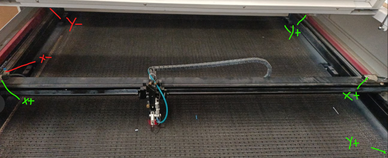

Don’t know if this is applicable but the Ruida has not only homing switches but also limit switches specifically for this.
Most don’t use them, but the + inputs such as LmtX+ on the Ruida is the input for a limit switch…
Just seems like a simple solution, but if you want an electronic one… I guess it’s not much help…
Here is a Ruida layout with home (red) and limit switches (green)…
:smiley_cat:
On large and powerful machines those limit switches could save the machine from destroying itself.
But software has become smarter and seems to know something about overscan and speed but as they say, better safe than sorry.
