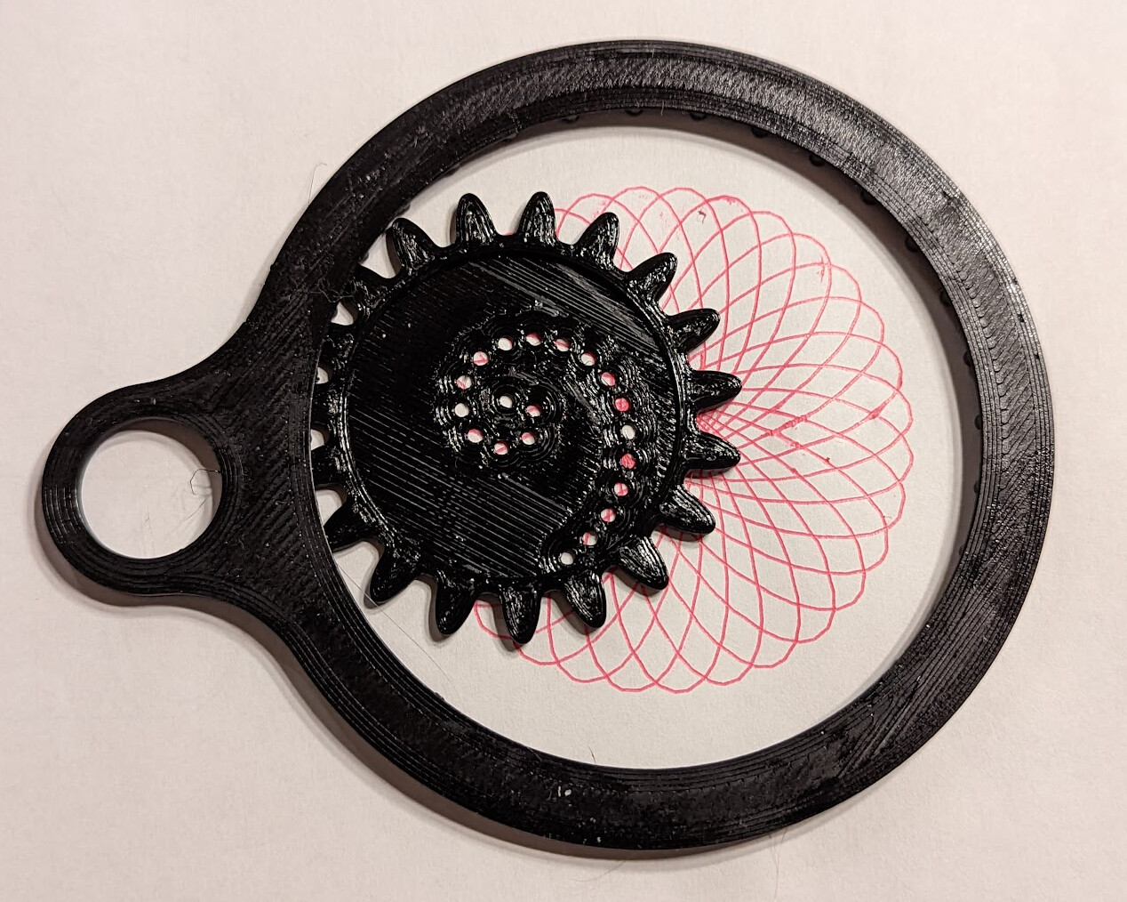

Today I 3d printed a hypotrochoid tracing kit (like spirograph) for my wife to use for a math activity.
But it doesn’t have the tooth count variations she wants for the activity she has in mind, so she asked me to riff on it in FreeCAD.
I figured, easy peasy, pull up FCGear Workbench, it’s probably a standard module, create some more internal involute gears for the rings and involute gears to run inside it, and add the features to those parts.
I loaded the STL for one of the rings into FreeCAD and tried to match it with a standard gear.
As far as I can tell, it’s 3.03 module, 26.5° PA, with a non-standard tooth profile with a long rounded tooth.
I don’t know whether that’s actually some imperial pitch, but that’s neither a standard pressure angle nor a standard tooth form so it simply doesn’t matter. Higher pressure angle is stronger (and noisier) but strength is not an issue here.
I think I’ll just make a whole new set, as parametric as I can, and use standard tooth profiles. Might want to test 2 module and 3 module, but 20°PA is pretty well established as normal and I don’t know of a reason to deviate from that.
I’ve tweaked the tooth form even more so that it’s an almost exact match and should run together fine.
I’m still going to start over with a parametric design.
But the attached file shows tooth parameters that very closely match.
In particular, the head tolerance is changed a lot.

I spent more time than I should have revisiting this. I’ve come very close in form (though not tested a print for compatibility) with these parameters that look very close in FreeCAD:
  • 3 module
  • head_fillet .4 mm
  • root_fillet .1 mm
  • pressure_angle 25°
  • backlash .4 mm
  • clearance .3
  • head -0.05
ReverseEngineer.FCStd (183.9 KB)
I’ll share separately when I am satisfied with my parametric model, which I’ve been redesigning repeatedly to react well to choosing different numbers of teeth on both the ring and the gear. It’s getting there!
