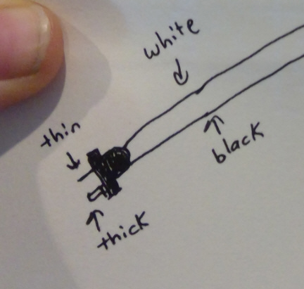

I wanted to check with something I saw in your drawing here:
SNAG-0024
The narrow prong of the plug should be connected to the Black (Hot) wire. Looks reversed in your drawing though so please check on that.
Good catch @marmil , I missed that. :grimacing: So sorry @Amanda_Stauffer! I think I got it right in my text description. It’s important from a safety standpoint to get that right.
When you are screwing the lightbulb into the socket, it’s easy to be touching the threads on the outside of the bulb at the same time those threads are touching the metal on the inside of the socket. If those are neutral, you are safe. But if they are hot, then current can flow through your hand and body through your feet if you are grounded, and it’s current through the heart that kills.
If you have ended up putting the switch on the neutral wire because it was on the line connected to the thick prong, then the socket will be energized and capable of electrocuting you even if the switch is turned off!
