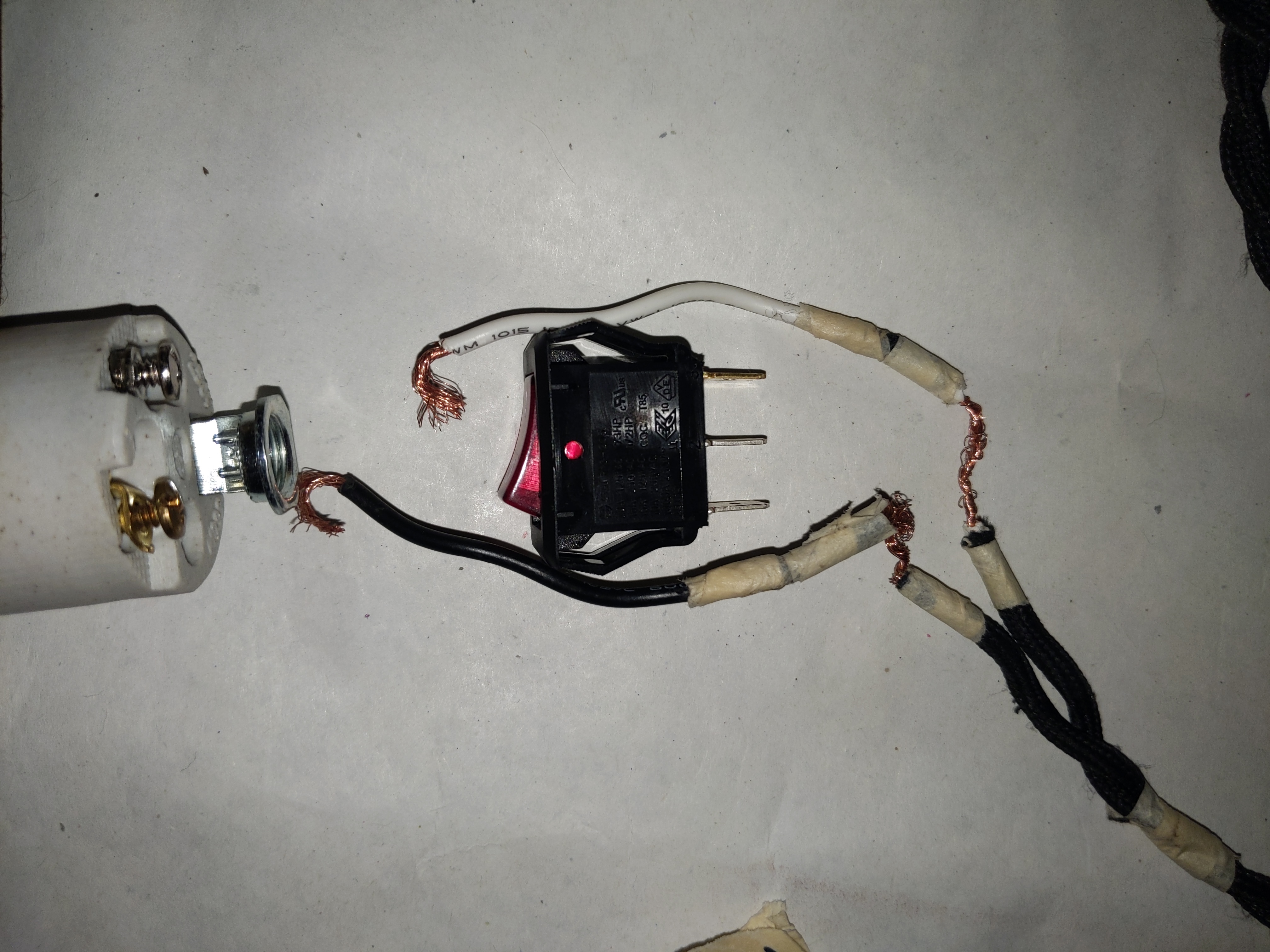

Hi all, I’m new here and hope it’s okay to ask this.
I’m trying to make a book lamp with a small red rocker switch interrupter. It has three metal tabs to attach wires to, but lamp cords only have two wires.
I tried just using the two lamp wires, putting the hot wire on the gold tab and the neutral wire on each of the silver tabs, one at a time.
(I did this partway down the cord, and attach the ends to a socket.)
First, the lamp turned on but wouldn’t turn off when I rocked the switch. The second try, the bulb blew as soon as I touched the plug to the socket.
I think I’m supposed to put a grounding wire on one of the silver tabs, but my question is, what in the world do I attach the grounding wire to? A piece of rubber? I need to be able to tuck it into the books I’m making the lamp out of.
Thanks so much for any help anyone can provide.
Typically the rocker switch connects the middle tab to one of the outside tabs, alternately. It probably says “SPDT” somewhere on it. Normally you would connect the white line to neutral and connect that directly to the silver terminal on the socket, and for the black (hot) wire would connect the wall to the center terminal and one of the outside terminals to the brass screw on the socket. It’s important that you not get that backward, and it looks like you are using unmarked cloth wire. That often has unpolarized plugs on the other end, which would make this very dangerous. You can electrocute yourself by getting that backwards. :grimacing:
Also, you will need to use the proper connectors. You need crimp connectors, which require a crimping tool, to attach the wires to the terminals. Otherwise you have a fire hazard.
Do you have a multimeter?
Thank you for the fast response! I don’t have crimp connectors or a multimeter. I will get the crimp connectors. Is a crimping tool absolutely necessary or would I be able to finagle without it? I did strip down the wires a lot and and planning to wrap all the little parts in electrical tape once I get them in the right place. So you’re saying the black wire should go around the middle terminator and then the gold outer terminator, and then the gold screw from the socket? I didn’t realize the same wire could go around two of them!
I recommend a crimping tool, because a loose connection is a fire hazard. Electrical tape isn’t ever a connector, it’s an insulator.
First, the black wire must be connected to “hot.” That’s the narrow of the two plug prongs that goes into the wall. The white wire must be connected to neutral. that’s the wide of the two prongs that go into the wall. If both prongs on the plug are the same, stop right there, this cord is dangerous to use for what you are trying to use it for.
You basically never strip a wire in the middle, only at the ends. So thank you for taking the picture you did! No, you won’t wrap wires around more than one terminal.
You need three wires to do this task. Two that go to the wall, and a short black wire between the switch and the socket.
The hot wire, which by electrical code must not be white and is normally black, and which is connected to the narrow prong that goes into the wall, connects only to the center pin of the switch.
One of the outer pins of the switch connects with a separate piece of black wire to the gold screw.
The neutral wire, which by electrical code is white, and which is connected to the wide prong that goes into the wall, connects only to the silver screw on the socket.
The remaining connector on the switch must be insulated. You can push an unused insulated crimp connector onto it as one way of doing that.
This is wiring that carries a potentially lethal voltage. There are books on basic wiring available at most home improvement stores and I hope also at the library. You’ll really want to make sure you understand the basics before hooking this into the wall.

Thank you so much for taking the time to type this all out!! I think it is clear now - I didn’t realize I would use a separate piece of black wire to go to the socket. I went through a lot of videos on basic wiring but couldn’t translate it to this project - I’ll definitely watch some more before plugging this in. I’ve drawn out a diagram that I think matches your description - would you please let me know if it’s correct? Sorry for being a pain!
Yes, that looks correct! :slight_smile:

What Michael said is completely right: wire the hot line to the middle contact of a switch, and then wire the switched line from one or the other terminal to the load.
In this specific case, I’d be tempted to plug the hot line into one of the outer terminals, and run the switched line from the center terminal to the lamp.
The reason I’m thinking about this is when the switch is open, neither other terminal has voltage on it, and when the switch is closed, only the center terminal is live. In no case is the other, unconnected, terminal live. That seems like a worthwhile increase in safety.
Well, actually what I’d do is cut off the other terminal and put a blop of epoxy over it so it would never be a problem, but: opinions on reverse wiring a switch for safety?
That’s a really good idea. Using the center is convention, no electrical reason I know of!
Thanks to you both for all of this knowledge. Hot/black into one outer terminal, connect socket to center terminal with black wire, insulated connector onto third terminal. Neutral wire bypasses the switch, directly to the socket.
I just realized we never got to this question, and I didn’t see a third wire in the picture. If you don’t have a third prong going into the wall, you don’t have a connection to ground at all. It is common for lamps to have only hot and neutral, and not to have a ground wire at all.
