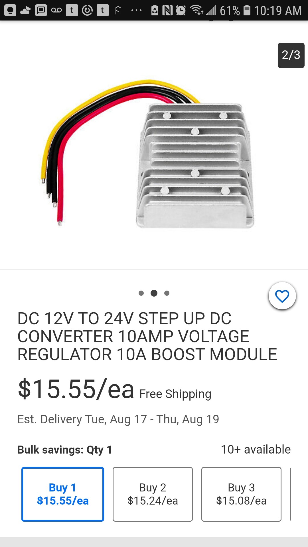

Ok, valid point. But what if I add something like this to the equation?!
Screenshot_20210812-101902_DuckDuckGo|281x500
My core question would initially be, would anything special need to be setup for the power supply, or could I use the same power supply that’s already in the unit? Not necessarily including this as “something special” per se… I’m basically asking if I need to have a separate power supply if I wanted to swap between a 24v (stepped up) source and a standard 110v source.
[/quote]
That converts 12V to 24V and that would power the controller and motors.
