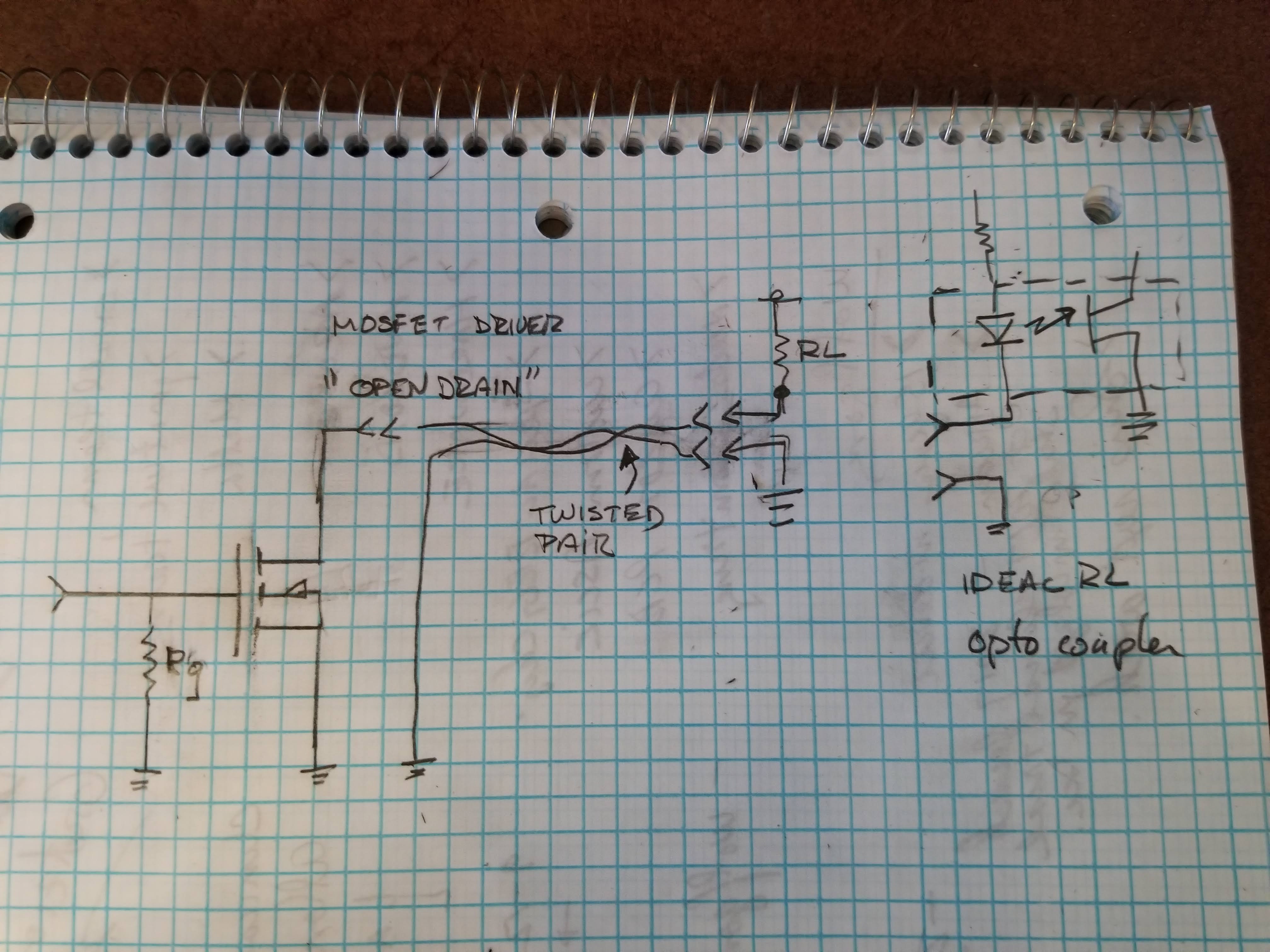

Open drain mosfets configurations are a much better alternative than level shift-ers. An open drain driving twisted pair, pulled up at the destination end [or providing ground to an optical isolator] is a better method of interfacing between devices in a noisy environment.

Open drain is not differential it is single ended. I think we are both talking about the same thing?
Not complex at all: mosfet, gate resistor and pull up.

You are right these are different circuits.
Your circuit is typically used if you need bidirectional capability.
All that is needed is a mosfet switch configured as an open drain.
Most boards have these mosfets on board for driving spindles and such with PWM.
Instead of using the 3.3v signal directly from the internal pins, find a mosfet driver on board that can be configured as open drain and there will be NO parts needed. The configuration file may need to be changed.

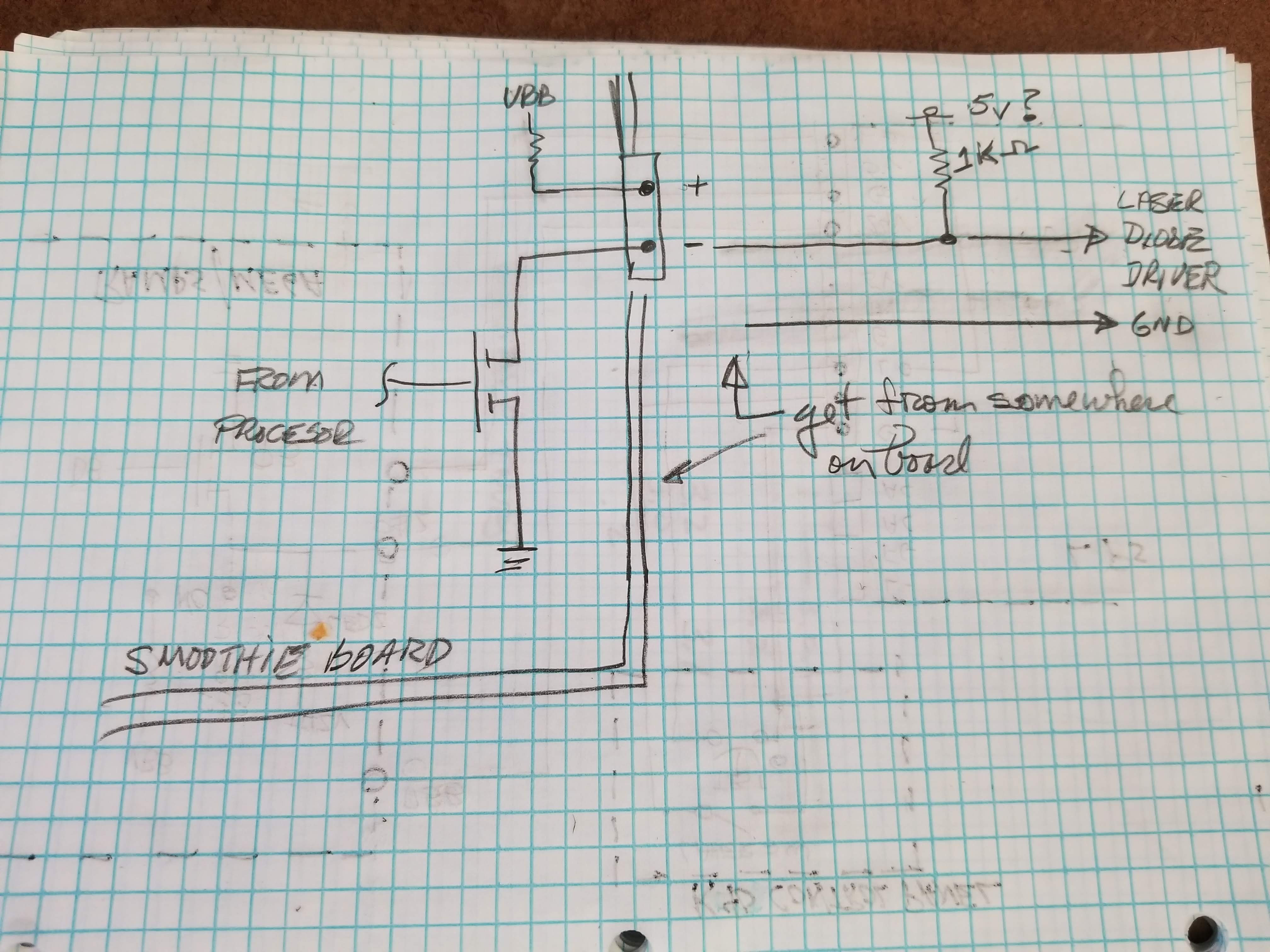

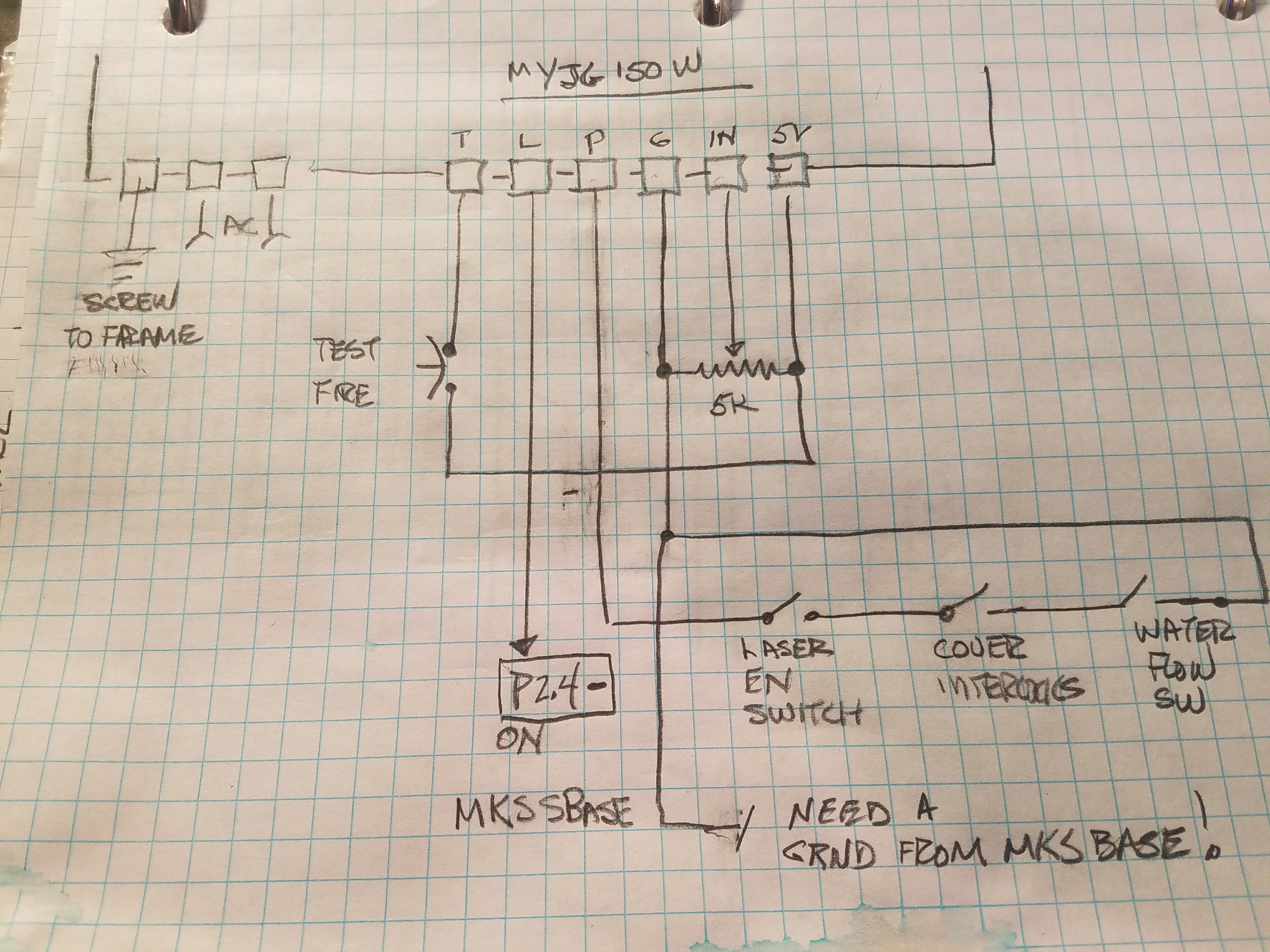

Here is what I dug up that helped others.
As I recall we used the fan output on P2.4 but I believe that the BED driver will work as well. We just need to replace the LPS with the Laser diode driver.
Do you have the specs on the Laser Diode driver?
This is the typical output of a smoothie control board. You are going to connect to the drain of the driver not the pullup/VBB pin.
To connect:
Connect the Drain of the output P2.4 FET to a resistor that is pulled up to 5V, 1-10K should be ok.*
Note: you can also configure a pull-up on the smoothie board to connect to 5V but I do not know how to do this on this particular board.
Usually the drain is on the - pin of the connector. The other pin (+) is usually connected directly or through a pullup to VBB. You can verify this by measuring [with power applied] with a DVM, each pin. The one that has VBB voltage on it is NOT the one you want.
Find a ground on the smoothie board and connect it to the ground of the diode driver.
Configure P2.4 like this in the laser module of the config file:
laser_module_pin 2.4 # this pin will be PWMed to control the laser.**
  • Caveat 1: I am guessing that the PWM input of your laser driver is TTL or 5V compatible.
    ** Caveat 2: I am assuming that the LED driver is expecting a low true signal if not the pin can be inverted in the laser_module_pin definition
    *** if the laser module is expecting a ground then the pullup can (and may need to) be removed.
Hope all this helps…
