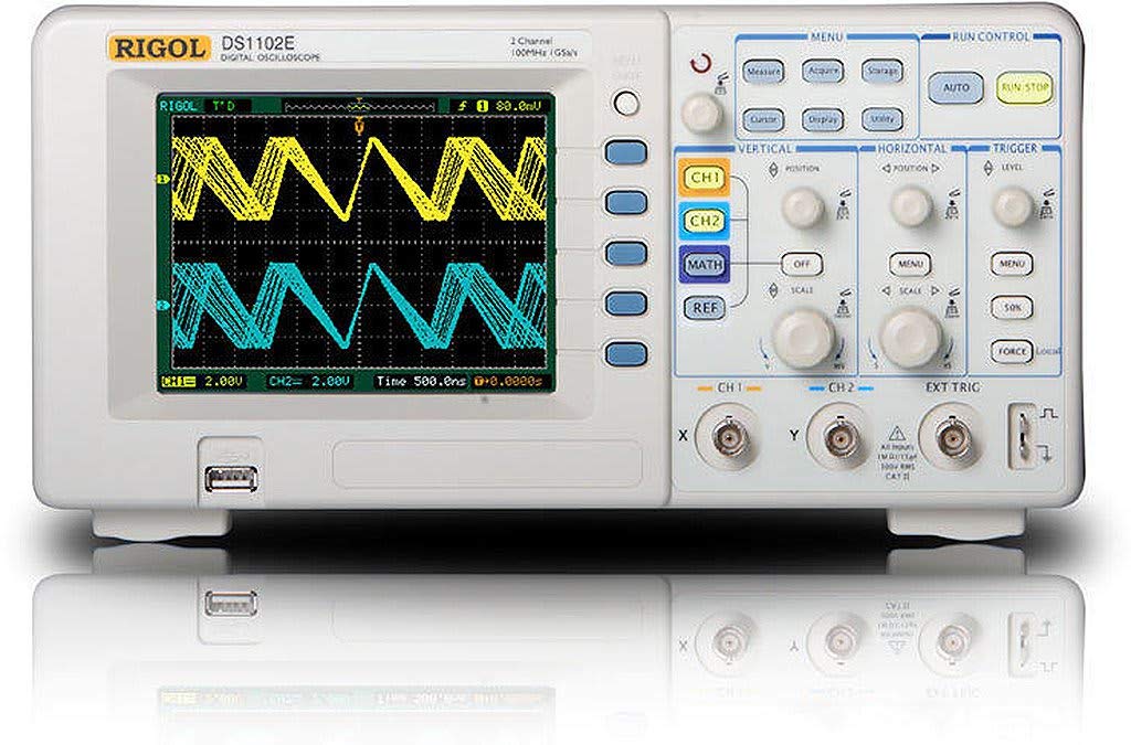

I ended up with a Rigol 1074 — 70Mhz, 4 channel. It was maybe $375 when I bought it? Looks like prices have gone up a little bit, now that gets you the 50Mhz 1054 instead. But if you are hunting for transients, low bandwidth is going to give you false negatives. I’ve been glad many times that I didn’t get a 2-channel. I rarely use all four, but 3 isn’t that unusual.
That doesn’t give you sub $200. But to get there you really have to specify what you are willing to trade off.

Nothing in the sub $200 price range but Rigol scopes are good.
